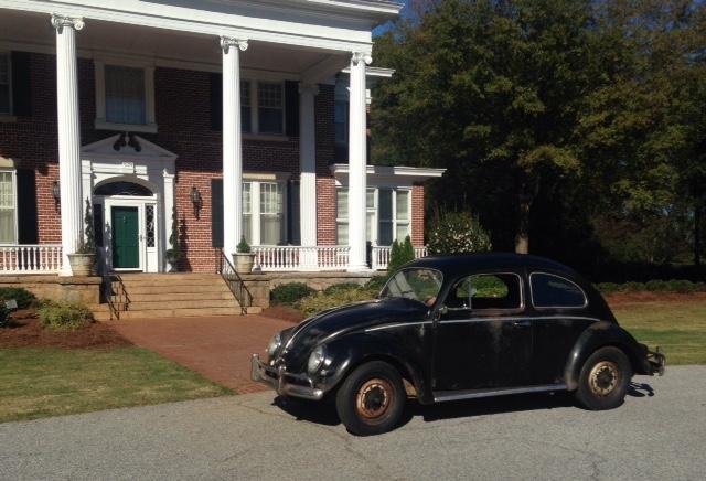

PostPosted: Fri Dec 14, 2018 10:42 am    Post subject: Re: does anyone here own the last oval beetle? Reply with quote
1541627 May, 1957
