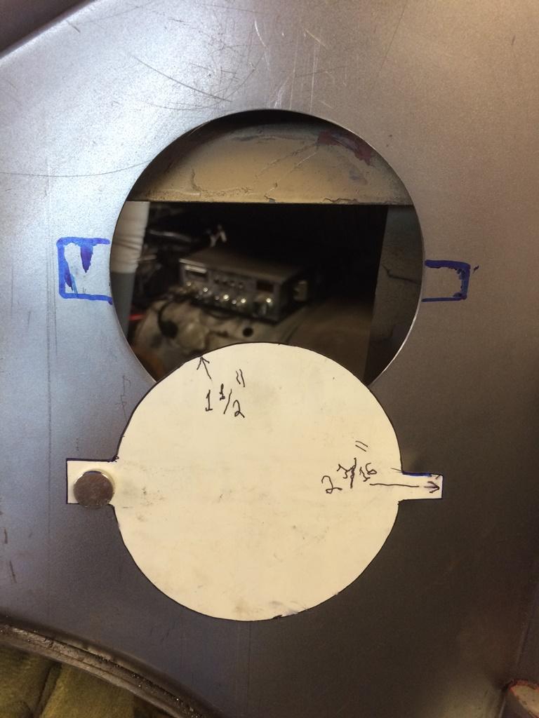

For the Signals I measured from the edge and the "V" line. Made a template and traced it where they should be.
Used a YUGE hole bit and a hole punch and file for the slots.
