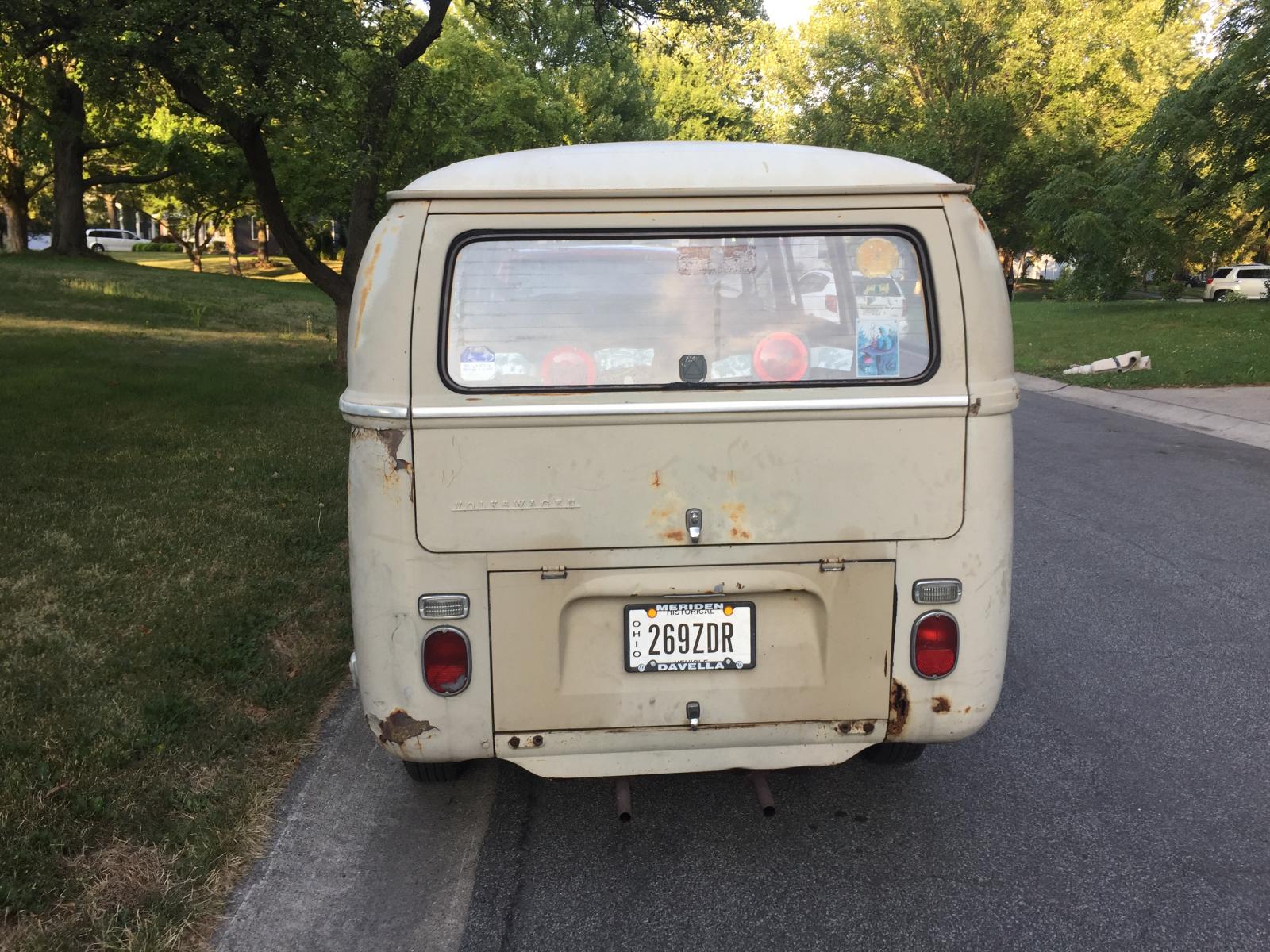

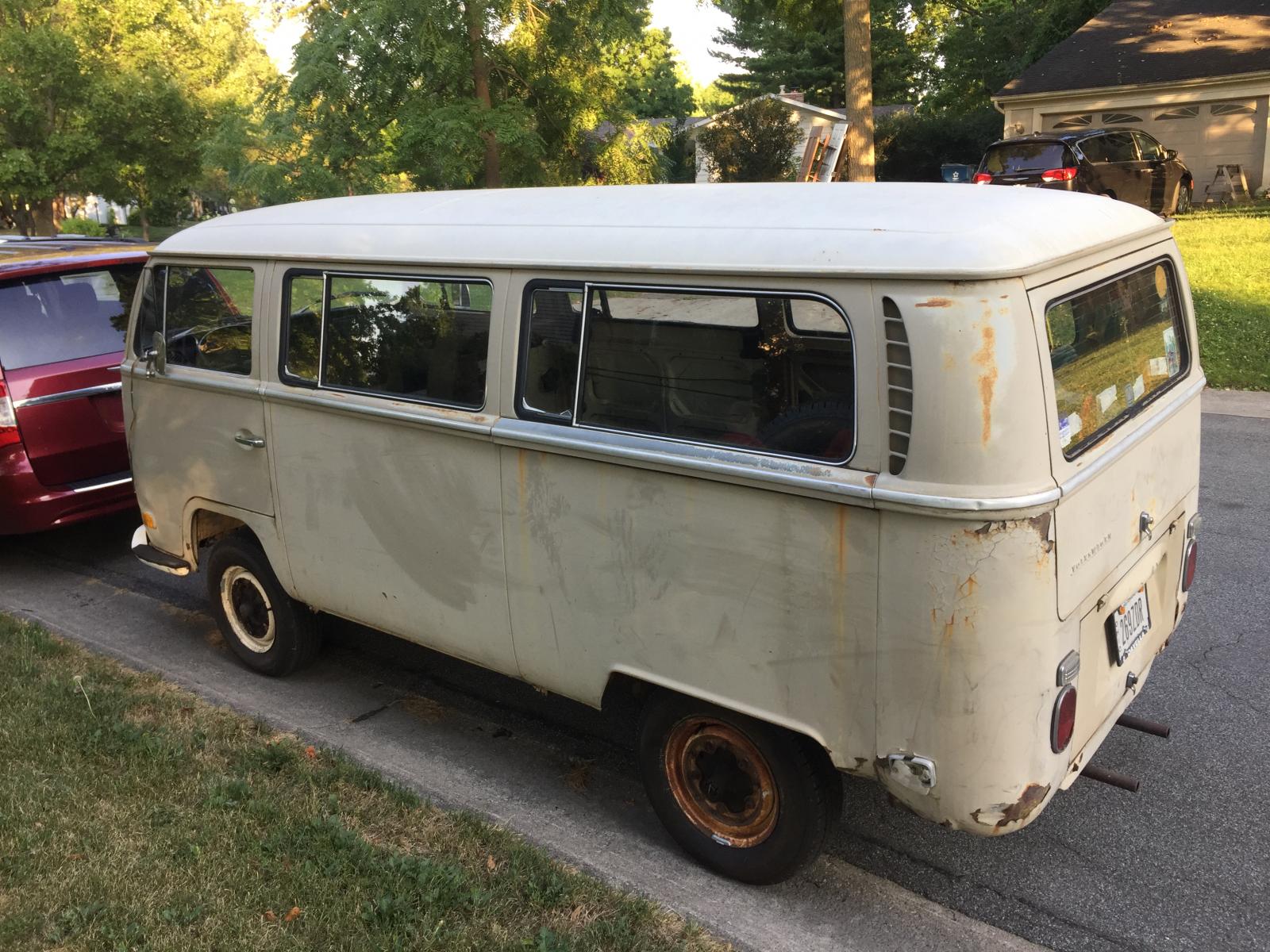

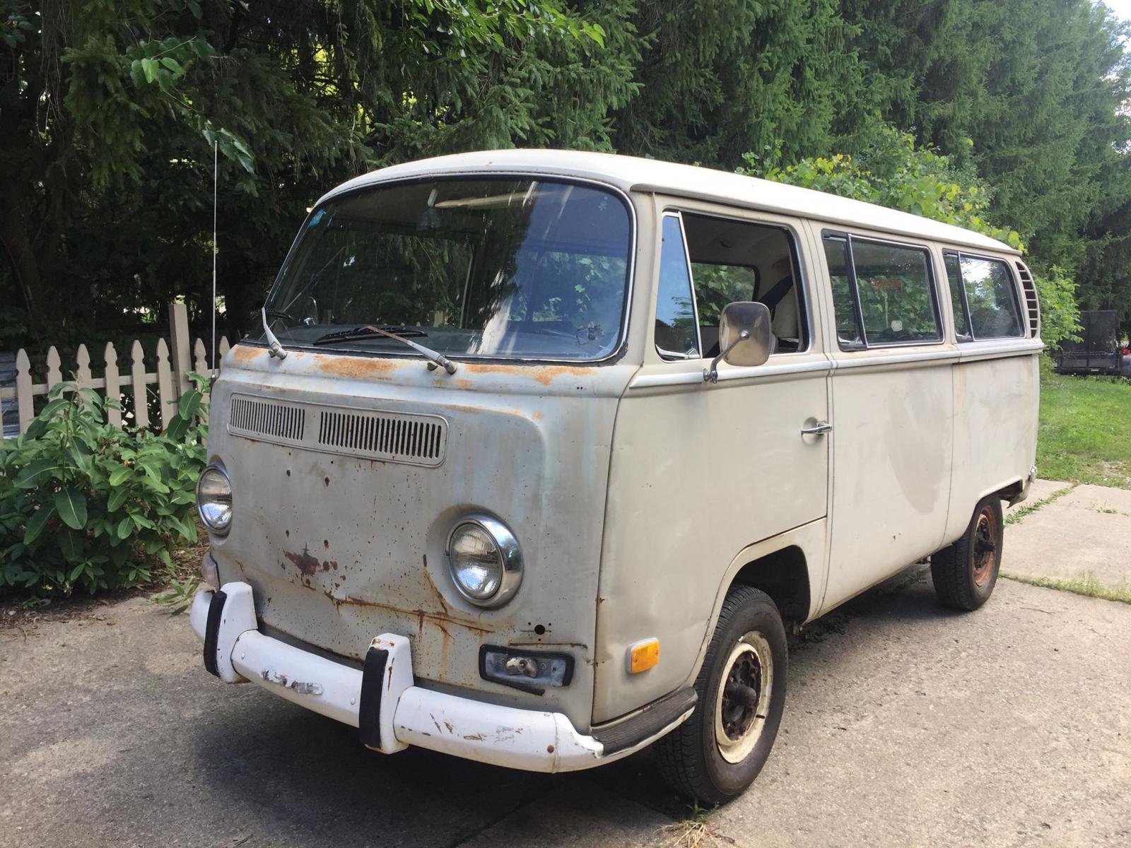

Just picked up this 70 dlx pass bus came from Cali-New Orleans so has seen a lot of hot, dry sun. Mostly all original paint has been sun baked, has that real chalky, dry look and feel but you can see pretty nice patina paint is still there.
What you guys suggest to bring this back and maybe remove some of the rust staining. I have seen some REAL amazing work out there.

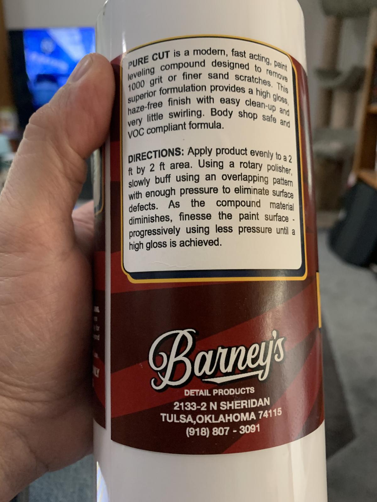

I’d use this with a good polisher like Rupes

How do you think clear coat gets polished? Yes it’s wet sanded using a leveling compound. You have to know what you are doing and when to stop. I’ve even seen this used on black cars to bring back a high gloss and remove scratches in clear.
For more serious scratches you can fill bad area with a paint then polish to level for almost invisible repair.
Correct product like Barney’s, quality buffer like rupes, and technique. If you have that you’d be amazed with results. A proper paint correction as described followed by ceramic coating would yield a high gloss nearly maintenance free shine for years. I enjoyed this so much wife and I went to school for professional detail training. Knowledge is power. It’s not difficult or mysterious. There are some proprietary techniques though. 😀

I looked for this and can't find it. Can you post the front of the container Zundfolge1432?
Zundfolge1432, that is so cool that you and your wife went to detailing school. Love it and if I ever get some time I'll try that too. Which school did you take your classes at?
tristanblue wrote:
I don't think it need wet sanding nor would i want to take any more paint off it.
I will try over at the Split Forums...they seem to be more into this kinda thing
