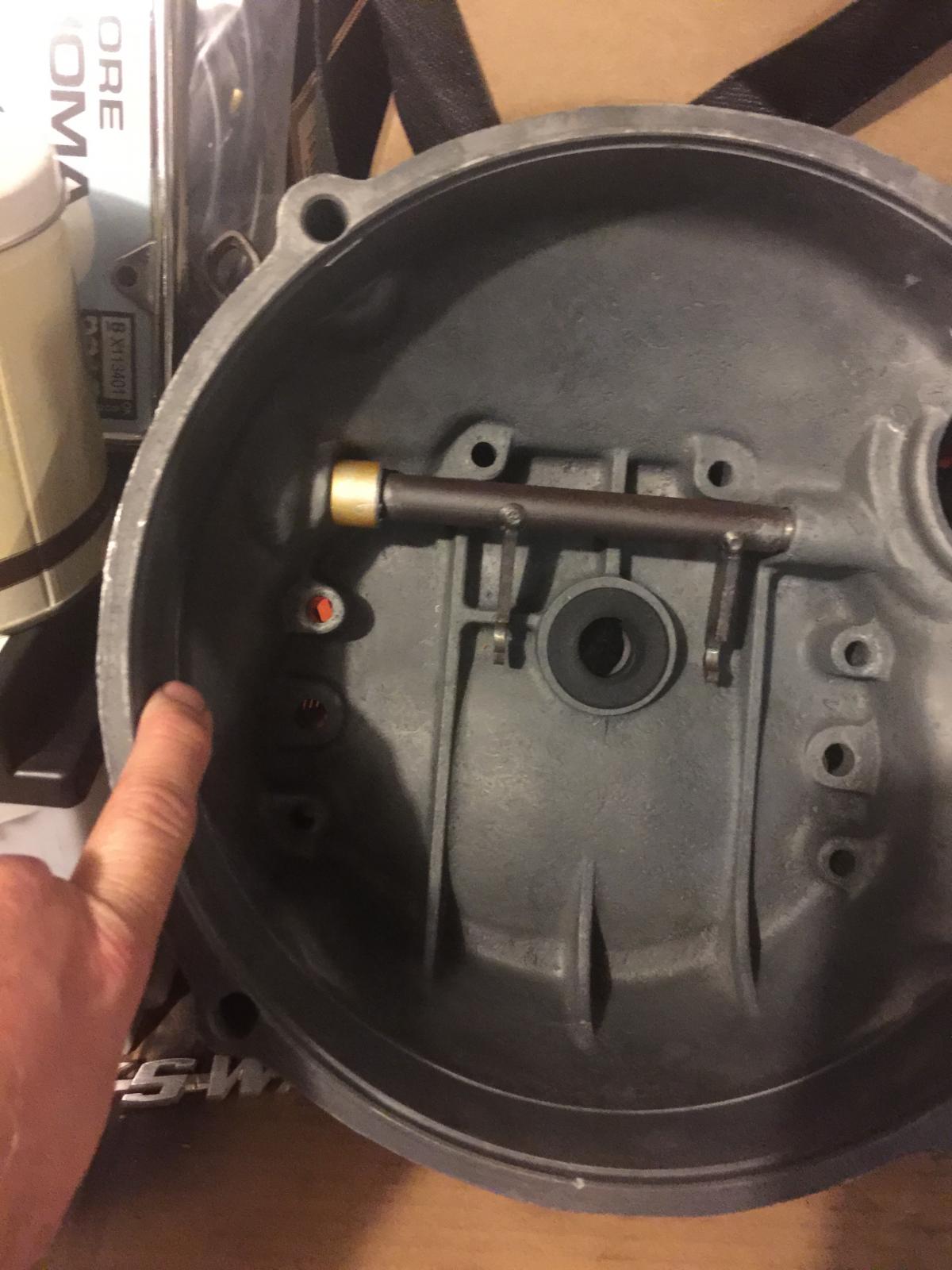

Tvättbjörn
Joined: May 07, 2004
Posts: 1437
Location: SoCal
Tvättbjörn is offline
PostPosted: Sat Feb 09, 2019 10:00 am    Post subject: Re: Early model throw out bearing conversion Reply with quote
Dealing with it last night. I had the same issue with the noise you are talking about. Make sure your throw-out arms on the shaft are centered and have the same distance from the input shaft. I have two after-market throw-out shafts and both are just crap. Not only did the bushing not fit the shaft ( hole was too small ) The bearing was sitting 4 mm off center to the right. I had to bent the arms sideways to get the bearing centered. It looks like everybody is making just a copy a bad part from somebody else.
