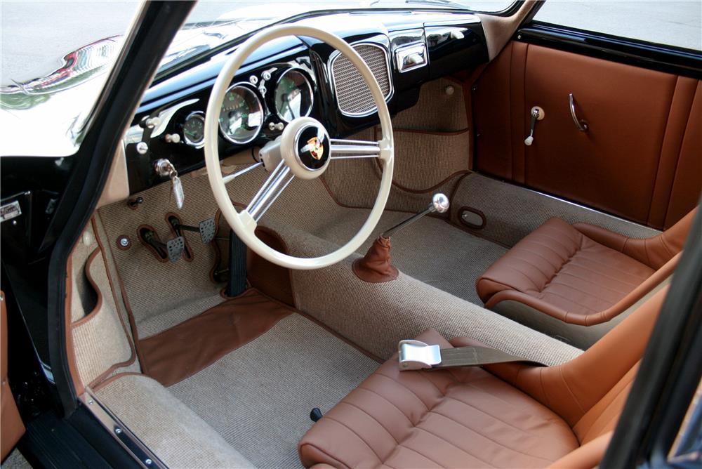

Hi, I have a question, can anybody help?
This 356 should be an original pre A.
But why is there a tunnel like from a beetle pan?
Looks like kitcar, but without emergency brake?
But with Porsche pedals?
Or is it possible that this tunnel was at any time factory made by Porsche?
Thanks for your answer!

I don't know the answer but maybe the description here gives some information:
https://www.barrett-jackson.com/Events/Event/Details/1953-PORSCHE-356-PRE-A-REUTTER-COUPE-187712
Lot #734 - Total vehicle production was estimated at 1,600 cars in 1953, 338 of which were 1300 model cars. Very few remain today, making this rare Porsche one of the earliest examples in history today. Chassis #50540 was prepped for Rally racing years ago by Veteran Porsche race car driver and builder Klaus Selbert. In the last year #50540 received a top-level restoration, keeping the car true to its Rally racing heritage. It retained its race-prepped Magnesium Split case engine making approximately 120hp, double the horsepower of stock and still very street-friendly, running on pump gas. Oversized to 1640cc with all of the best internals, dual Solex 40 carbs, external oil cooler with filter and synchromesh split case 4-speed transmission with 911 shifter. Upgraded to 12-volt with an AGM battery. Suspension was upgraded with Koni shocks, heavy-duty adjustable sway bar and boxed trailing arms. This car handles superbly. The brakes were upgraded to a dual master cylinder with synthetic brake fluid. The front trunk floor was slightly modified to accept a 911 external oil cooler that has pass through air flow with a screened opening in front. Custom front floor and rocker shielding to keep air turbulence to a minimum under the car. Custom forged 16" aluminum rims were built to replicate original but widened to 5.5" for extra performance and stability. Laser-straight panels and excellent gas pumps throughout. Upon inspection during restoration, this car showed no evidence of any major accidents and retained all of its original body panels, as evidenced by the original paint showing in hidden areas. All panels were stamped "62." All original VIN tags, trim tags and stampings. All chrome and brightwork refinished to show-quality. Interior redone with European Tobacco leather and German wool carpets bound in leather. Original Veigel gauges rebuilt by Hollywood Speedometer. Tachometer has been upgraded to electronic and has revised redline. Custom-made aluminum racing seats. Certainly one of the finest early Porsches tastefully upgraded for a greatly improved driving experience. Documented with Porsche Certificate of Authenticity.

Hmm, whenever I saw a 356, I looked at the tunnel and I immediately knew if it was a replica or an original. Perhaps my strategy is obsolete? But if it's not factory made, which reason could it be to add such a beetle center tunnel? Everything original but inside it looks like replica? Myterious...

I have a 52 . The pedals are porsche but not pre A . Pre A's are square.

I had a '55 Continental coupe mounted on an early shortened swing axle Beetle pan, tunnel looked exactly like what's in the picture. Shifter was on top of the tunnel, e-brake was under the dash.
My Pre-A had a ribbed-top blinker switch, a red plastic lens on the end of the stalk, and a half horn ring on the steering wheel, that looks like a plain old repro wheel with a Beetle blinker and plain knob.
Maybe?
Pedals look just like the ones that were in my '65 SC and a lot like the ones that were in my 914 as well.

Square pedals were used until ~Apr 1954. After that, the curved shaped ones that were adjustable were used.
