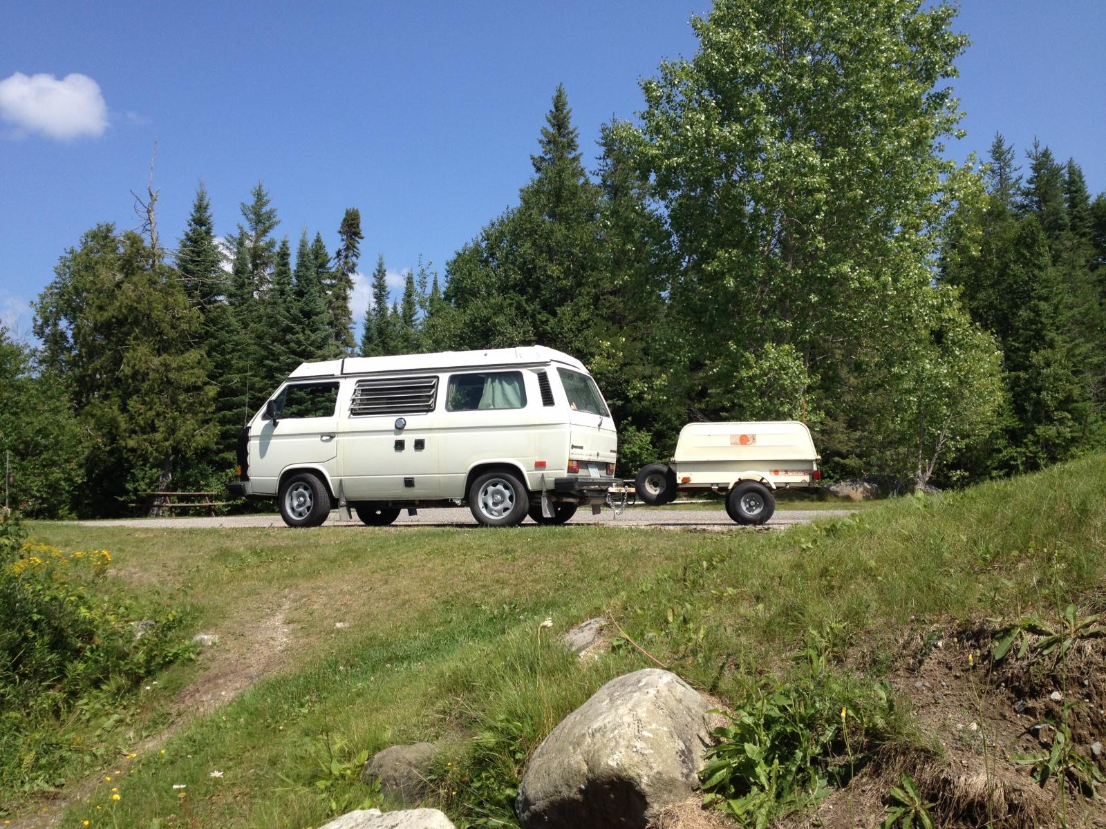

Last years road trip out to the Center of Canada Smile ...
