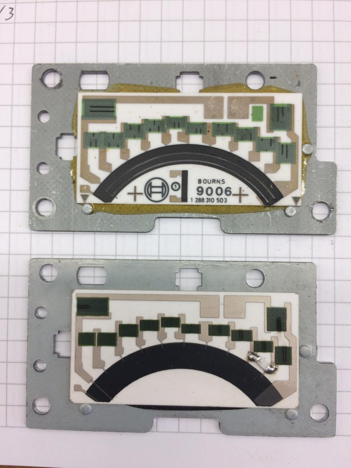

well... this arrived today:
haven't tried it yet. at least the holes and pads line up. got it from here:
https://www.aliexpress.com/item/CIRCUIT-BOARD-MAF-...3c00VpaE9D
-dan
looks like it has been calibrated - notice the soldering between the far right pads. i wonder how these were aligned and if the carbon is logarithmic across the range.

PostPosted: Thu Apr 11, 2019 1:12 pm    Post subject: Re: AFM replacement wiper board Reply with quote
and the resistor pads have been laser cut.

DanHoug wrote:
in my photo, you can see "Bourns" and ...9006... so there is a PN on it. i COULD go out to the garage and look but we're in the middle of a blizzard.
Bourns is a maker of excellent quality potentiometers. the carbon track on this China one is what i would worry about over the long term... just how resistant it is to wear. it looks to have a more matte finish than the OEM.
i would be more concerned that the carbon resistance has been calibrated across the full scale. this ain't no Bourns, but it sure mimics the look

PostPosted: Fri Apr 12, 2019 7:29 am    Post subject: Re: AFM replacement wiper board Reply with quote
025 906 301 is the 1.9l AFM
025 906 301 C is the 2.1l AFM
A bit cynical perhaps, or maybe they just misunderstood. The ad says it's for 2.1l.
I suspect that the hand rework on your resistor plate is because the laser trim ran out of range and severed the last resistor completely.

PostPosted: Fri Apr 12, 2019 7:36 am    Post subject: Re: AFM replacement wiper board Reply with quote
It has, you can see the laser trimming marks on the individual resistors. Whether it's correct is of course another question.

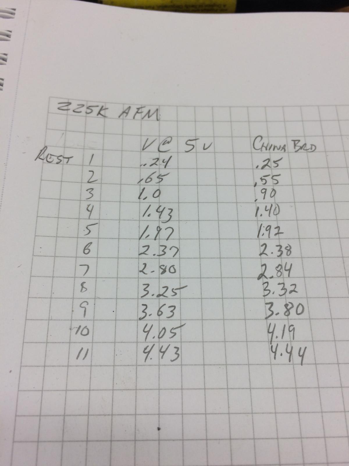

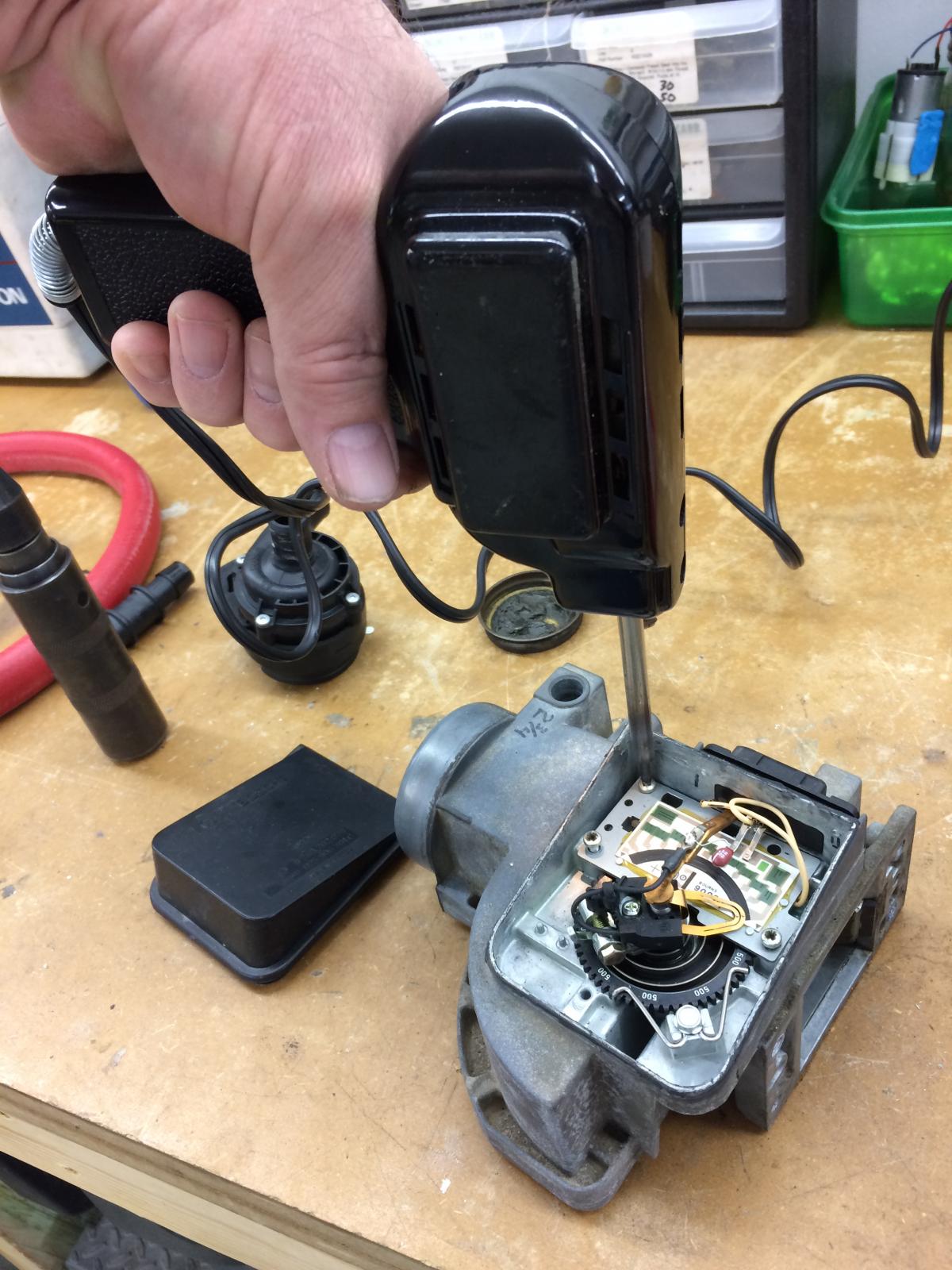

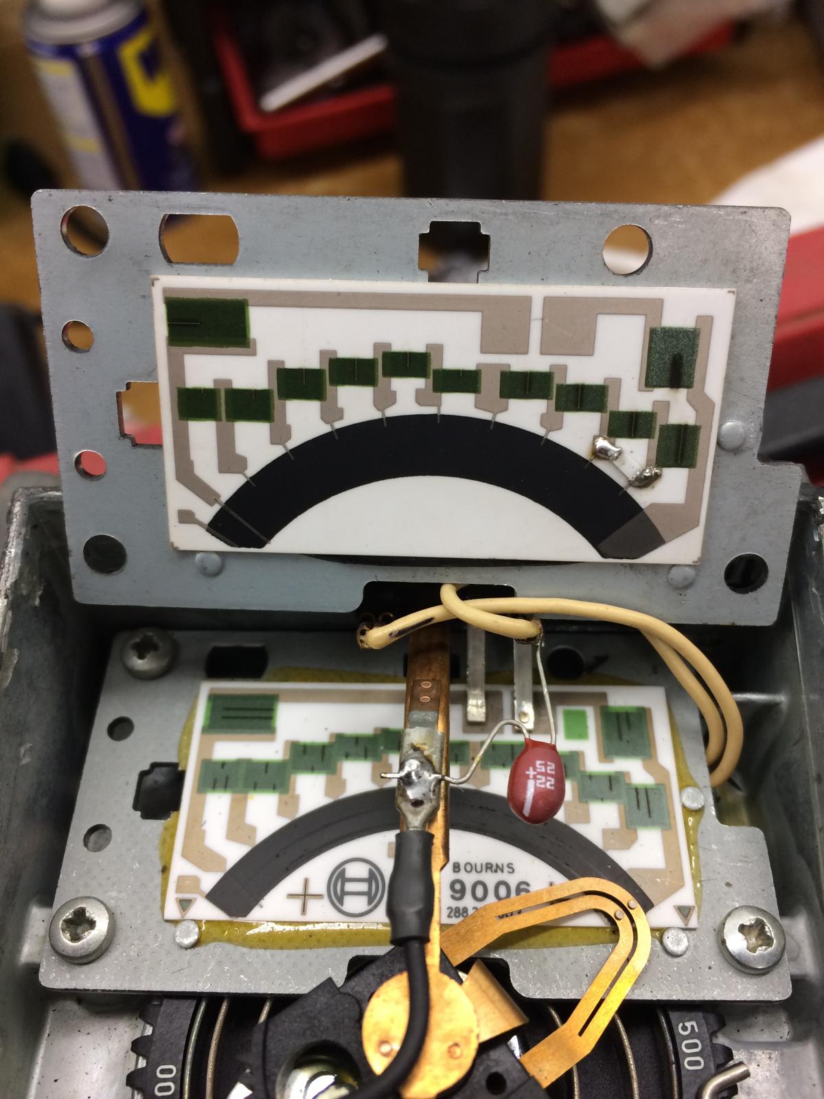

a bit more work on the replacement board...
loosening the AFM board screws. these are bonded with both a heat sensitive locking compound and a 'squaring' of the screw threads to prevent loosening. so heat the screw head with a 200watt solder iron with a fine tip and put some valve grinding compound on a good fitting screwdriver and they come right out with strong downward pressure while turning
here's the two boards when out:
prior to and after replacing the board, i set up a test jig supplying 5vdc to pin 3, pin 4 ground, and voltage signal of wiper off pin 2. my OEM board did NOT have drops when swept using an analog meter but i'd previously cleaned the track, wiper contacts, and pivot contact. the below chart shows voltage comparative readings between the OEM and the China board using the intersection points formed by the resistance pads. it wasn't a perfect reference but fairly close.
so far, without a test drive, the China board looks to be a good copy, with a slight voltage boost at pre WOT. the durability of the conductive pad remains unknown.
-dan

PostPosted: Sat Apr 20, 2019 8:18 am    Post subject: Re: AFM replacement wiper board Reply with quote
If I recall, the screws are Pozidriv not Phillips. Using the right bit will allow a better result. I had to heat the bolts up to release the locking compound. You really do not want to break/strip those bolt heads.

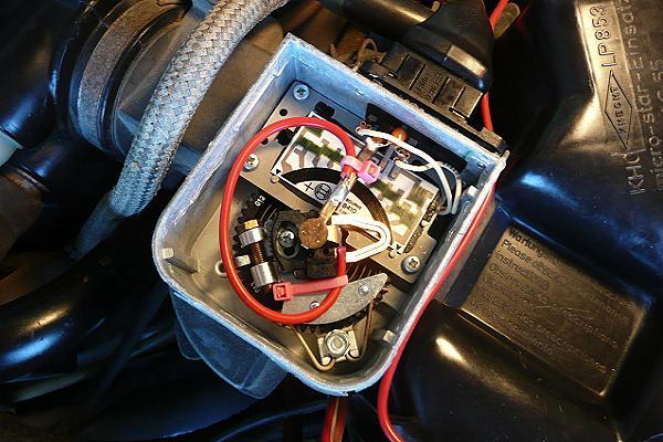

PostPosted: Sat Apr 20, 2019 9:10 am    Post subject: Re: AFM replacement wiper board Reply with quote
The pivot contact apparently gave trouble (as did similar ones in hard drives of the same period) as by at least '84 they added the wire visible in your AFM to bypass that contact completely.

PostPosted: Sat Apr 20, 2019 11:03 am    Post subject: Re: AFM replacement wiper board Reply with quote
[quote="dbeierl"]
...The pivot contact apparently gave trouble (as did similar ones in hard drives of the same period) as by at least '84 they added the wire visible in your AFM to bypass that contact completely.
I think that change was later than '84 (OP has a 2.1) but it is worthwhile adding the wire to the earlier AFM:

PostPosted: Sat Apr 20, 2019 12:36 pm    Post subject: Re: AFM replacement wiper board Reply with quote
i think you're right. after that photo i put in M3 x 8 - 0.50 pitch 12.9 Allens. the screw length that comes out is 8mm but the hole is not threaded the entire way, more locking i suppose so you have to use either 8mm with washers or 6mm without washers for length. either way, hardened Allen head screws are the way to go when it goes back together.

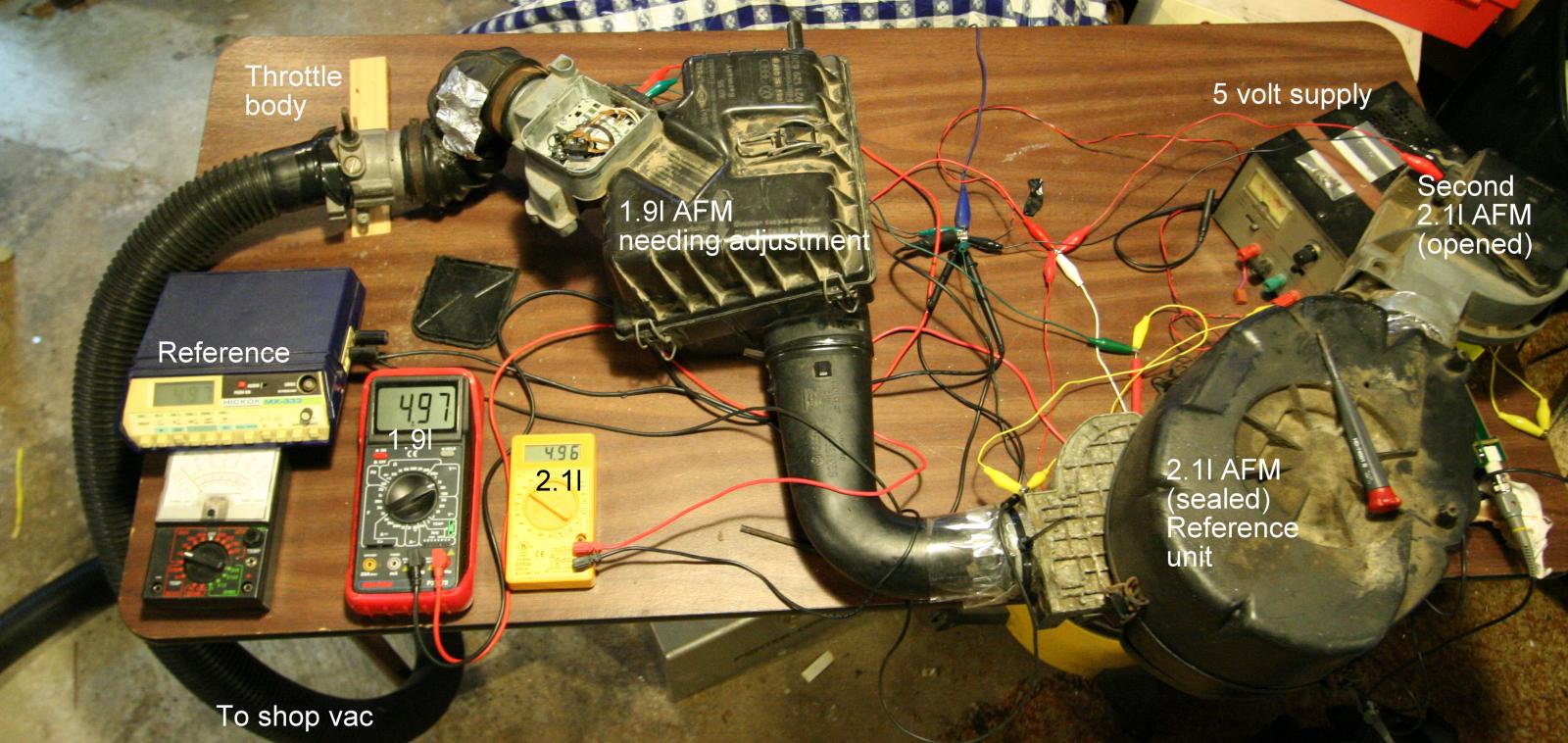

dbeierl
Joined: April 22, 2009
Posts: 165
Location: Providence, Rhode Island, USA
dbeierl is offline
PostPosted: Tue Apr 23, 2019 8:32 am    Post subject: Re: AFM replacement wiper board Reply with quote
DanHoug wrote:
no, not yet. i'm waiting for a spring scale to arrive so i can set the arm tension to the exact value of my current AFM. i've been tweaking my spring tension yet again and am really happy with the drivability and mpg so i've very close... waiting on eBay for the spring scale.
You might find this arrangement useful...
