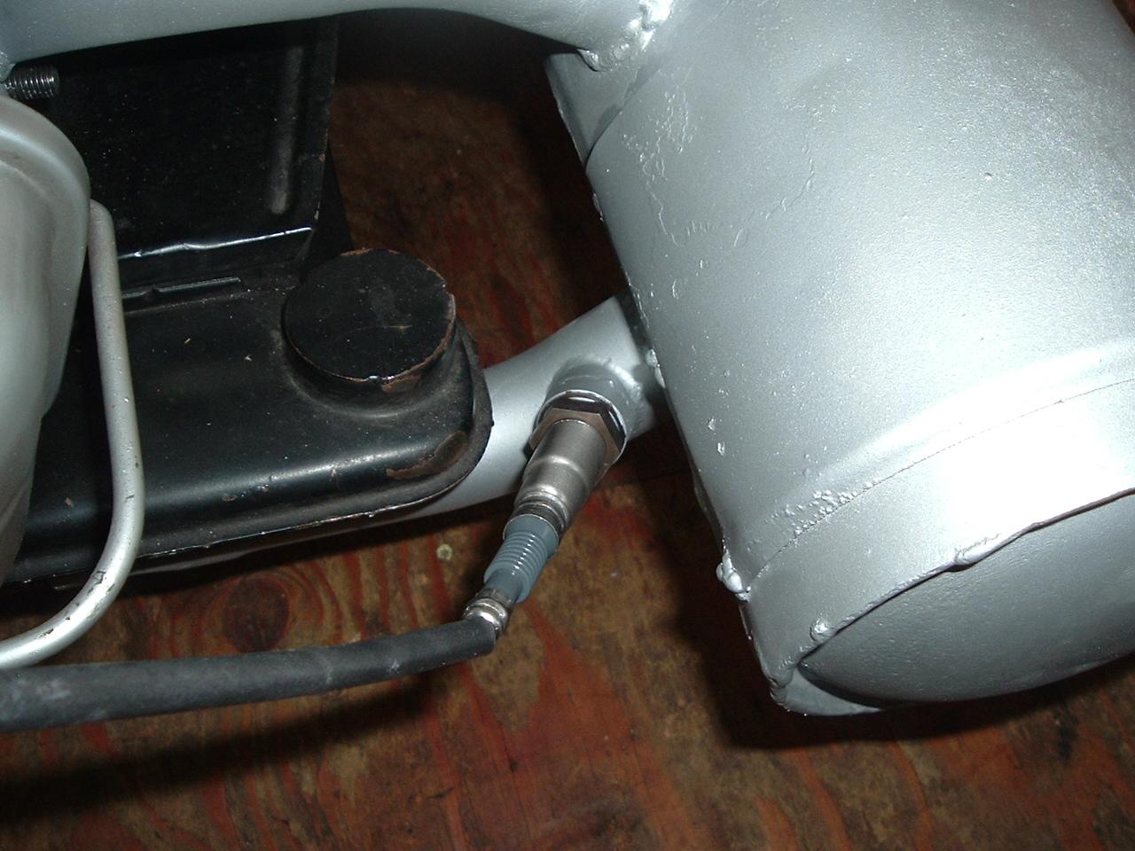

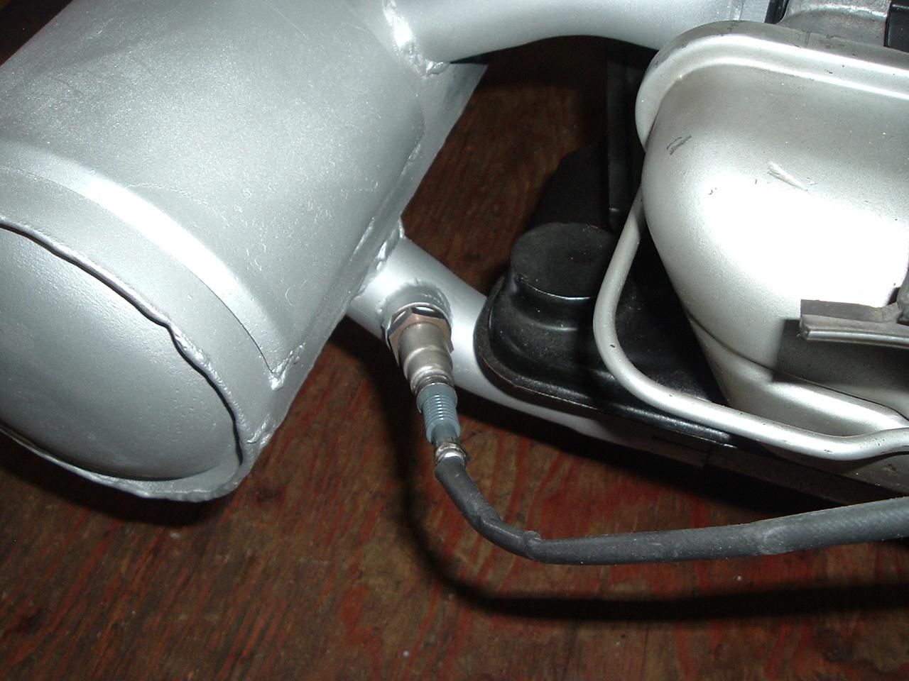

Bung location on both lower header pipes. I don't have a picture of the top of the carb but I'll get one soon.

How does it drive? I'd be concerned about trusting readings under all rpm/load conditions with that exhaust and sensor location.

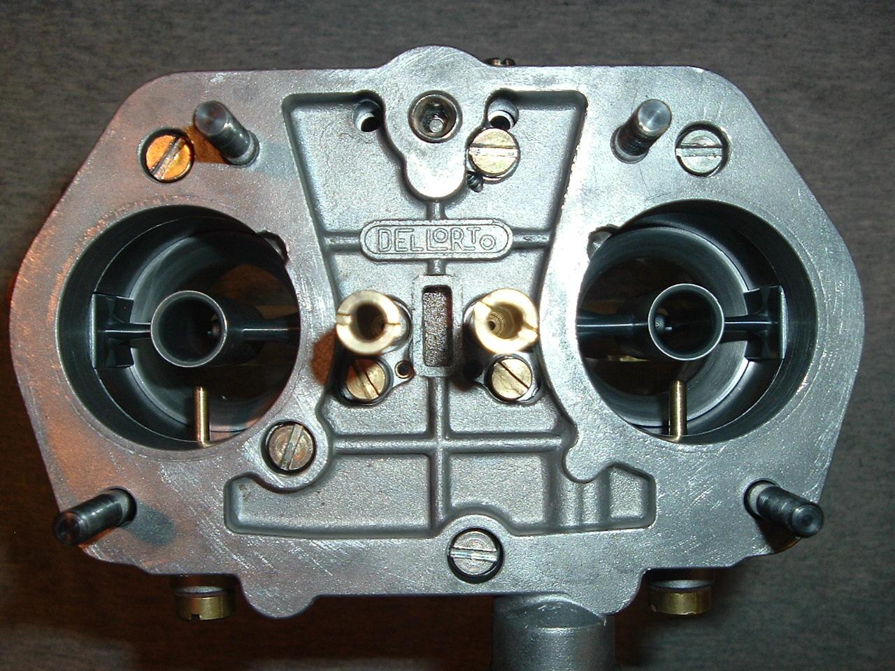

carb top photo:

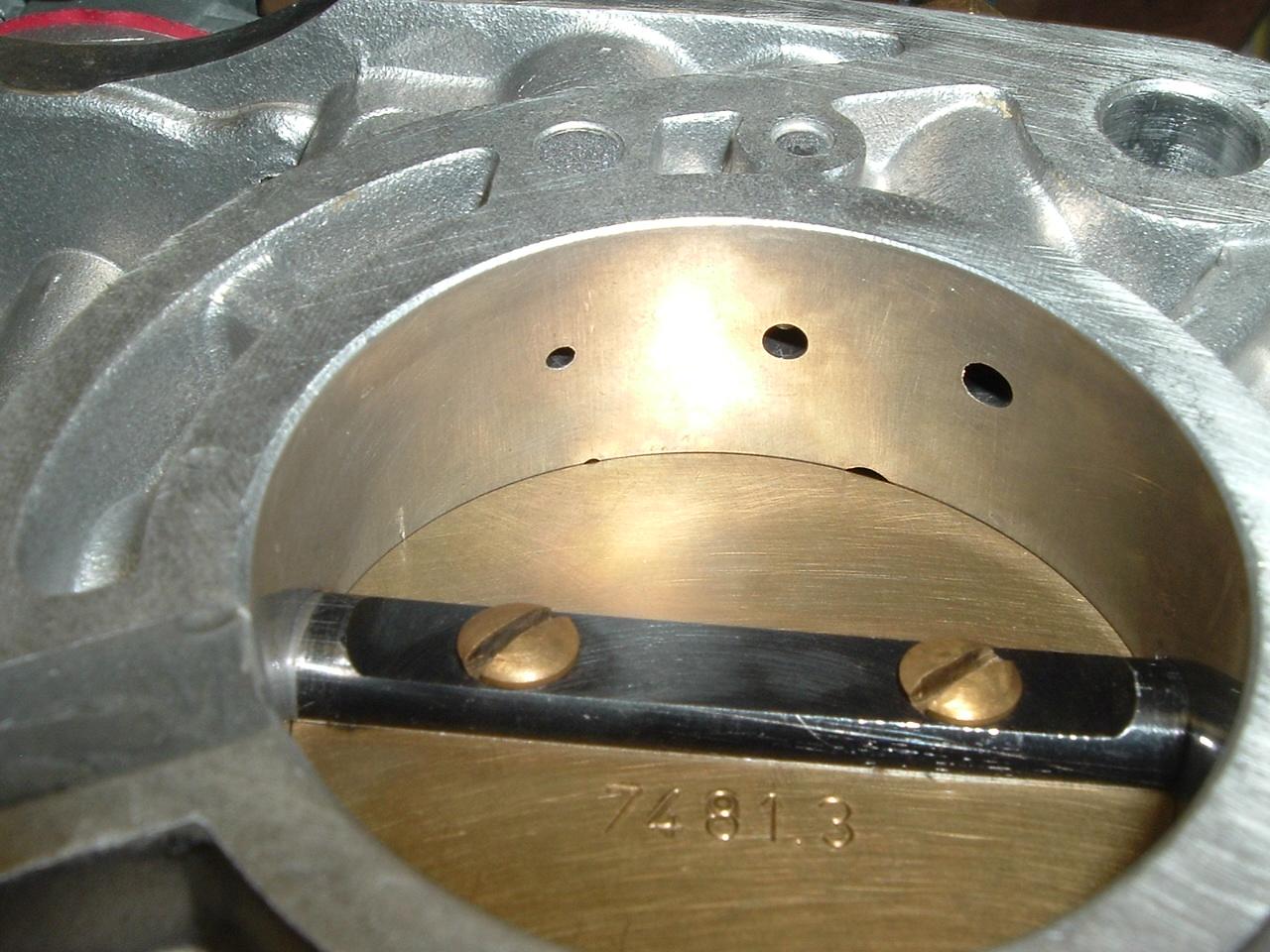

progression holes:
!st progression hole (on left) at idle setting:
Modoc,
Measured top holes on both carbs at 1.4mm (.055"). The next 3 lower holes were also 1.4mm. What surprised me was the bottom holes on the right carb were 1.0mm (.039") and the bottom holes on the left carb are .95mm (.037"). Was wondering if I should open up the smaller holes to 1.0mm just to be symmetrical?

Alstrup didn't notice the boosters are UPSIDE DOWN Evil or Very Mad
but you did request pics, so, your still my hero

40drla from alfa, the ports are 100-140-140-140-140
40drla like CB sold 100-160-160-180-180
All of them are the same pattern, but the hole sizes are different.
Do not pay attention to where the holes are in relation to the cover, the holes are drilled in relation to the throttle plate, and the cover is just machined to match the casting.

Your lean spot will be cured by installing the boosters the correct direction.
If you were running 32mm or 34mm venturis then i would recomend enlarging the transfer port, but, I think more testing is needed before doing that. Although, yeah I'd go ahead and fix the .95 with a 1mm drill.
oxidation can make them grow smaller.

Re-do everything with the aux venturis oriented properly. That was your headache.
