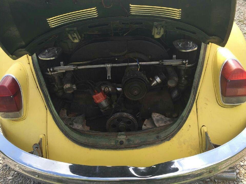

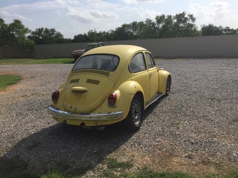

I say its Cal Look, but because theres always a cat in it or on it the wife says its the Cat-Look Beetle, lol. I picked this up two years ago off this site and have been driving it as is. Awesome commuter, don't worry about it getting dinged up or scratched up, let alone stolen. Just enjoy rolling it !!!
Pics when I got it...

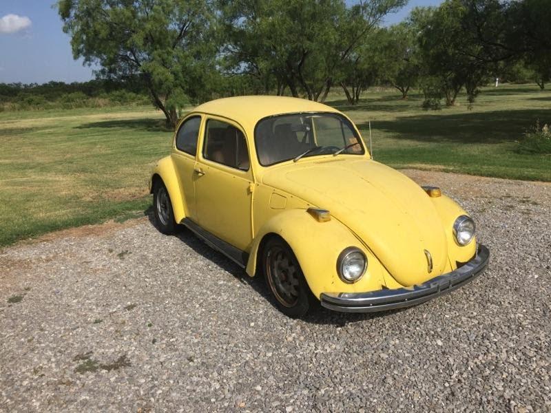

The car is a 71 standard beetle, adjustable front end and lowered spindles. Aftermarket stock interior, had some nasty shag carpet in it. It promptly got ripped out, which revealed that pan was in great shape, the battery tray needing some slight attention.
Originally the car had come with a fresh 1641 with some terrible running 36 Dellortos., I took apart the motor and put some 88 P/C to bump it up to a 1679, at the same time I rebuilt some 40 Kadrons with some custom venturies, jets, and velocity stacks from Jeff at the Kaddie Shack. I drove that for a few months and then traded the motor for a 1914 with dual 44's.

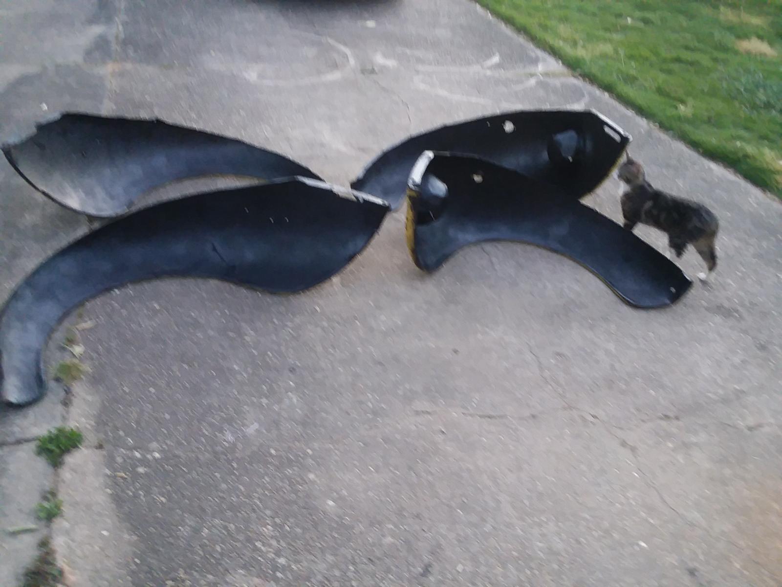

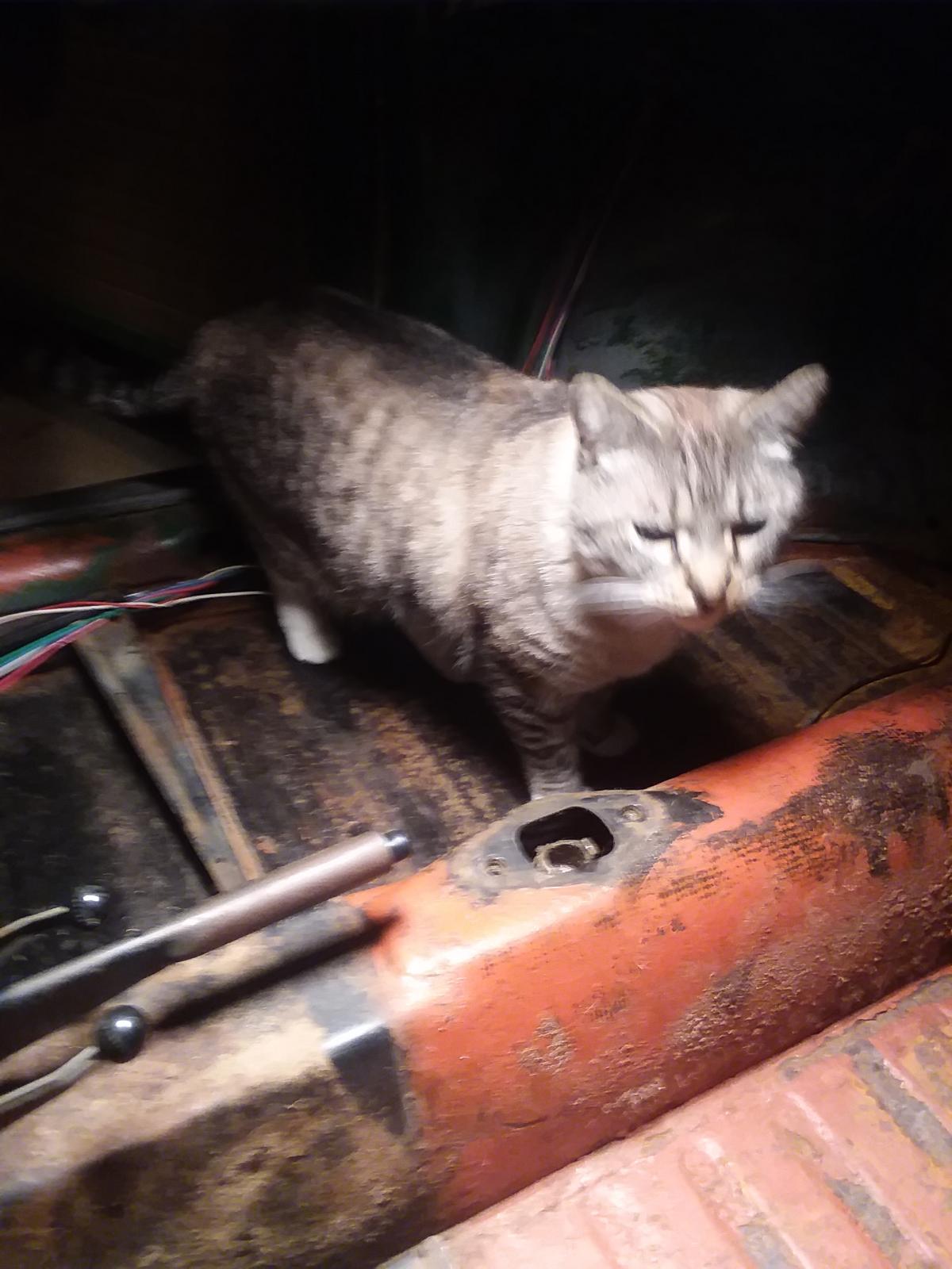

Some disassembly to clean the fenderwells up. About 50% of the factory undetcoating had peeled off. When I cleaned it up with the pressure washer the other 50% peeled off, lol. All the fender wells are rust free ! I even managed to get all the fender bolts to come out without any type of carnage. I guess their is a first time for everything...
I could ratrod it...and some pics of the cats being in the way...

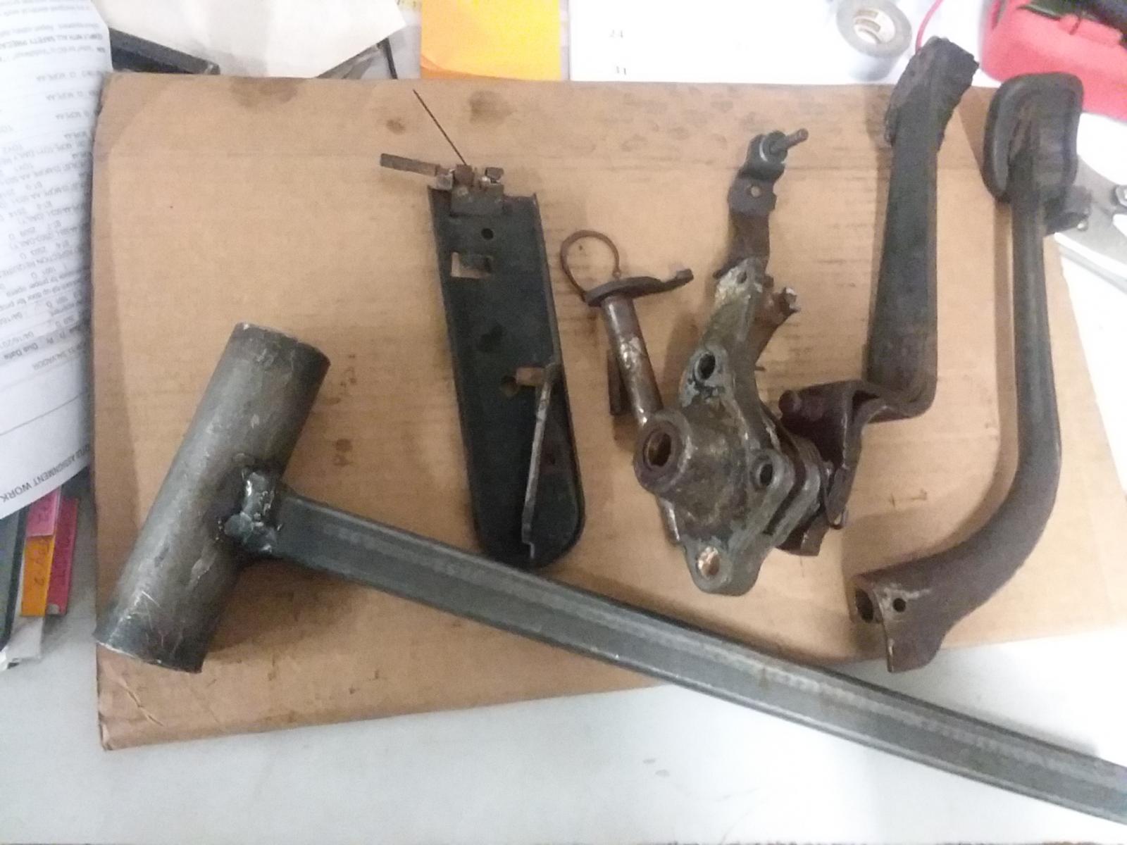

Before I parked it the pedal assembly was a lol sticky. When I started messing with it, I found the pedal assembly had completely siezed!!! Got it apart and cleaned up. It fought me every step of the way (I wouldn't have it any other way, no fun when stuff is easy, lol) Had to bust out the BFH, It won!!!

Dude makes his own Thor Hammer. Cool
