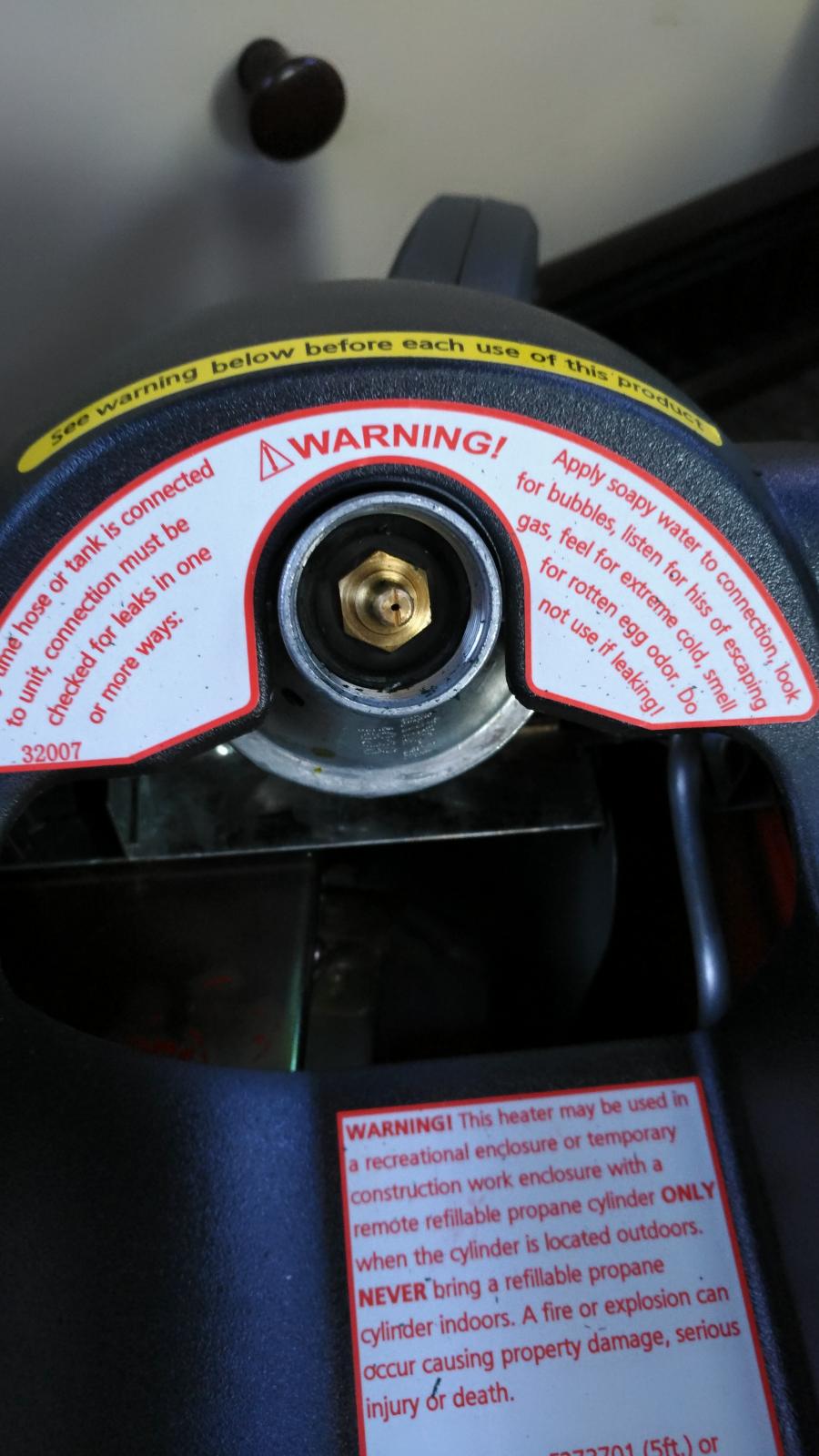

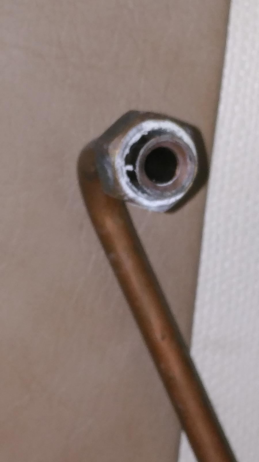

I have a Mr Buddy heater that I would like to connect to the onboard propane tank. I have removed the fridge. Is there a hose that will connect to the propane tank line and then to the heater? Both ends would have to be male.

the propane hard line is standard 3/8 flare

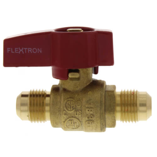

you will want to put a shut off valve on the end of the copper 1st then the new flex hose. I also recommend you better secure the copper once it's made up.
you don't need a regulator since the tank already has one on it, and the buddy heater end acts as a regulator.
https://www.google.com/search?q=3%2F8+flare+ball+valve
something like this will allow a BBQ style hose to fit on.
https://www.supplyhouse.com/Everflow-FTGV-38R38R-3-8-Flare-Gas-Ball-Valve

You can see in the OP photo the heater has an built-in regulator that the green bottle screws into. That is why I was curious if the heater works ok when the pressure is already lowered by the Westy regulator. I'd prefer that it did so I wouldn't need to run a line for high pressure propane inside my van.
EDIT:::Here is a heater parts list that includes and shows the built-in regulator, set for 11" like the Westy regulator is also set for.
https://www.ereplacementparts.com/heater-mh9b-heater-parts-c-197733_197735_202230.html
If it is ok to feed the heater propane that has already been regulated to 11" that is what I was curious about.

adapting your heater to the copper pipe shown (regulated outside) can be done safely. A propane shop can make you a proper hose to adapt directly to the Buddy heater.
