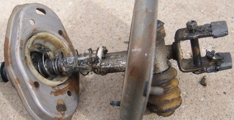

Gnarlodious wrote:
You should examine the plastic ball under the gearshift rod. When it wears out it pops apart from the spring inside. From then on shifting is vague and tricky because the whole shifter is loose. If the rod moves up and down easily that’s your prob. A new owner would be excused in thinking that was normal shift action. You can drive with a broken shifter ball (I did it all winter once), and it is pretty easy when you are used to it, but trying to learn that way would be difficult. A broken shifter ball pretty much looks like this:
You can see the white plastic upper hemisphere stuck up inside the socket, and the spring that keeps it tight like a hinge. A non-broken ball would be held together by hooky tabs, with the spring compressed inside...
No direct experience, but I can't imagine the diesel shifter is any different. Git 'r done! Cool

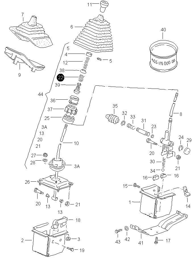

OK, yes I am concerned about this shifter ball. My shifting, when seen from below (with my vid cam) looks really OK, so I don't quite understand how if the shifting "looks good" it still in not good.
Anyhow, I'll go out right now in the cold and rain and have a good look at this 'half-ball'. PART#39 is the culprit.

Part number 39 is a typical failure item. That with part 38 and both 36 pieces you cover the usual issues. A full kit with more than you need may be the most economical in spite of not needing a lot of it.
Didn't see that stuff on the T3technique link. Other places have it for sure, such as VanCafe who lists both the early 12mm kit and the more common 14mm kit.

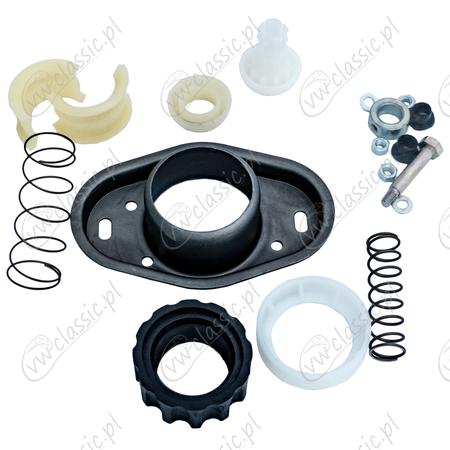

...just that 'half ball' Number 39 (251 711 645) is available at many sites for around 5 - 10 $... but it is necessary to get a whole set I wonder... this is around $50 from Poland.
The full kit is 251798116A

You might try looking under a different part number: 1131700810
https://www.ebay.de/itm/Reparatursatz-Schalthebel-...2566028688
https://www.ebay.de/p/JP-Group-1131700810/1940750426
I don't know how many truly different makers of the kits there are. These are probably 14mm kits but various sellers claim they cover all years. Don't know.

Wow, thanks Mark! I don't know how you found those... this one is really cheap. 27eur incl tax and shipping.
With these new part numbers, if my parts guy can find the stuff, I will get this one from ebay and just rebuild the whole thing...... ....looks pretty tricky to do that however! Shocked
