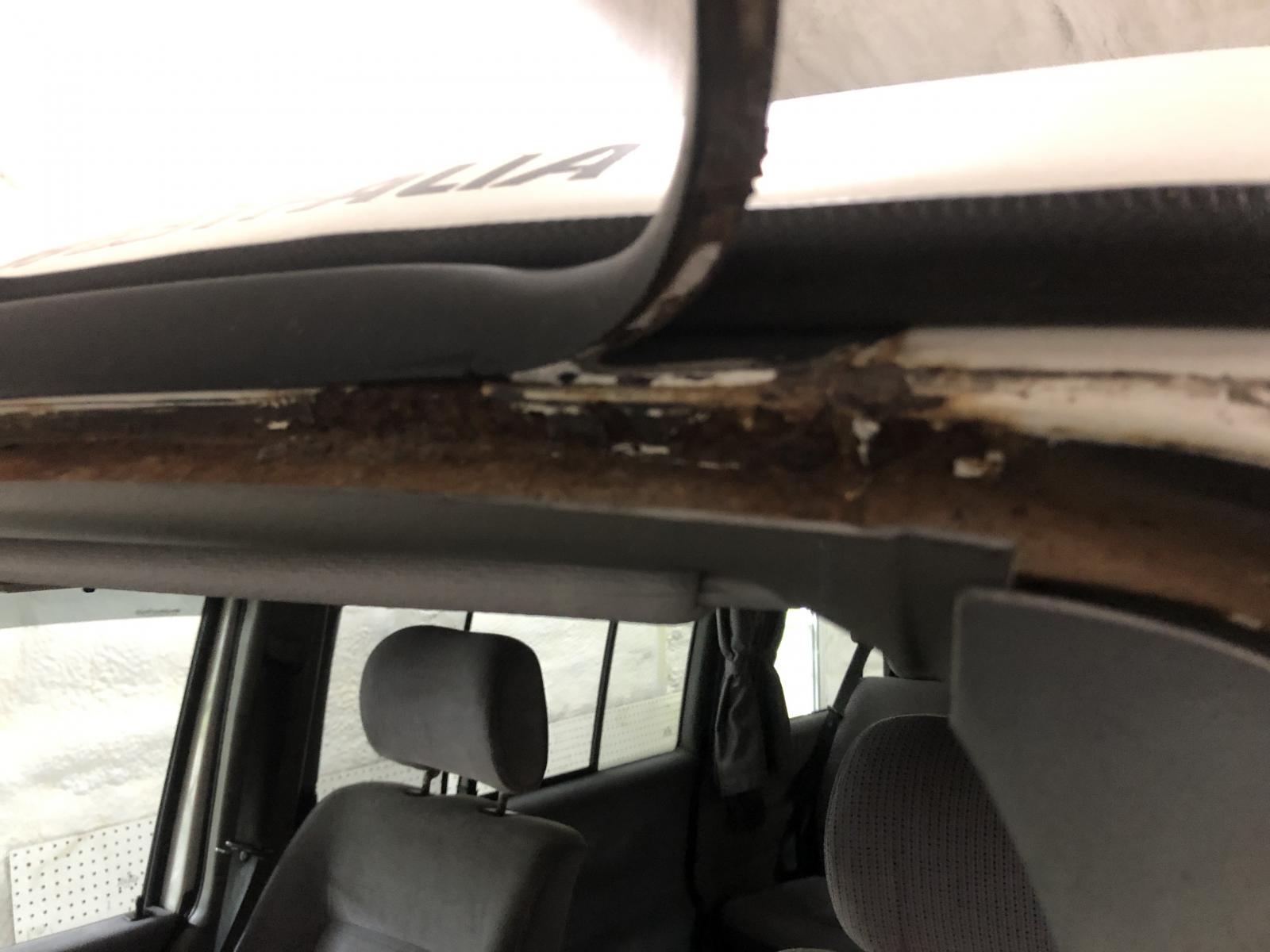

i decided to bite the bullet and repair the rust that is showing around my windshield. the windshield has been pulled out and my rust repair expert welder has appraised me of what we are up against.
the sill is rotten in places and we are planning to weld in new metal and fabricate a lip especially along the bottom for the windshield replacement. it seems that someone put some kind of tarry crap on the sill to cover up rust on a previous windshield replacement. it needs to be ground down to metal all the way around.
in order to do the work, we need to remove the thick rubber strip between the windshield and the pop-top. it appears to have been glued in place at the factory. is that all that's holding it? what type of glue is best? any advice about removal and reinstalling the rubber after the windshield is back in is appreciated!

thanks for the suggestion. hopefully yours won’t be as bad as mine. i think my problem was mostly from the crap that was put in on a previous repair. just got pix.

That looks ugly Shocked Scary thing is that the metal around the windshield on mine looks similar to your, meaning I may have similar deterioration. Gulp...

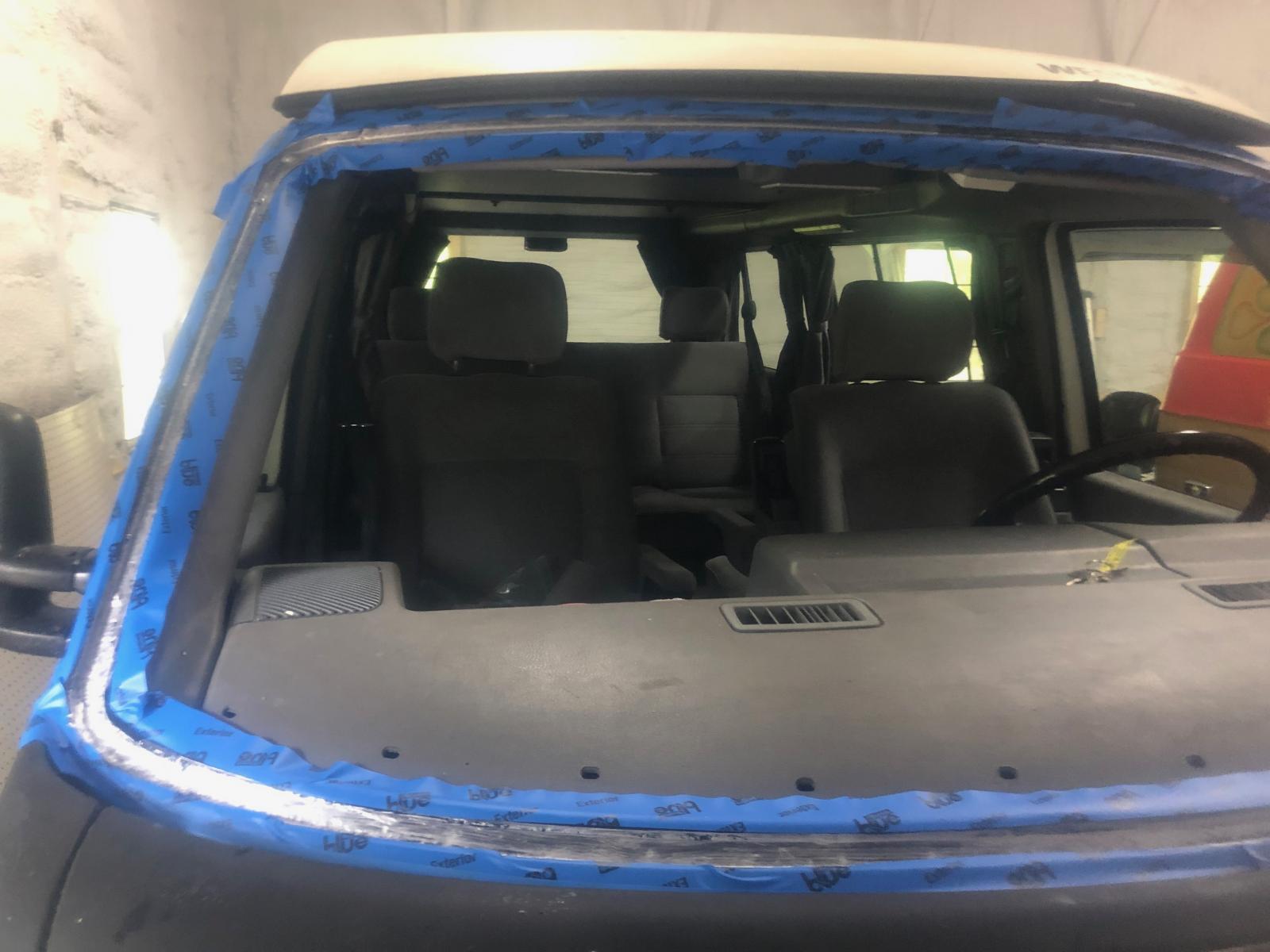

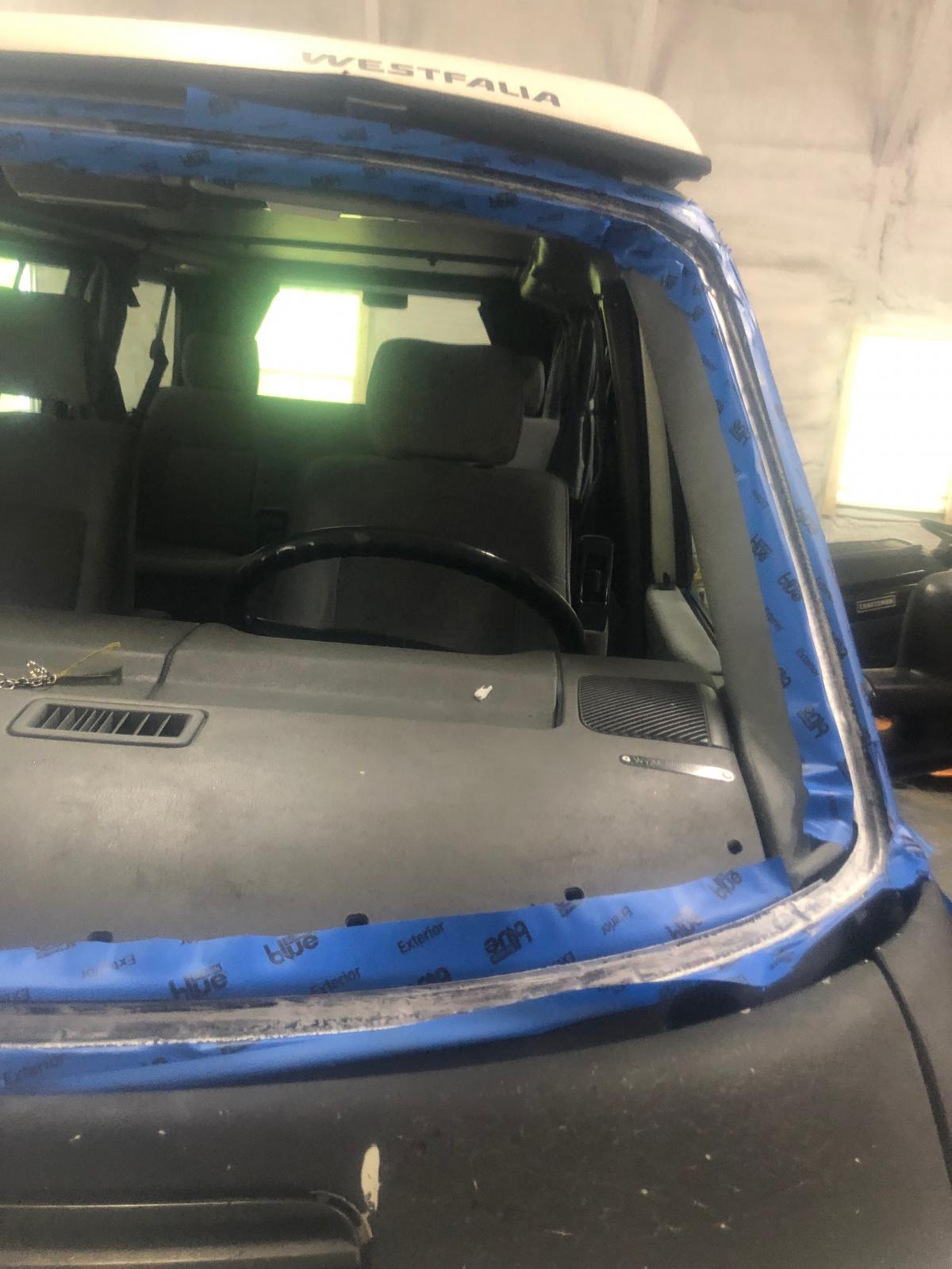

PostPosted: Tue Jun 04, 2019 12:57 am    Post subject: Re: Windshield Sill Rust Repair Reply with quote
i'm working with doug rose of rustoration in woodbury connecticut. so far, he has ground out the rotten metal, welded in new metal through the channel and sealed and acid cleaned it. the windshield is going back in a couple of days. i never imagined when i bought this van that it had this kind of damage under the paint but in for a penny, in for a pound. i just hopes it holds up...

here’s some more photos. i'm picking it up on tuesday

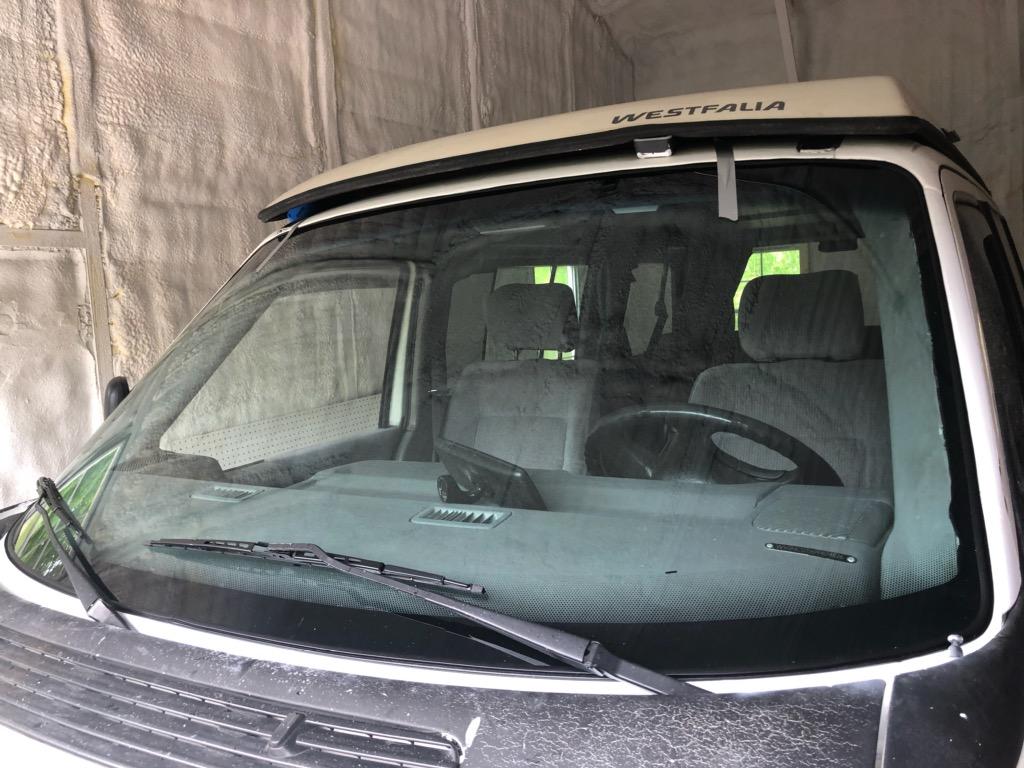

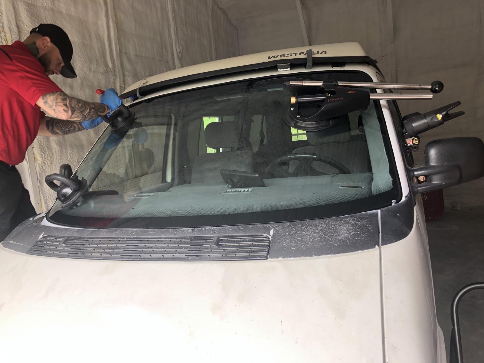

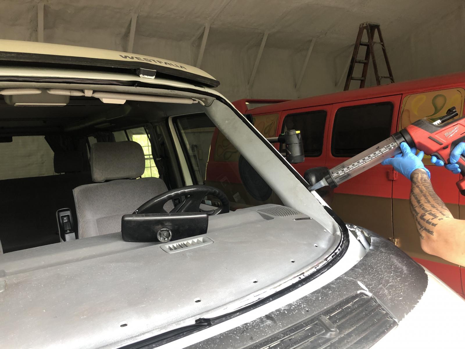

PostPosted: Tue Jun 11, 2019 1:40 pm    Post subject: Re: Windshield Sill Rust Repair Reply with quote
a couple more photos
'93 EV Wkndr – 5 cylinder – 5 speed - 280k+ miles
16CVs Premium Member
Joined: February 22, 2004
Posts: 4224
16CVs is offline
PostPosted: Tue Jun 18, 2019 11:41 pm    Post subject: Re: Windshield Sill Rust Repair Reply with quote
Why did the installer prime the surface over your fresh paint? Primer is designed for raw metal like when you scratch the metal during a removal.
They should have just used an Aktivator prep instead. What was the point of the gray tape? with the molding installed the glass is self centering and will not slide down.
The reason it was rusty was from a previous install, no doubt. Hopefully when they did the repair they did not use any filler or clear coat on the glue surface.
In my estimation that repair will last about 3 years. Be sure to blow a high pressure water hose between the trim and thed body and push out any standing dirt and crap. Rust on cars in the glass area is a total bitch and anything short of full metal replacment will just come back to haunt you.

PostPosted: Wed Jun 19, 2019 8:32 am    Post subject: Re: Windshield Sill Rust Repair Reply with quote
I've used tape to force molding down while the urethane sets. Maybe it was curling up at the top? Or maybe the opening is larger now from the welding. Maybe the OP can say.
The paint question is interesting. My Ford had the OEM paint under the primer and urethane. I've read that priming scratches will help against rust (and certainly should be done) but much better never to scratch in the first place. So leaving it as bare metal for the windshield primer...not so sure. But anything between the primer and metal determines the bond strength... Hmm. What to do when you've ground off everything.

PostPosted: Sun Jun 30, 2019 2:57 pm    Post subject: Re: Windshield Sill Rust Repair Reply with quote
i'm no expert but this is what i was told. the black stuff is kbs rust proof coating. it was put directly on the windshield frame after the frame was ground down, new metal welded in and acid washed. i was told this was the best way to seal the metal from further rusting.
