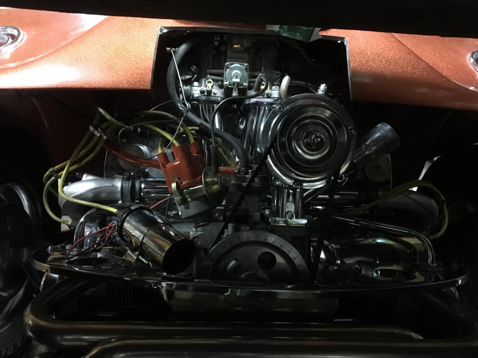

A picture of the carb and intake would clear up a lot of misunderstanding here.

Here is the carb/intake style.

mcmscott is offline
PostPosted: Sat May 11, 2019 8:24 am    Post subject: Re: Cylinders 1 and 3 not firing. Reply with quote
Ken wrote:
FreeBug wrote:
What's the cam? The lopiness and non-firing of those cylinders is largely because of the cam. I say this because engines with stock cams do not have this problem with twin carbs.
Engle 110
And there you go, that cam does not play well with a single carb, also bleeds off cylinder pressure so the static compression needs to be set higher, this explains the low compression numbers. Simply put, a very bad combination.
