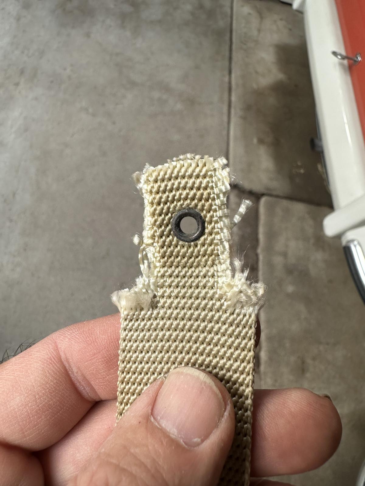

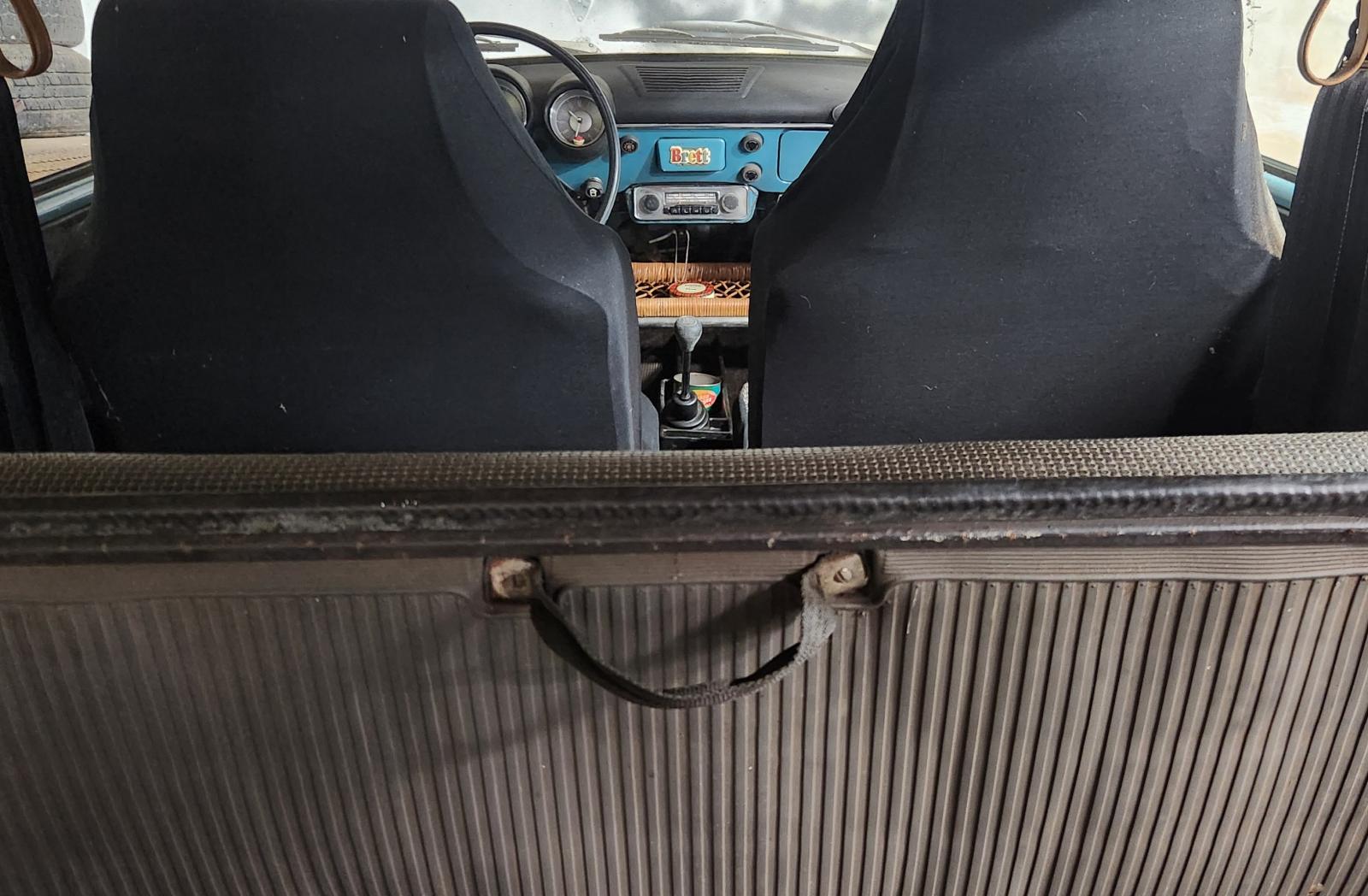

After spending tons of $ and time looking for NOS rear seat handles that fall apart and a couple of repros. I just decided to put back what Mr Goodman the original owner had in place since back in the 60’s.
Broken NOS handle
Very well made
Looks good!

Did the repros break too?
The good used one on my '63 is intact but I don't pull on it with any force

They call me kitty soft paws. I don’t break anything. They all literally fell apart, the remaining pieces stuck on the seat back, broke into two when I unscrewed them. My garage is not that hot, most of all the rubber or plastic /vinyl components are still plyable.

Yup, I used an old original one until it broke, then I used a section of a seat belt back there. It stayed in place and was useful until I sold the car. As far as I know it's still on there doing it's job.

Similarly, I used a section of a tie-down strap.
It's held up since about 2007, and I don't anticipate it'll break anytime soon.
Very nice!

I think I've snapped 3 or 4 NOS handles now. I stupidly yanked on the one I installed in my '63 Squareback a few weeks ago and there it went. The repro handles we made are better, I just haven't installed one yet.
The NOS handles we had are all gone and I would recommend they stay in your parts cabinet for display purposes only...
Yeah, I don't know what kind of rubber they were originally made of, but it's not very durable with some age on them. By now they're display only things.
I just checked out the seat belt I put on my old Square back in 1998, and it's still fine and working good.
I think it's a combo of poor design, petrified rubber, and heavy seat backs that are awkward to lift in the down position. We did a lot of testing on the new handles, but I still recommend grabbing the seat back by the corner versus relying solely on the rubber handle.

Hi there if your stuck i cut the shape of the handle out of some thickish leather and dyied it black and had a small velcro tab to keep it down looked the part until i located a good one a few years later

If the reply was for me, allwagons? Thank You. I will keep it in mind. For now, I will continue to use the canvas handle the original owner used.

I ended up using one of those guitar case type handles. The ones that sit flat but can slide slightly outward. I believe Josh suggested it to me. Put it on Amazon, it works a treat.
