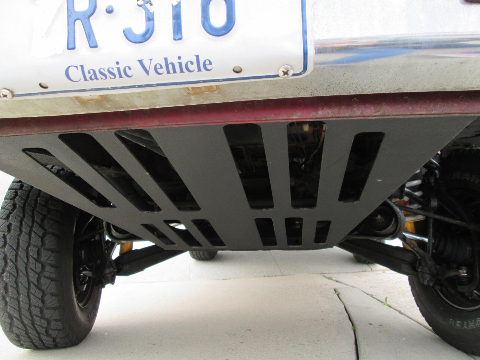

Not wanting any overheating issues on a 2.2 high compression WBX I was installing, I made some cooling system changes on my '87 Syncro:
1. Lower temp engine thermostat installed;
2. Lower temp "fan-on" radiator switch;
3. 10c oil cooler with fan (& retained the factory oil-wtr heat exchanger);
4. Removed AC condenser from in front of the radiator (along with the entire AC system);
5. Advanced engine timing about 8 deg;
6. Gutted original catalytic converter (to help lower exhaust / compartment temps).
Side note: I discovered that the skid plate I installed where the spare tire used to live was getting pretty warm from the air leaving the radiator. To help the airflow escape, I cut some slots in it. The factory radiator fan blows the air straight thru it now.
It's overheat proof, IMO. I can let it idle forever. I only use VW G12 coolant (or G13?) & distilled water, 50/50. My pressure cap is an OEM black version (not blue). It has a slightly higher operating pressure value. My temp needle hovers just below or over the bottom part of red LED. Doesn't matter if it's hot or cold outside, if I'm stuck in traffic, driving in low gear off-road, or driving up to the mtns.
Other mods include extended scoops at the pillar vents & a propped license plate lid. Also, not sure if it makes any difference in engine compartment temps, but the rear aftermarket bumper I'm using doesn't cover those little vent openings above the cat/muffler like the factory bumper does.
The only issue I've had was a plastic water manifold cracking. It didn't get hot, but the water loss caused the LED light in the temp gauge to blink. I replaced it with a s/s one. I think this is a Syncro only part.
One more thing, I really like the pressure bleeder that GW sells. Works great on my van, and I've also used in on my Golf & Jetta.
Hope this helps Smile
