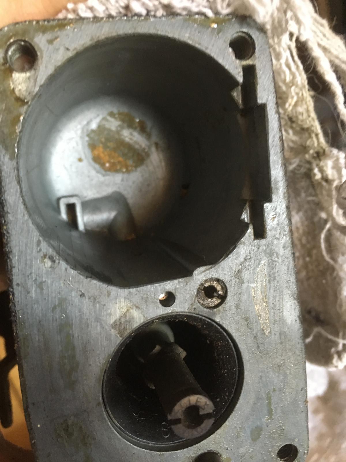

Today's little project is to clean up a carburetor ready for a rebuild kit. Good thing took apart before ordering, some reason missing a float bowl in one. Can't remember if I bought this for him or not. Was a bit taken back finding that.
Fuel bowl on the other can see where the float was touching, cleaned off though did leave a stain.
What was this tag for? Nothing on it now.
Off to reassemble the bottom half and repeat for the top.

That carb is for a 36 HP engine. Not ideal for a post-JUL60 40 HP engine.
Look on the underside of the tag, after cleaning it up some.

Well bummer. Guess can't trust everything online. Sure appreciate knowing this now than after tearing down the other and rebuilding both of them.
Are they worth selling?
Right now has a 28PCIT-1 which I thought was for the 1300cc engines.

Define worth. Not going to make hundreds of bucks off of them.
Back in the day when old 356 Porches were a dime a dozen, the brake shoe cores were tossed out due to most owners were not worried about getting back the $10.00 core charge from the FLAPS.
Think it was in the latter 1990s the cores dried up and owners were constantly advertising for many more times more for brake cores just so they could get a set of brakes rebuilt for their one and only 356...
You can do a few searches of the classifieds for general prices of parts like that. Big problem is you can not say you have run either on a 36 HP engine and made sure they ran right.
Owners manuals are a great resource for technical data like this:
AUG60
AUG63
VW did build Standard beetles with the still 36 HP engine in back thru the 1970s, but was mostly a Euro poor mans car with little to no frills. Though some were sold in Canada also, any of those you might find in the USA would be a grey market VW.

Worth, as in keeping. A friend and I have thrown out several sets of Squareback glass as no one needs. Feels awful, though I have a garage full and more of Volkswagen parts, some keeping as can't bring myself to toss (like German Hella early Type 3 lenses and housings).
I do trust your right, just mad at myself for not checking before wasting time, except the practice. It's late, so put it into a quart Ziplock half assembled, have too much to do to put back together only to be taken apart.
Being will never get married and have children, my Sister probably just pitch it all in the trash. Not like she cares enough for me to let her know what to donate.
Edit
Here is the differences:
28 PCI... with removable Venture... Venturi =21.5 mm... Main Jet = 117.5/122.5... Air correction jet
=180/200...Pilot jet = g50... Idle air jet drilling = 0.8... Power fuel jet = no...Emulsion tube = 29
28PICT-1... 1961-1965....Venturi = 22.5 mm... Main Jet =122.5... Air correction jet=125z/130Y
Pilot jet =g55... Acc pump jet = .50...Idle air jet drilling = 150... Power fuel jet=1.0mm
Accelerator pump feed = 1.1-1.4cc/stroke...First year of Automatic choke.
30 PICT-1... 1966-1967...Venturi = 24.0 mm... Main Jet = 125... Air correction jet =125z/135z
Pilot jet = g55... Idle air jet drilling = 150... Acc pump jet = 50...Power fuel jet = __
Accelerator pump feed = 1.1-1.6cc/stroke...Larger Venturi
30 PICT-2...1968-1969...Venturi = 24.0 mm... Main Jet = 116/125... Air correction jet =125z/135z
Pilot jet = g55... Idle air jet drilling = 130/135...Acc. pump jet = 50... Power fuel jet =60
Accelerator pump feed = 1.3-1.6cc/stroke...First year for Power fuel system which draws
fuel directly from the float chamber under full load at high Speed.
30 PICT-3...1970...Venturi = 24.0 mm... Main Jet = 122.5/112... Air correction jet = 125z
Pilot jet=65... Pilot jet air bleed = 135...Acc. pump jet = 42.5... Auxiliary fuel jet = 45
Auxiliary air jet =130...Accelerator pump feed = 1.3-1.6cc/stroke...Idle speed is controlled
by bypass around the throttle plate.

28 PCI also has the manual choke cable setup.
In "PICT", the "T" = electric choke. No "T" = "Manual Choke".
We are running a H 30-PCI on our 1641cc SP engine in the 1960 walk thru panel camper conversion.

Appreciated, was wondering that. Interesting there is a spring loaded diaphragm. Somewhere have a German dictionary, want to look up what word that is.
Why are you running the camper with a manual choke? Or am I getting my dates wrong? Es ist spät...
