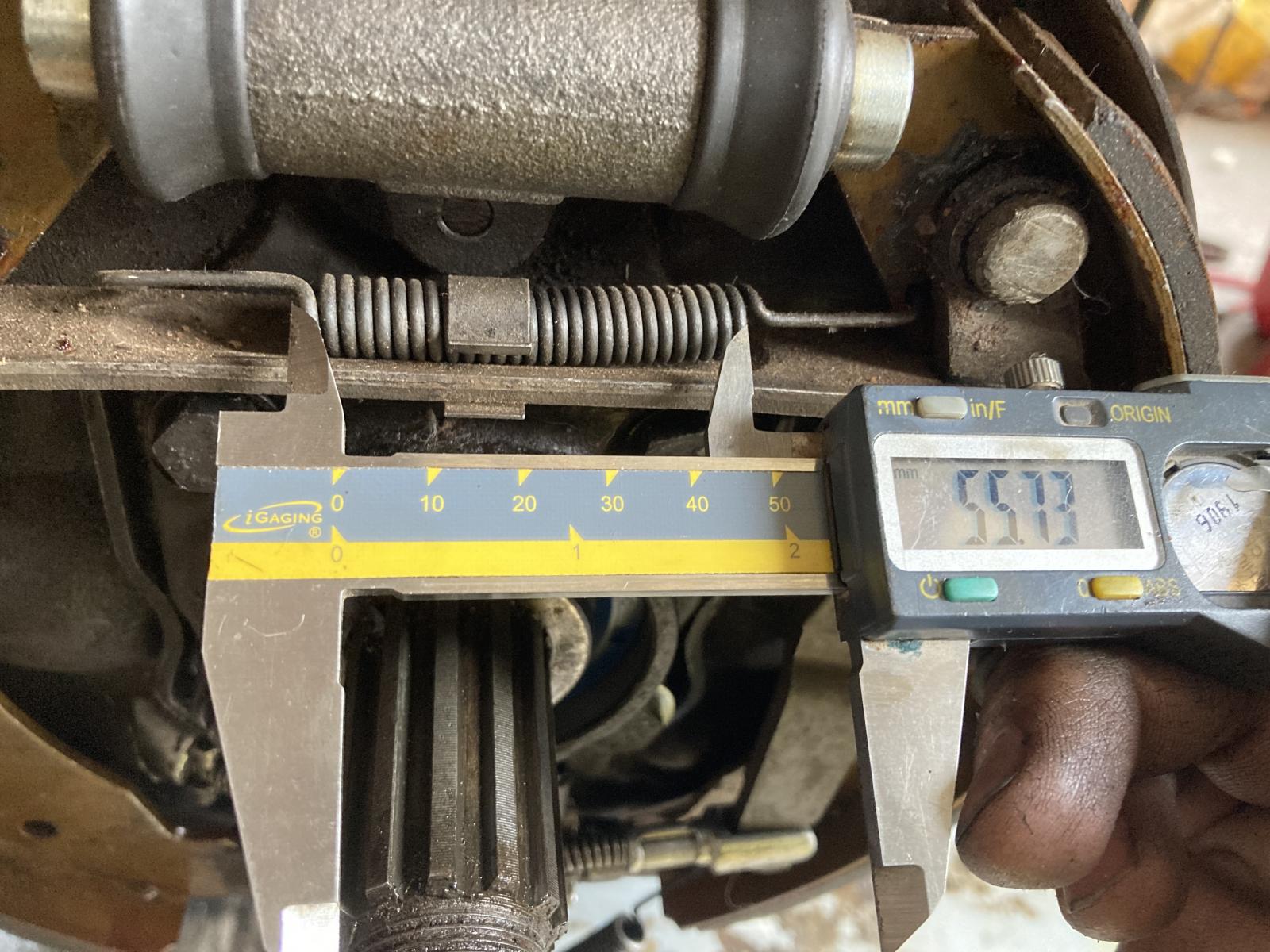

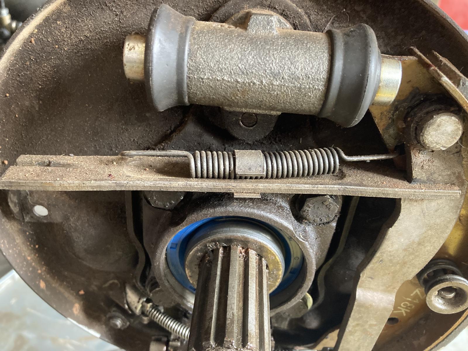

Okay, need some help with the emergency brake cables, please.
Learned something, just because the cables feel tight at the handle does not mean they are tight, had to take the boot off and tighten. Or tried, passenger side was not tightening.
I thought maybe the shoes, found a difference of 0,25mm end to end and 0,5mm between the thickness of the shoes, so swapped the thickets shoe on the driver side (adjusters were significantly further out than the passenger side) to the passenger side.
That led discovering back in February 2020 or so, apparently didn't install this bar. Shocked d'oh! Rolling Eyes Sometimes I wonder how I am able to do anything at all when so stupid. So now on the hunt for the bar and original spring.
Jack, who has posted here on this thread, when sending him the pictures, not only is the passenger side cable's spring section too long, both sides are too long.
Taking some measurements, the passenger axle is further forward, anything wrong with moving it back say 1,0 to 1,5cm to shorten the emergency brake cable?
Jack is super busy, except when going between LA and Sandy Eggo, so we talked then and was a big help with getting things done. Thank you! Very Happy

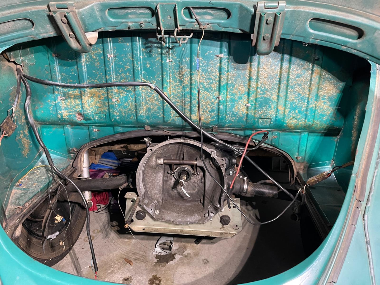

Okay, so how does the wire on the underside run up and into the engine compartment and get to the generator?
Hole that should have grommet.

What about the red wire under the parcel floor?
Appreciate the photograph! Very Happy
Hmmm, the wire doesn't look long enough to reach the generator. Are you sure there are three wires on the terminal?
Three because one from the left front corner of the engine bay I understand from the wiring diagram is to the ignition switch, the one to the starter, and the one going forward under the parcel shelf coming out from under the original undisturbed tar board.
Red goes to the regulator.
Black cable to positive of battery.
Non-stock green wire that should be red going to the top of the starter solenoid is from ignition switch.

Eric, some reason my response disappeared or didn't post. Hal. Hal! Laughing
This is a great picture, better than the one I have of Ruby, much appreciated!
By the way, real handy having the wiring diagram in my thread, no longer have to hunt for it. Only thing is I found out both the warning light wires are not the same background color, shows a dark blue and even under the dash it is a slate grey.

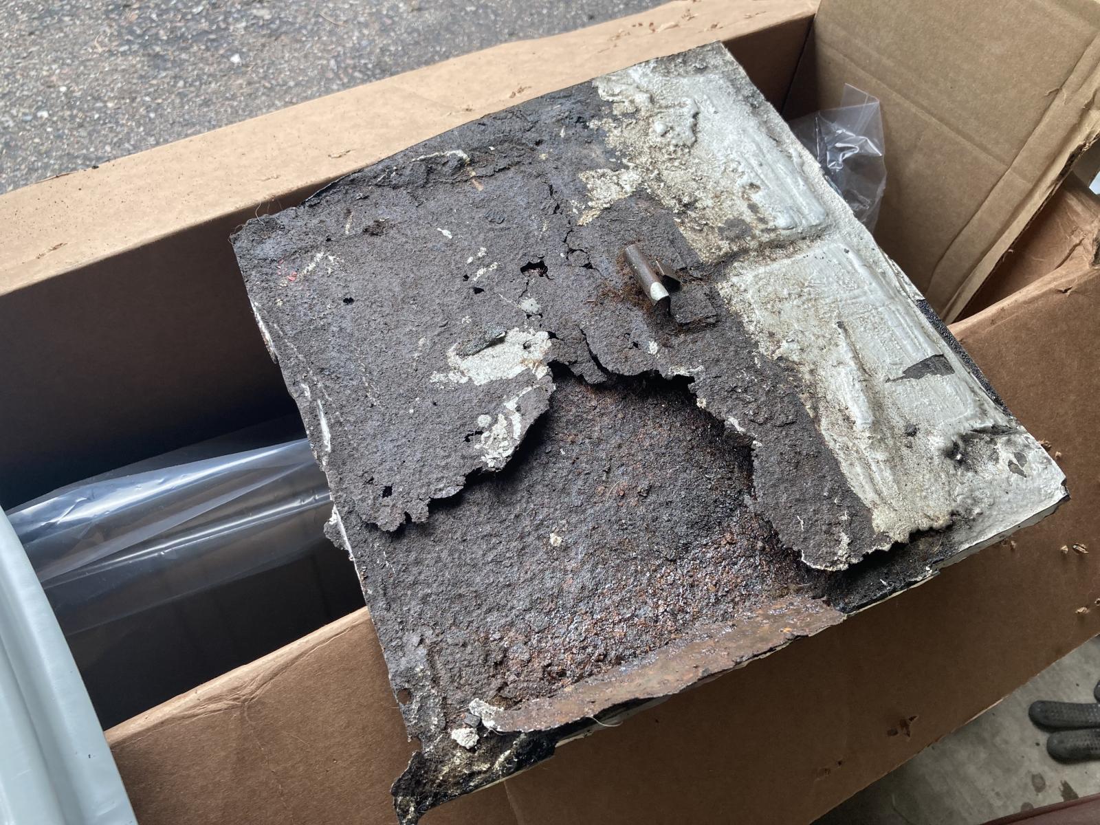

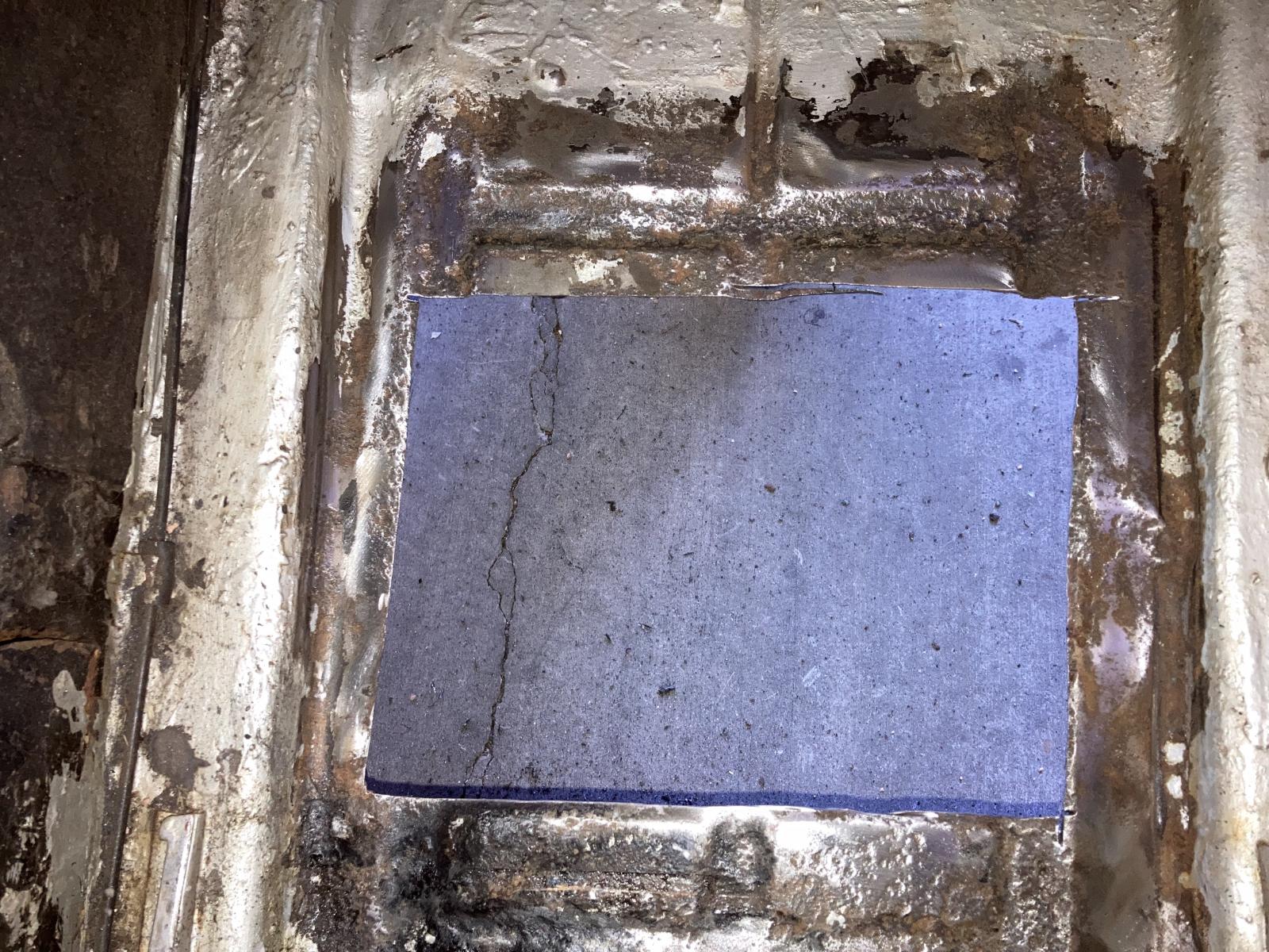

Moved onto the floor pan, battery tray rust and shoddy rust repair cut out (somehow managed to cut down the middle of the welds when cutting the floor pan).
The shop used some super thick plate steel, bet the fuel economy will go up with the weight savings. Laughing
What intrigues me is how much the rust between the two layers, caused by the leaking windshield, pushed the two layers apart. Shocked Without thinking, picked it up off the floor and dumped out a huge pile of rust (despite the lady having a messy garage, I been trying to not to create any mess).
Done?

Looks like it! Would be interesting where the other two wires go off to.....
Great! Thank you for your help, appreciated! 😁
Be more than happy to show you, appreciate a second set of eyes.
One goes into the front side of the firewall, one to generator, one to battery, and one to a vintage “starter” relay.

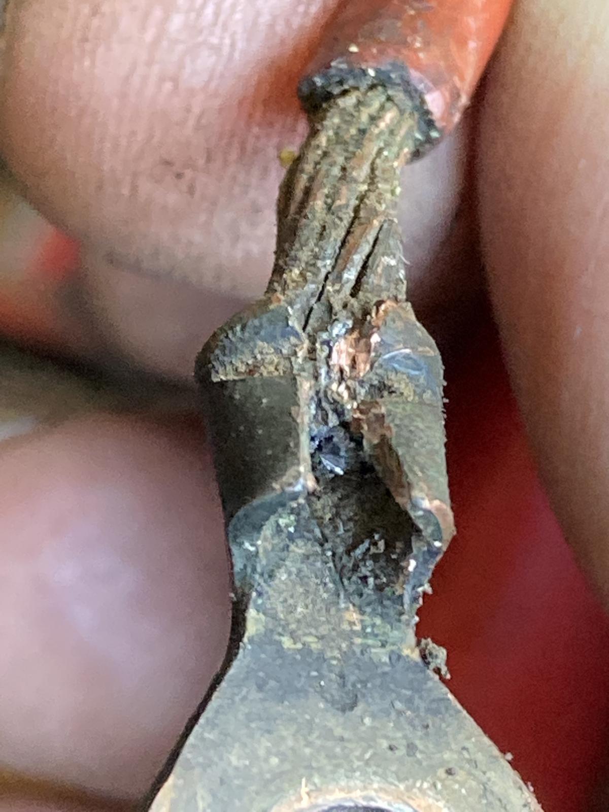

Absolutely knackered and don't feel like I got much done. Let's see:
Repaired four wires, still have one wire to address the broken/crushed insulation and one warning light needs a new end, think best to wait until the engine is in and know have enough length. Looks like the two generator wires to terminal 50 got way too hot, one was burned and melted. Shocked Sure wish Dad was around to ask.

I am glad changed the connectors, clearly shoddy work, especially this one, the crimp missed the end of the wire. Rolling Eyes

Cut the rotted metal out of the driver side pan, cleaned up the edges top and bottom, and treated the top with Ospho.
Cut the patch panel out of the battery section from Wolfsburg West. Need to do some trimming however, I am having trouble using the disk. Razz Maybe time for another pack of disks? Think Laughing
Then spent over an hour getting the driver side heater channel end cap out, forgot to take a picture at the end, find had to pick me up early so lost a hour and half.
Not sure what to do about the fact there are two layers.

So, I brought all the engine long block parts and my tools over here, will be building the engine on the kitchen counter as I originally had planned on. This does have advantages, the big one is will be home all day, the one dog that has to stay home has for over a week been acting unusually needy and very clingy. Another is not having to work in the cold, so cold the oil fill space heater turned all the way up and on full power barely takes the bite out of the air.
So finishing the brakes has to wait until the long block is done. Also, probably going to break his promise of letting me finish the welding, I now know who he really is and certainly not one to trust (broken promises before).
