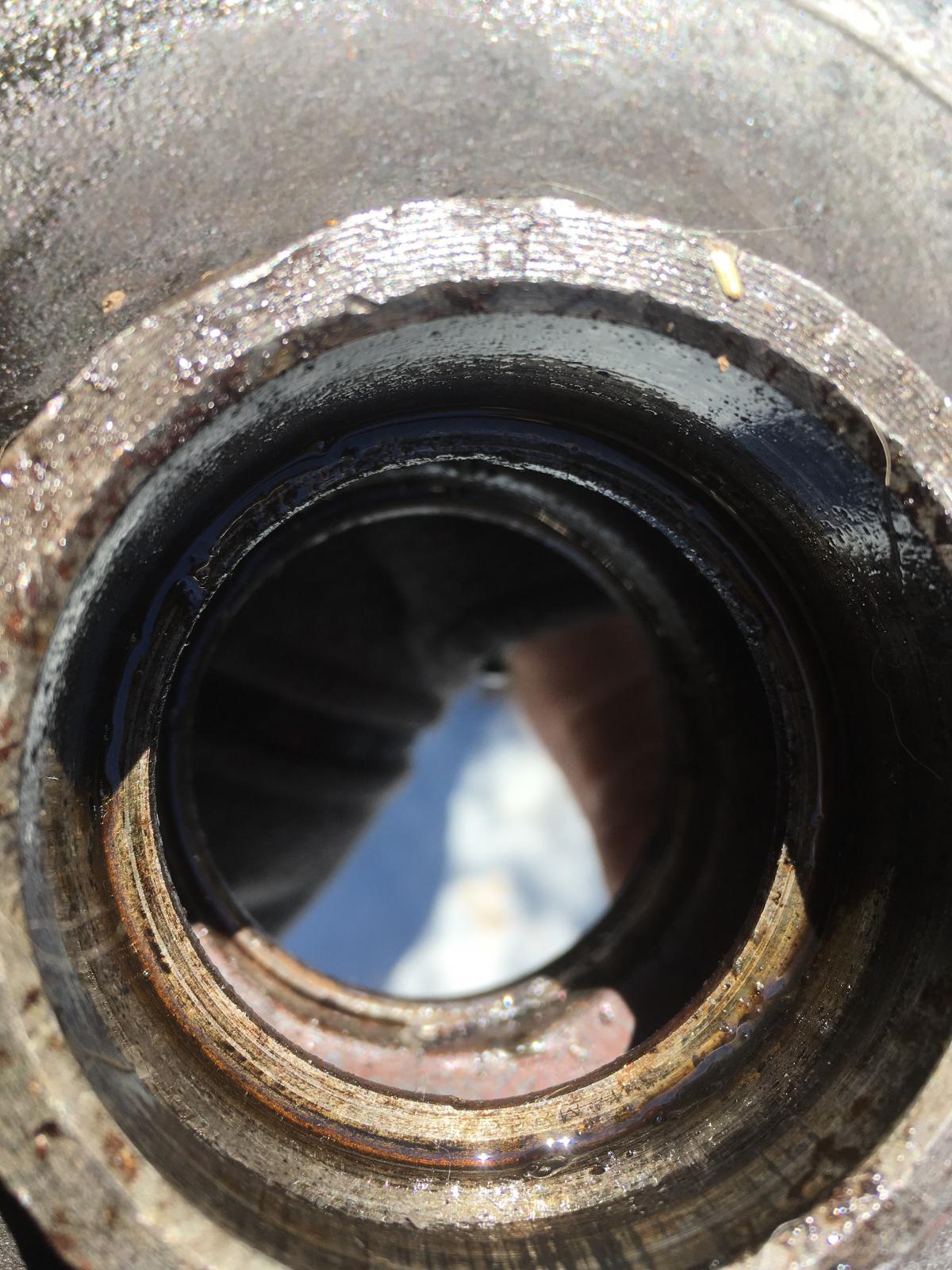

Getting the axel nuts off is a snap... Help!
Adriel Rowley wrote:
Think this should be separate also, not lost in Ruby's build thread (really need to update).
Seems getting the rear axel nuts off is a snap...
Proto
SK Tools
I only have a 3/4 inch drive breaker bar, so need the adapter. I am then using a six foot piece of pipe and laying onto it, with my 185 pounds (which is deceptive as vary from 31 to 33 inch waist). Been many years since had to do science math, that is 1,100 foot pounds, so am I pushing the adapters too far?
Looked at the torque multiplier and only comes half inch drive. Not sure help, thus why here, as rather not waste $100 if no point.
Has anyone had this much trouble and if so, how does one get them off when this stuck?
Thank y'all in advance! Very Happy
Zundfolge1432 wrote:
A final word of caution. Break these loose car on ground I’ve seen people knock a car off jack stands. Not saying you’d do this but someone reading this thread might.
nreslifer wrote:
Torque Meister
Dangermouse wrote:
Doesn't matter what size drive you use as long as it terminates in an 11mm socket... Anyone tried 1/4" ? Laughing
Then you undo those nuts with one hand while whistling a merry tune.
Bryan67 wrote:
Get a 3/4" drive 36mm socket. And don`t use the adapter.
74 Thing wrote:
You need a quality 3/4 to 1/2 inch adapter, or a quality 1/2" breaker bar, or a quality socket that you can use with your current 3/4" breaker bar, or get the Torquemeister.
According to the information for the multiplier, "24FT LBS = 216 LBS", meaning, must use my pipe on a breaker bar.
Huh? No. The torque multiplier is a 9x multiplier. The drive accepts an 11mm socket.
If you put 24 ft lbs of torque on the 11m socket you get 216 ft lbs. at the axle nut.
Axle nuts and gland nuts come free easy with an 11mm socket and a standard 3/8" drive ratchet - I have yet to need more leverage than that.
When reinstalling, put that 11mm socket on a torque wrench.
KTPhil wrote:
Cusser wrote:
I'm in Arizona, have been taking rear axle nuts and gland nuts off for almost 50 years now. I use a Craftsman 1/2 inch breaker bar (my friend broke it twice over the years, free replacement) with a 4-foot pipe over it. I use a 1/2 drive 12-point socket I bought in early 1970s.
This has been my setup for decades, too, though I don't have to remove them often. With rust and age, (and maybe an idiot tightening them before), the required torque can be far above 220 ft-lbs. I used a slightly longer pipe (almost 6 ft) on a breaker bar on the RR and actually lifted the front tires off the ground of my Bug before it finally let loose. That must be something north of 600 ft-lbs! That nut was blisteringly hot after it came loose, too!
I also bought a torque tool, and with the split drums on the late Type 3, I haven't had to use it yet.
Helfen wrote:
3/4" breaker bar, very short 3/4" extension, 3/4" 36mm socket, 5ft of 1-1/4' dia. galvanized pipe.
To remove the "rt side axle nut" place the 36mm socket on the nut with the breaker bar clocked to the front of the car, place a little grease on the breaker bar handle, slide the galvanized pipe over the handle about a foot. Place the car in neutral and roll the car forward until the pipe touches the ground. Get in, Start the car and drive forward. LET THE CAR DO THE WORK!!
For the left side do the same in reverse and back up instead.
So simple I can get tools and install and loosen the nut in less than 60 seconds.
rcooled wrote:
If you really need to get an axle nut off and don't have the right tools at hand, try this: Drill the largest hole you can straight in at one of the grooves. Drill thru 'till you reach the drum. With a cold chisel & mallet, put a good whack on the flat above the hole. The nut will crack and usually come off quite easily, no matter how tight it was.
Dangermouse wrote:
When I busted loose the axle nuts on my single cab I took this approach which worked well. 46mm nut so couldn't use the torque meister. Cost me zilch. 3/4" breaker bar and a scaffolding pole FTW.
Moz'z58 wrote:
Looks like you may need other suggestions...?
For me, and most with these cars = 3/4 drive proto breaker bar and 6 point hvy dty Proto and Snap-on impact sockets are my method, with a 4-5' x 1" section of black gas pipe cheater over the bar - this is the way I went when I got my bus in 80's. If your going to drive these you have to invest somehow, esp'ly now when NO ONE will work on them.
I have a tape marker to stand my weight on for final torque guesstimate of 256 I believe for the 46mm bus. Keep in mind it is only near to correct because rarely will that official # number line up with the cotter, which is obviously the failsafe. So backing off to get hole may be 190#. or over to 350# Doesn't matter, it is 'enough' but do keep TRQ as high as possible or drum will work itself on the axle splines. Pack grease into the gaps of splines and get interfaces well greased too to 'seal' for water ingress.
Breaking a 1/2 square drive means you need a 'solution'. My own first problem and lesson in '86 was same as your doing now. A neighbor solved it for me by cutting the nut with a dremel and cut off wheel - took 5 minutes. the cut through was enough relief and it came right off with a cold chisel into the kerf.
But with low bucks I'd try PB Blaster, tapping around the nut also w/ ball peen, and keep soaking - maybe a few days. Then clean it off for less fumes, and apply some heat, but not too much just to where you can't touch it, not red hot or anything near it. Don't heat the axle end, keep flame on nut only Then see if a fresh 1/2 drive will work again if 3/4 investment or rental is no-go.
Otherwise get a new nut and cut this off. Or sell the car Wink Hope you get it - patiently applied persistence is the key Twisted Evil
ashman40 wrote:
First question... did you remove the cotter pin? Sorry, just had to check.
The point about applying 1100lb-ft... if you were actually able to stand on the 6ft piece of pipe while applying the toque to the nut for a few seconds I might agree with you. I suspect BEFORE you could actually stand on the pipe the 3/4" to 1/2" adapter snapped off. This means before you could actually apply the full 1100lb-ft the adapter broke. I'm pretty sure the adapter wasn't rated to even half of 1100lb-ft. So I doubt you will actually be applying 1100lb-ft nor should you need that much to break the nut loose. But 500lb-ft, maybe. Confused
When I first tried to remove my rear axle nuts I broke both a Craftsman and Proto 1/2-drive breaker bar. Only the Snap-On 1/2" breaker survived. The nut gave a huge screech when it came loose.
Since then I bought a 3/4" breaker + a 3/4" 36mm socket.
I also bought the TorqueMeister/TorqueBuddy tool. It really is quite amazing and makes it much easier to remove the nut. It really only takes 30-50lb-ft of torque at the tool (450lb-ft) to remove even the most stubborn nuts and only 24lb-ft to install. It really feels like it isn't tight enough because it is sooo easy.
Given a choice, I'd much rather remove the nut with one hand using a 3/8" ratchet + 11mm socket, than to dangerously apply 400-500lb-ft by jumping on the end of a 6ft long bar.
Here are my suggestion for getting the rear axle nut off.... for all, apply penetrating oil and some heat before-hand to aid in loosening the nut.
    1) If still driveable, take it to a shop with a 3/4" impact gun and have them loosen it for a few $$.
    2) When your 3/4" 36mm socket arrives you should be able to apply enough torque to remove the nut. The challenge will be to keep the drum from rotating. Even with the transmission in gear with the parking brake set it may be necessary to apply so much torque you will end up rotating the wheel. In which case you will need to mount a bar to the lug nuts to prevent them from rotating.
    3) Buy a TorqueBuddy.
    4) Buy a slug wrench. They do work for taking the nut off, but you may damage the tire/wheel/drum if you are not careful.
    5) Cut the nut off and buy a new one. This is not that difficult. As long as you take caution to not damage the threads you should be okay.
There is one situation (not your case) where only ONE of the above will work to remove the nut... if you strip the splines on your drums the drum/wheel cannot be used to counter the torque you are applying. This means the parking brake and the lug nuts thru a bar/angle iron will not help. Only the impact gun will be able to remove the nut off the end of the axle.
storm wrote:
Had that same problem with a 67 bus. Took a acelean torch. Get the axle nut red hot. Then try above methods. Works for me and should work for you.

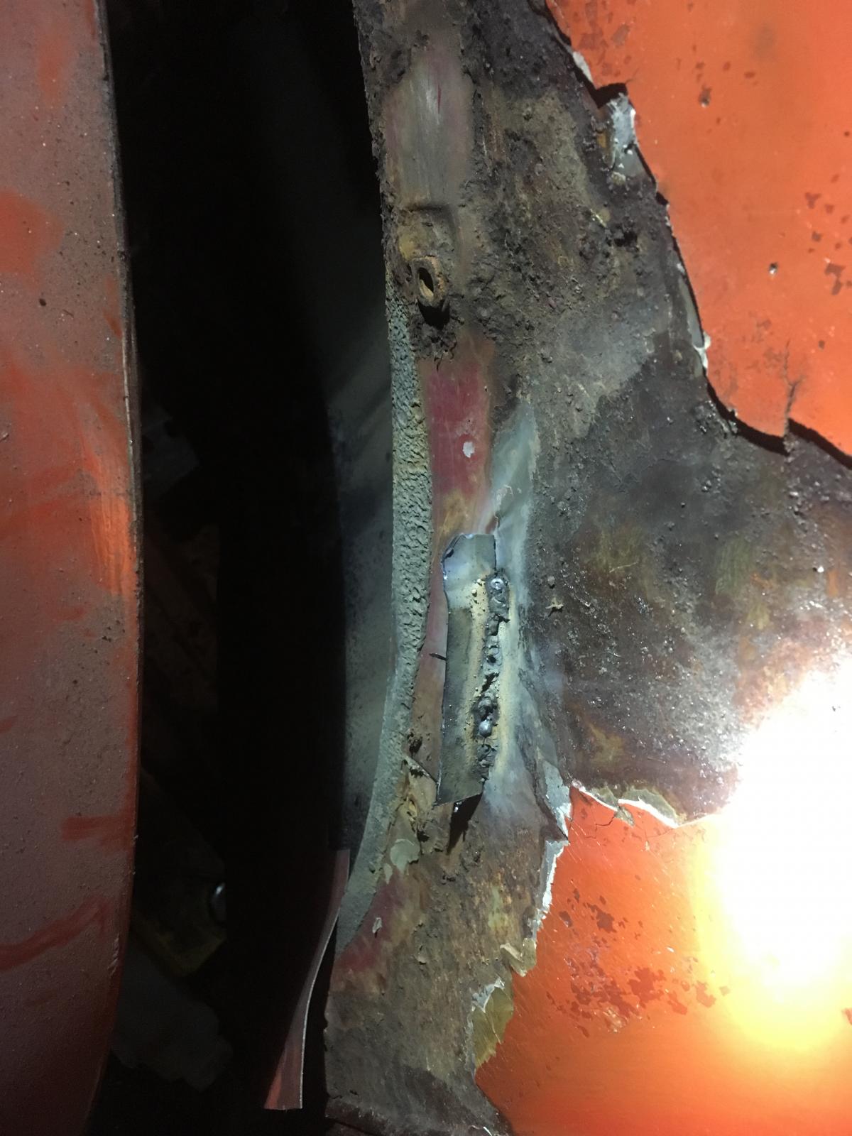

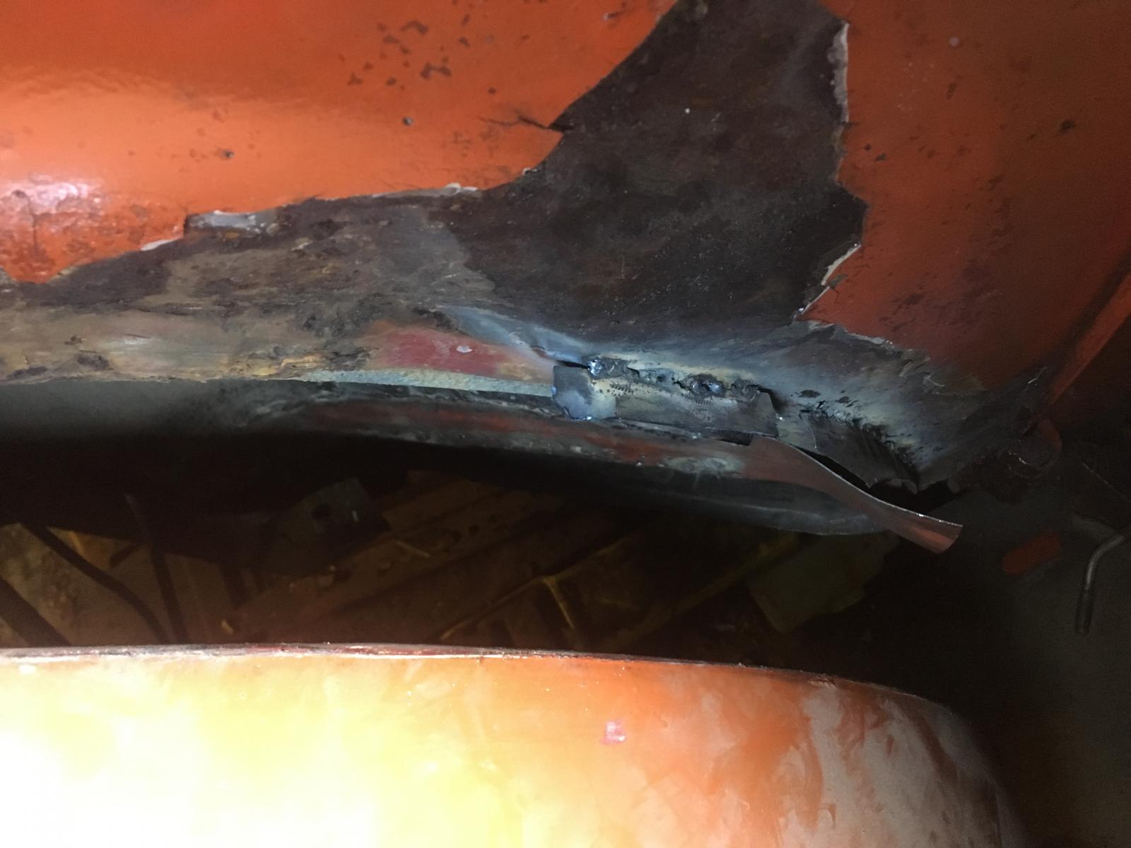

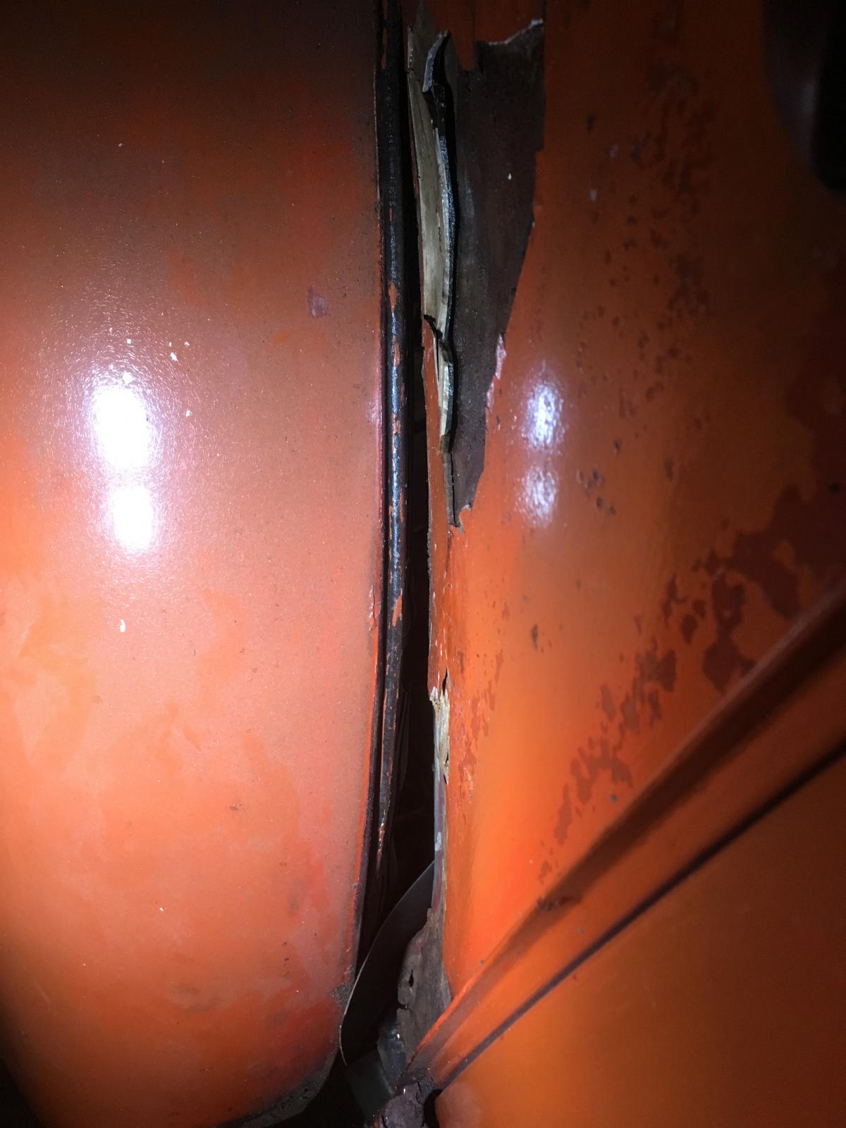

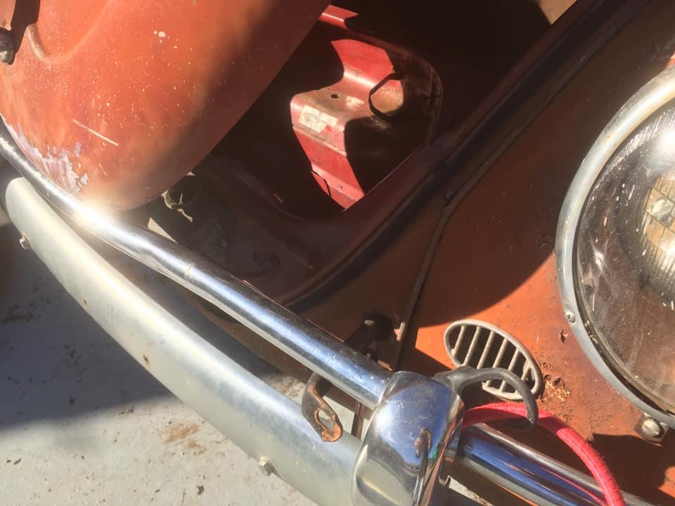

Correcting crease on fender lip and disjointed nose.
Have been looking since Summer for set of fenders to no avail, unless spend about a grand and then have to have a friend ship them from California. Also having hard time finding a frame shop willing unless pay big dollar (many years ago quoted $800 starting price for frame pull for the Squareback). So, must accept have to get this hard crease out of Ruby's front fender and would like to do her nose job too if possible.
Think happened when an illegal hit Ruby's front driver side bumper, disjointing her nose. Thankfully just the nose and not the frame horn, seems didn't even bend the fuel tank support.
Even the inner fender has bent away from the bummer mount.
I have removed dents and straitened an inner fender before (Squareback hit and run not my fault accident), though didn't know the full extent. So where does one begin?
I have a welder and be ordering a Martin hammer and dolly set, Harbor Freight just doesn't feel right.
Thank y'all in advance! Smile
TDCTDI wrote:
The crease near the fender is a result of the impact to the leading edge of the fender being transferred through the compound curve of the fender & flattening of the curved edge of the mating surface where the fender bolts up.
You can get a stud gun & anchor the studs to what was supposed to be the original curved edge & once you pull it back out, you can hammer & dolly the accident induced edge back out. I effectively did the same thing on my car except I welded scrap to the edge since I did not have a stud gun. Once I had a strip tacked on, i used a pair of vice grips adapted to a slide hammer to pull the body line back into shape.

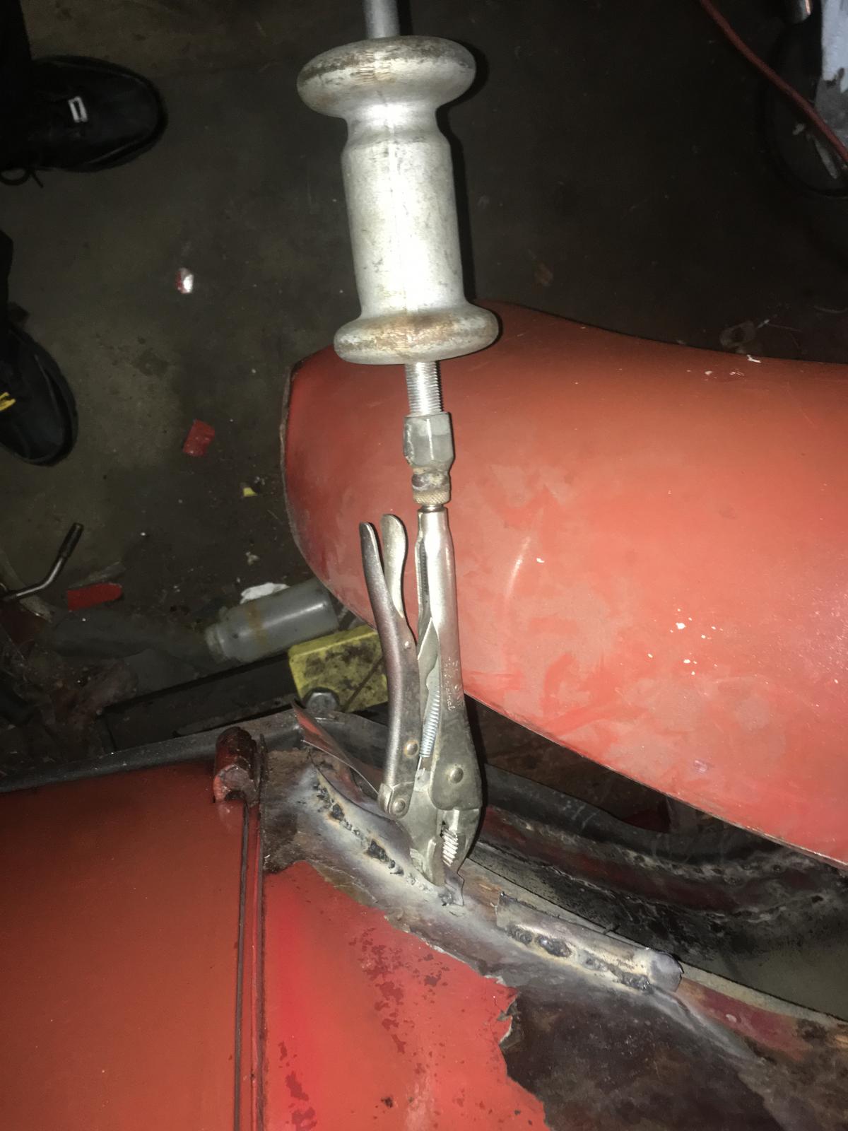

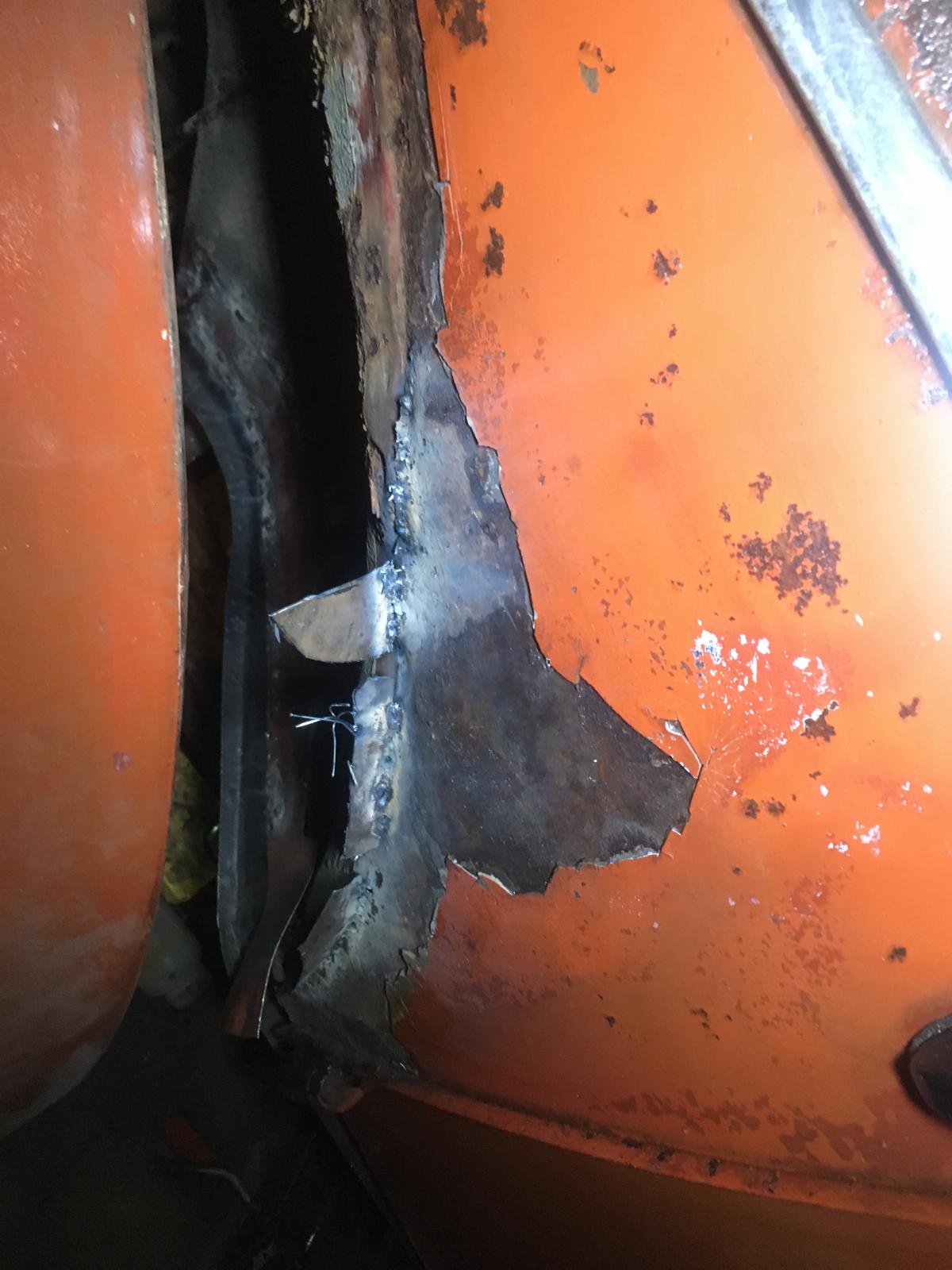

TDCTDI wrote:
Next up was to deal with the one thing keeping me from completing the driver side a pillar, a quarter of an inch to an inch thick plaster job on the front quarter panel.
Not having a stud gun at my disposal, I came up with another plan to pull the panel out.
All of y'all squeamish types, look away now.
I grabbed some excess trimmings & started tacking them to the hard edge (Or what should have been.) where the fender bolts up.
Then I grabbed my handy slide hammer with my self made vise-grip attachment, locked it on & let er rip.
Satisfied with the results, I went on the hunt for more trimmings to attach.
Oh, well, that's enough fun for the day.
TDCTDI wrote:
Depending on the angle of attack, the nose very well could be shifted. Any hit to the front outer edge of a Beetle fender usually transfers to the body line where the rear of the fender attaches to the body which in turn makes a new crease about an inch further out.
You will need to determine the angle of the accident & pull the front in the opposite direction.
Before getting too involved , be sure to inspect the front beam & the pan head to determine if either or both of those were damaged.

PostPosted: Tue Feb 25, 2020 9:40 pm    Post subject: Re: Dad's 1964 Ruby Red Beetle Reply with quote
Got some really fantastic news!
First, Wolfsburg West customer service person decided on his own that Dad's death was extenuating circumstances allow the return of the electrical fuel sender I accidentally thought was the mechanical, despite no returns over 30 days and no returns of anything electrical.
Second, did a rust treatment of the original German tank and the only leak I found was around the outlet! So, seems Rich's once again lied to make extra money and instead of sealing the outlet, replaced the whole damn tank. Poor Dad loathed that tank as the cap doesn't fit right and a fight to get it off and back on.

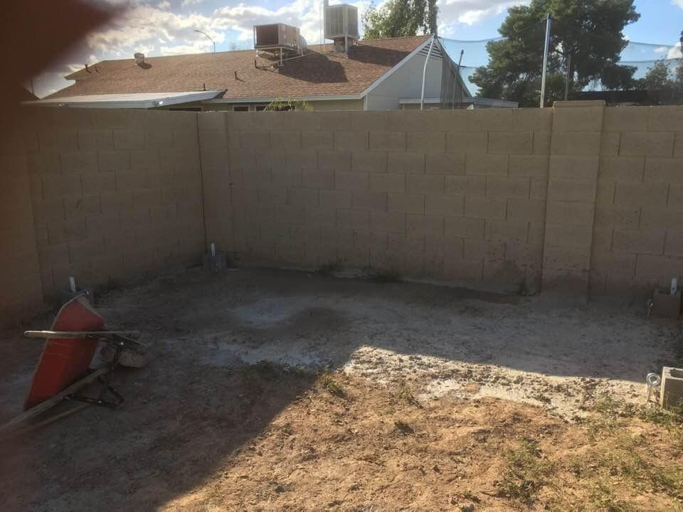

PostPosted: Tue Mar 10, 2020 2:02 pm    Post subject: Re: Dad's 1964 Ruby Red Beetle Reply with quote
Some reason didn’t get notified of the reply.
bad91teg wrote:
dude too funny . I hear ya . Very Happy
I assume mean about bio “mother”? Well, finally gone back to California, wahoo!🕺(Dancing to “Staying Alive.”)
Finally remembered to get a picture...
Somehow ended up with one lump, clueless as raked it all smooth. Oh well, if some reason bothers me can always knock it down. At least not working in the dirt or weeds.

The pad was dug for a foundation last fall, Brother changed the rules and said nothing permanent. Why did a skim coat as can just cover it with soil and doubt look inside. Still haven't seen my neighbor, maybe have to raise the frame myself.
Yesterday and today taken up with the Social Security Supplemental Income hearing, judgement will be in a few months. Also, lots of rain, back was flooded, though means could finally pull the weeds out front.
Wolfsburg somehow switched orders, replacement will be here Thursday at the soonest, so nothing to do inside until comes, hopefully wrong about rain the next two days so can get her front wheels back on the ground.
