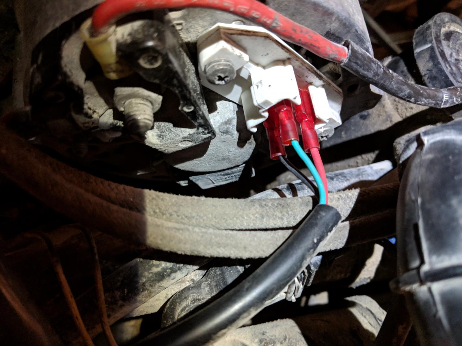

You might consider what you have in the engine compartment.. I assume that it is the stock 1.9 with a stock alternator. If so, you might consider trading out the voltage regulator. Don't go crazy (don't ask how I know), but there sure is a sweet spot that is a ways up from stock, can help all sorts of funk going on in these old beasts. Take a look at the 240turbo.com site for Voltage Regulators. Some say the fixed 14.8 Volt unit is to their liking, and others like the adjustable unit. Not all the much money, and you probably are looking at worn brushes in your present unit anyway.
https://www.prancingmoose.com/AdjustableVoltage.html
You might get closer to a full charge that way.
(See bottom of this post to read what a very smart and respected enthusiast and builder has to say)

14.9 at the Alterator after about 5 minutes since firing up the engine. I've got a couple other locations to look at voltage while underway, so at the dash with a few accessories running, I see a variety of volts. Oh, Cary a handful of spare fuses, as you're going to be replacing some. Just a little consequence I've run across. In my case, seems like the ones I've replaced are due to age.
I do NOT recommend running A higher voltage regulator higher than 14.1v, any higher and you risk burning out components that were never designed to run at higher voltages.
