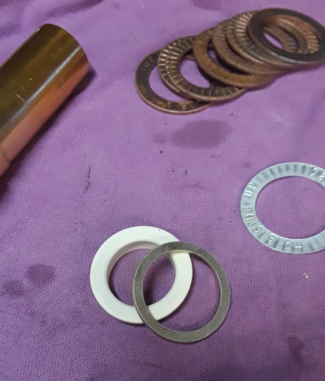

I personally like this style of pushrod tube, only issue I have is the goofy little washer they give you for the spring side seal. I use a single valve spring shim instead, covers the entire seal and is a perfect fit!
Wondering if anyone else does this?

Hello, yea they say the best push rod tubes are the stock ones..
I have run the stock ones in both of my built strokers and in the Bently Manual I think it is they tell you of how long, extended they need to be before inserting and compressing by the heads when building.... Also, best to always use new seals..
But there are a few threads on this topic, for at times there is a call to replace a push rod tube with the engine installed do to some reason.
But in the threads you will find out the best preference or meaning choose by engine bullders for most all the spring loaded push rod tubes leak.
So, in the threads you will find the best one builders have used but it escapes me currently.. But I do like what you said about the ones you found, but make sure I think the best use a silicone rubber O-ring internally, I think, lol... RB

The spring loaded tubes ALWAYS leaks over time, no matter the brand. And yes, with the cheaper sets you need to add a little yourself to get even a decent result. Stock tubes rarely leaks.
On some engines there is no alternative but to use the spring loaded versions. So you have to live with it.
If you need a quick fix of a bent tube or something like that the spring loaded ones are a nice option. On new engines I do not use them if I can make stock ones work.

I have done that using valve spring shims as you show. I have only used stock tubes or JayCee in the last 5 years on my engines though. Just installed another set of JayCee this week. I have never experianced leaks on them. The oldest set from 5 years ago and 30k miles on them still does not leak. I have to warn people though that you should not use so called super cool tins or T3 tins on the cylinders as the tubes will hit and no way to prevent that, it will not allow the PR tube seals to seal, so make sure you check it. You must use stock square plate cylinder tin on most engines when you use them I have found.
You're right about that Oldschool5er I haven't used the type 3 cool tins for a while and they are really close to the tubes. These are original stamped tins so maybe thats why I got lucky on the clearance.

JayCee tubes that use internal "O" rings are the only spring tubes that DO NOT leak. No matter what you do to the spring tubes pictured above that uses a stock seal, they will leak.

funny I dont have leek issues with the scat big mouth tubes leeking .nor the empi big dia springy tubes. I think the issue it the STUPID INSTALLER. I do also make bigger seal back up washers for them and swedge them to the tube so they never come off again.( on the scat big mouth tubes) the scats are soft aluminum so you can swedge them up a bit bigger to snug up to a backup washer.
some of the empi tubes are not round inside....if there not round they need to be machined so they are round.( where the orings ride inside the tube's) you also need to properly oil the orings before assembling with good synthetic oil so it does not cook and the oring's slide for ever as the engine gets wider and smaller. oil the orings and oil good inbetween the orings. ( never use greese it will push out of the way and the orings will then run dry..and die.( you have to be smarter that what your working on,I suppose there is a greese that will work, but...I wouldent do it.greese also attracks and holds shit to eat stuff up.and also seals out oil.)

Any body have any tips for compressing the springs enough to do a good install with them?

Muscle, or some nylon-lined channel locks for electrical connectors.

[quote="chrisflstf"]Any body have any tips for compressing the springs enough to do a good install with them?[/quote ]
A tinny bit of oil on the shaft that the spring rides on to let the seal move a little easier does it for me. And I mean a tinny tinny dab.
