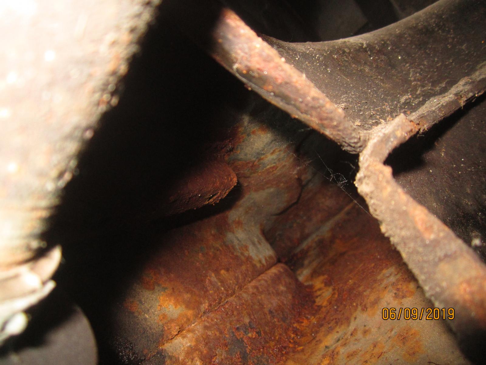

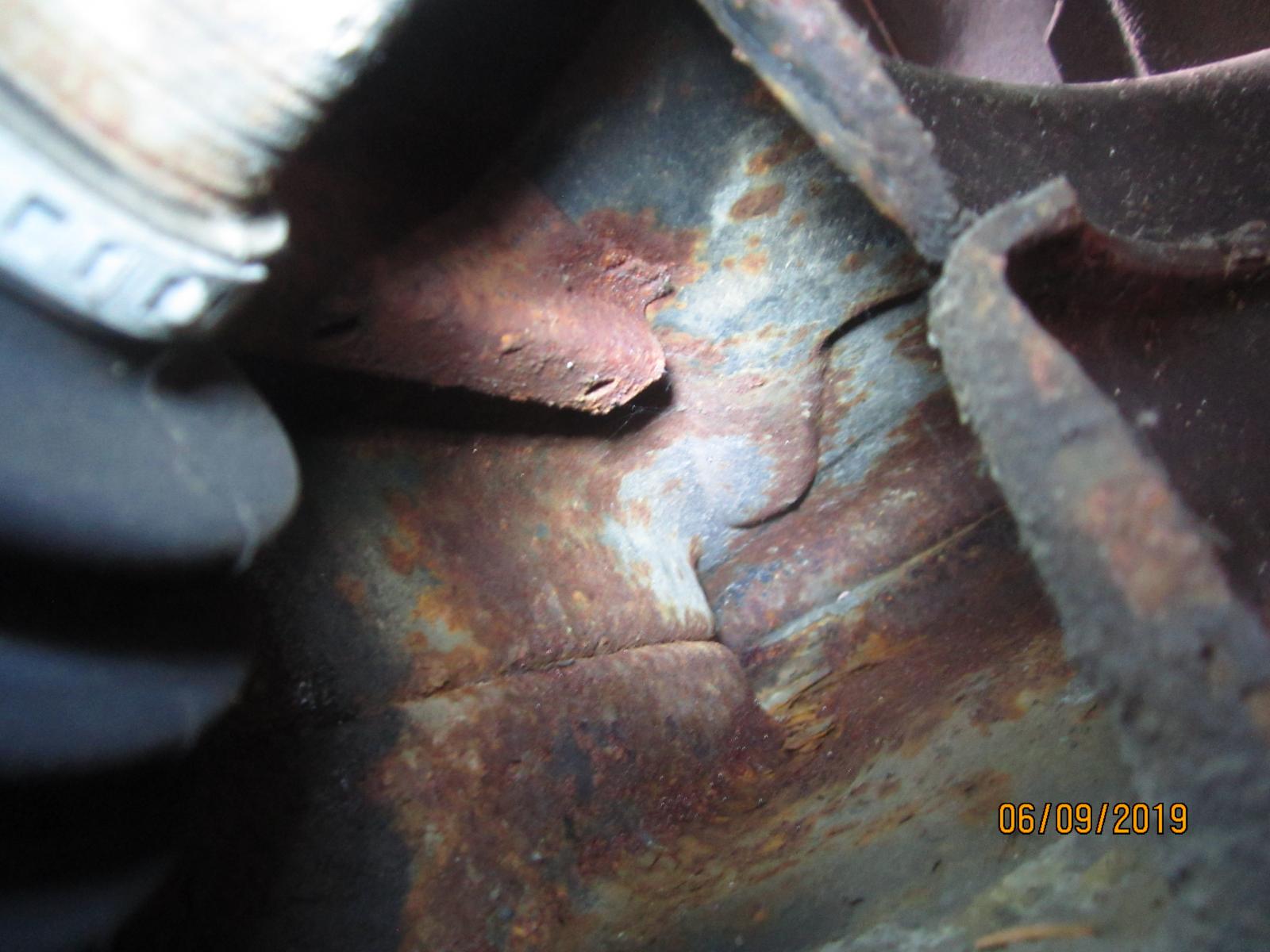

...what I am wondering about is what to do about those rusty trailing arms? Not so rusty as to replace them, but what to do about the rust inside them? ...I guess I can just spray WAX in there once a year... or maybe spray POR15 in there to buy some time?

Abscate Premium Member
Joined: October 05, 2014
Posts: 23731
Location: NYC/Upstate/ROW
Abscate is offline
PostPosted: Sat Sep 07, 2019 4:29 am    Post subject: Re: Hammering on br.drum with axle nut loose? Reply with quote
If the Bus is laid up, take them off and have them dipped, then POR or paint dip and you will get 10 more years out of them

Sorry couldn’t help myself. Most vanagons I come across have completely coated undersides with a combination of engine oil, gear oil, and cv grease. Acts like a rust inhibitor.
djkeev
Joined: September 30, 2007
Posts: 32983
djkeev is offline
PostPosted: Sat Sep 07, 2019 5:19 am    Post subject: Re: Hammering on br.drum with axle nut loose? Reply with quote
Nothing to do with your brake and trailing arm questions, but this photo is one of the best that I've ever seen showing the rubber plug into the body cavity located on either side of the back seat.
I agree with the post above, pull off the trailing arm assemblies and clean them up properly for future rust prevention. Simply drowning them in POR 15 will do little IMHO.
You also want to know if there is enough metal left to be road worthy and not just treat paper thin metal.

shagginwagon83 Premium Member
Joined: February 07, 2016
Posts: 4302
Location: SWVA
shagginwagon83 is offline
PostPosted: Sat Sep 07, 2019 5:52 am    Post subject: Re: Hammering on brake drum with axle nut loose? Reply with quote
I have some rust in the area around those plugs also.
I took my trailing arms off to have them blasted and painted. Oh and I also removed the spring perch just to upgrade/check what was hiding underneath.
After they were done I sprayed quite a bit of fluid film inside the trailing arms. I'll do that every now and then.

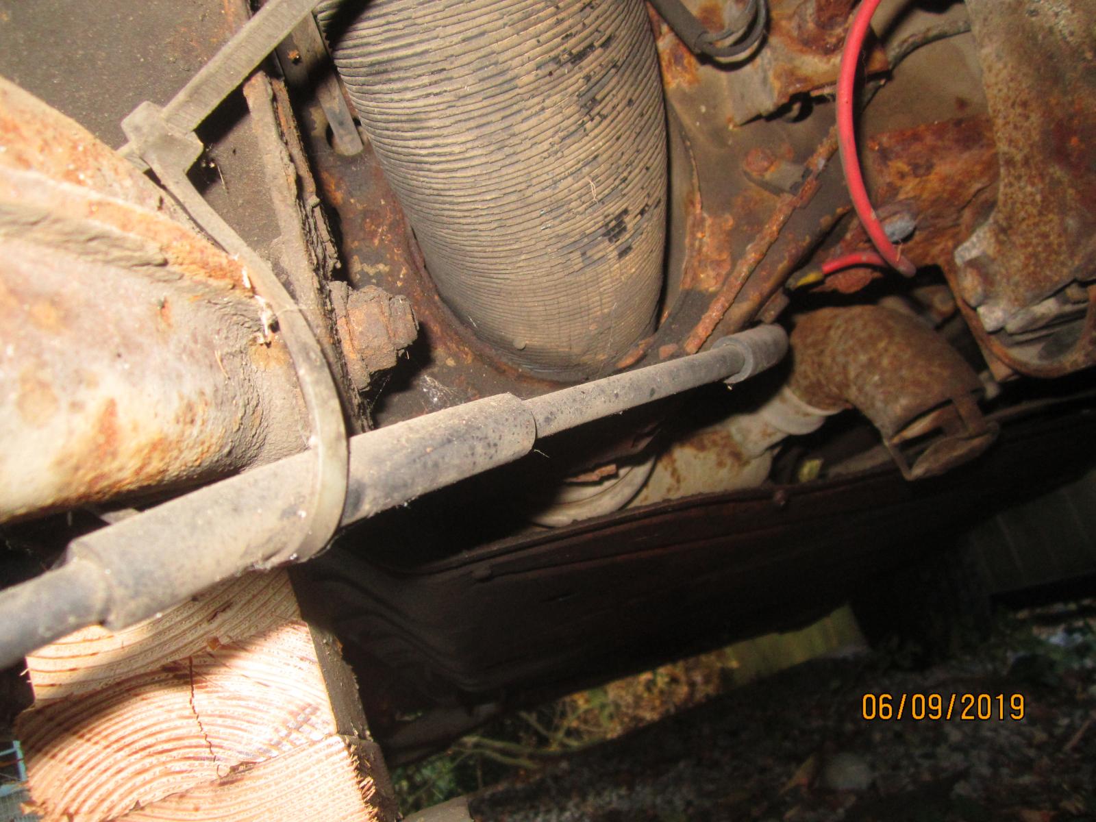

DanHoug
Joined: December 05, 2016
Posts: 5660
Location: Bemidji, MN
DanHoug is offline
PostPosted: Sat Sep 07, 2019 6:37 am    Post subject: Re: Hammering on brake drum with axle nut loose? Reply with quote
the picture with the red 10 ga. wire... that sure as heck looks like it was put in place instead of a battery cable sized ground strap. that must be changed ASAP or you can cause all sorts of strange things when cranking, like burning rear brake flex lines!! clean everything down to shiny metal of course.
you've soaked the brake bleed screw with penetrating oil. make sure you can get that loose before going too far with the brake job. by the looks, you'll need to heat it cherry red to orange to get that one out. replace with a new one of course.
it looks to have had a brake job before and since properly installed springs rarely break or fall off, find original rear brake diagrams posted here on Samba and meticulously follow how everything fits together. don't go by how it was on your van.
coming from MN, all that rust doesn't look too bad! just thought i'd offer a positive comment!

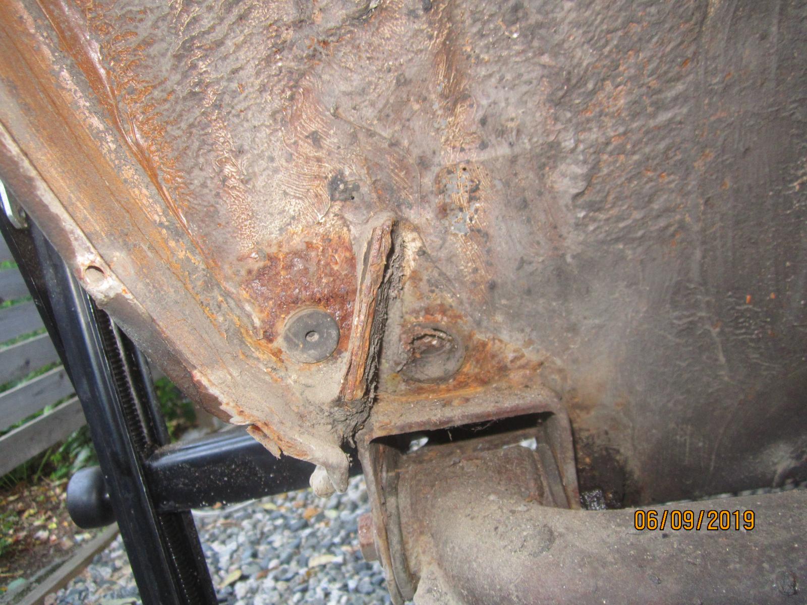

I got the hub off... my question now is what to do with these backing places - inside and out? I want to slow the rust. They are very solid still but covered in surface rust which I want to deal with... I won't be driving this van this year - I just want to protect it > next year I will do the brakes properly.
I am concerned that if I now pull all the hardware off and start scraping off the rust on the inside of the backing plate, it might get a lot of contamination into the bearings.....?? ….so before touching this further I'll wait for feedback.

djkeev
Posts: 32983
djkeev is offline
PostPosted: Sat Sep 07, 2019 1:03 pm    Post subject: Re: Hammering on brake drum with axle nut loose? Reply with quote
You're not driving it?
Removed the entire brake assembly and clean it up off the Van.
The backing plate comes off easily....well except for those rusted bolts! 😂

Jeffrey Lee
Joined: February 04, 2014
Posts: 1520
Location: Wisconsin
Jeffrey Lee is offline
PostPosted: Sat Sep 07, 2019 4:41 pm    Post subject: Re: Hammering on brake drum with axle nut loose? Reply with quote
If you indeed only want to slow the rust, slip a plastic bag over the axle stub and bearing seal with a rubber band to keep debris out, then scrape and wire brush the plates, then spray with Waxoyl or WD-40. Wipe off any excess to avoid contaminating the brake drum & shoes.
If you in fact want to STOP the rust, remove all the brake hardware, remove the plates and have a local shop media blast them for a few bucks, then repaint.
Or, if they're too far gone and it's in the budget, just get new ones:
