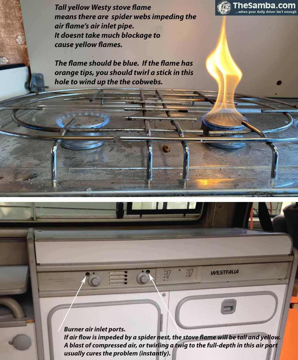

It is, and if you were using it in the enclosed vehicle it would also present a real safety problem. Correct flame color, as you surmised, is blue with flecks of yellow/orange at the tip; anything else indicates incorrect fuel/air mix and will produce carbon monoxide in pretty high concentrations. Get it corrected if you plan on using it. I'm not familiar with the construction of the Westy stove, but most gas burners have some kind of air mixing tube where the fuel jet is. Check that whatever kind of air tube there is isn't blocked by dust, spider webs, and kind of debris. Blow it out with compressed air if necessary. Often there will be some kind of adjustment to the quantity of air that can be drawn in by the heat of combustion. You can adjust this if needed to get the correct color of flame. If in doubt, by all means visit a propane dealer and ask them to check and adjust the mixing tube for you. Soot isn't the only problem that this causes.

Old thread, but for the sake of posterity I blew my stove tube out with compressed air and it solved a yellow flame symptom.

This post's very searchable title probably needs this SAMBA Public Service Announcement image too.
