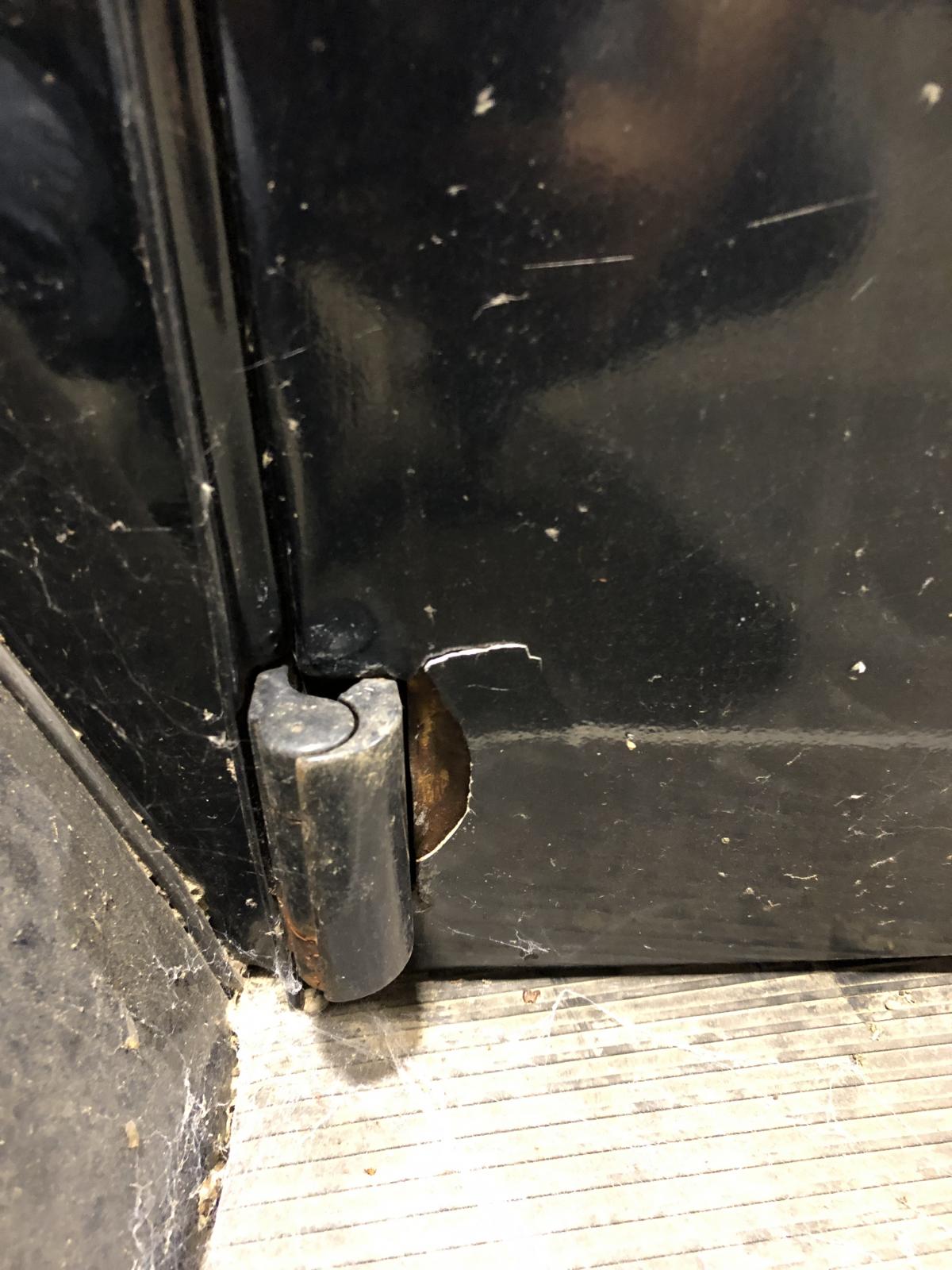

Just bought a 1965 Beetle. It had been restored sometime in the past and then sat in someone’s barn for a while. It seems like it has solid bones with not much rust at all. Unfortunately it has two small spots where bondo is flaking up Embarassed Needs brakes and some electrical work before it’s roadworthy. It starts and drives as is but won’t stop and not all of the lights work. Planning on fixing it up and using it as my daily driver at college this year. Here’s some pictures.

You will need to fix all the lower rust thru spots to keep more water from being pumped thru those in the rainy/slushy weather.

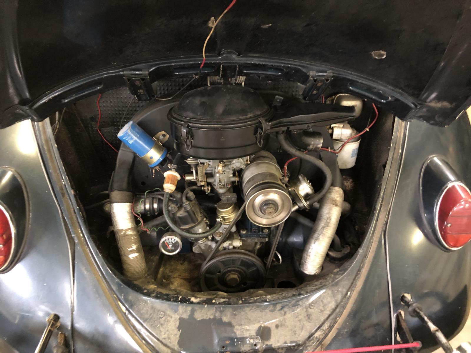

Pretty good looking start there. Some rust repair, but nothing too scary looking (yet). I bet that paint will buff out pretty nice.
What's the dashpot on the throttle arm?

https://www.thesamba.com/vw/forum/viewtopic.php?t=576068&highlight=dashpot

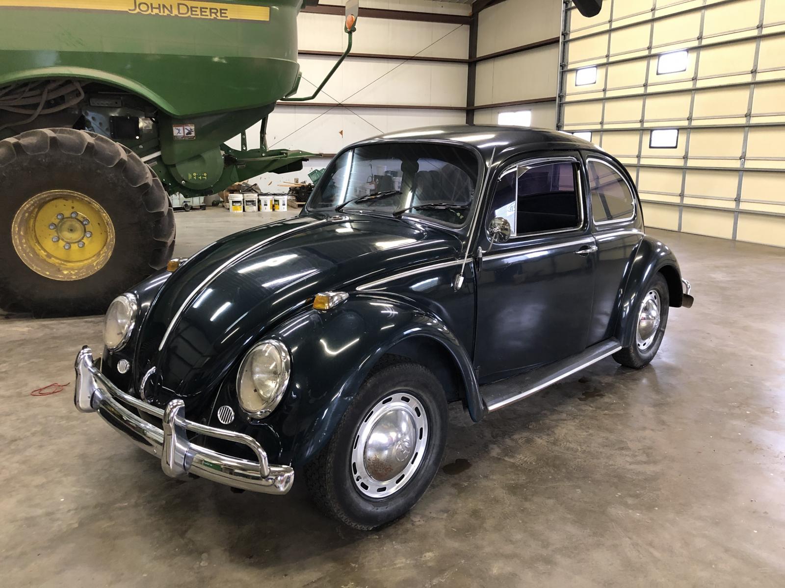

That cleaned up nice!

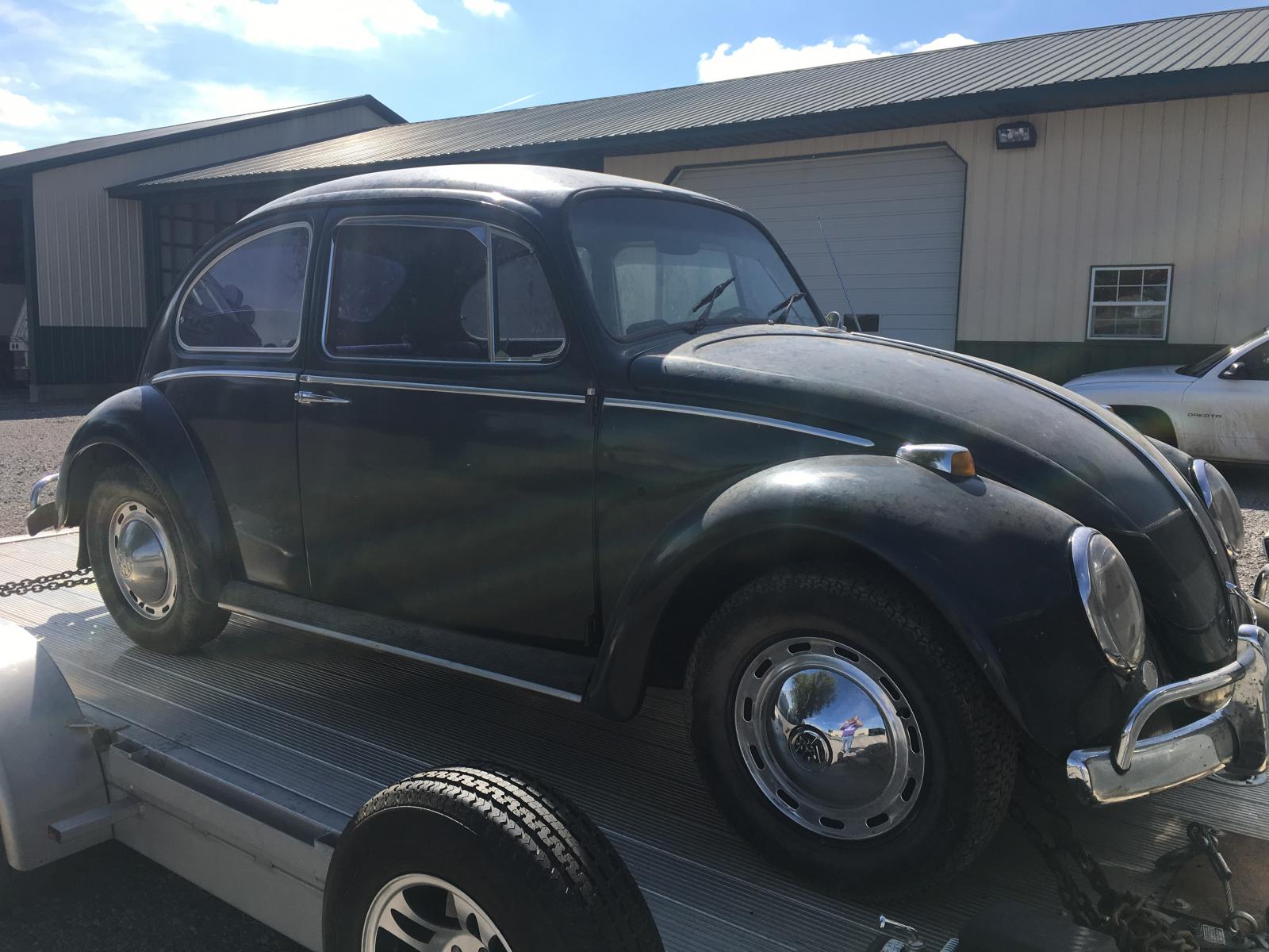

Dude, you sure have a gigantic garage!

Pulled the engine and tires and wheels off. Next step is new tires and cleaning up the engine, repainting the engine tins and replacing the aftermarket oil cooler they had above the transmission with a stock one.

Be careful when you clean your engine compartment side and front sound insulation. They appear to be the original factory-installed panels with the outward bumps. Best of my knowledge that specific style is not reproduced. If you go about the cleaning aggessively such as pressure wash or garden hose spray, degreaser, scrub brush; it's likely that the top layer of impregnated paper will fall apart.
I suggest placing either a tarp or a large collecting tray under the engine compartment. Use a spray bottle with 50/50 diluted SimpleGreen to spray a mist onto one of the panels at a time. Let the sprayed liquid drip down, carrying surface dirt off.
Dab a sponge into the same cleaner mix and press it directly onto the surface. Do not wipe the sponge, because the lateral movement of the sponge could start to scrape off the panel top layer if it is already marginal.
Clean off the panel with clean water without any cleanser/degreaser, then either let it air dry, or spray it from a distance with compressed air. Assess the cleanliness once the panel is dry, and consider repeating if needed. You can try a soft-bristled kitchen scrub brush on the firewall panel directly above the transmission hump. In case that panel material is starting to degrade, just stop the scrubbing. It'll be hidden from plain sight by the fan shroud.

Should I be worried that the engine insulation might break off and clog up the fan?

Your insulation appears to be solid in the photos you posted. You'll be able to feel the integrity once you have the engine out. I've seen original insulation still appear to be uncracked and not peeling, but it had loosened from one or more of the fastening spikes so that it could be pulled rearward towards the engine's fan intake on the fan shroud once the engine was running. This reduced the amount of cooling air coming into the fan, ultimately leading to a hot engine.

What if you put one of those cage guard things on the fan like they use on dune buggies? Then if the tarboard did come loose it wouldn't get into the fan.

Or run SS safety wire from hook to hook, just in front of the fan opening.

That sir is one good looking ride.
Love the stance and the colour.
What colour is it?

It is a dark metallic blue. I’m not sure on the actual paint code or anything as it was repainted 20 or 30 years ago. I can get some close up pictures of the paint after I polish it. I’m betting that it will look a lot better after a compound and polish.

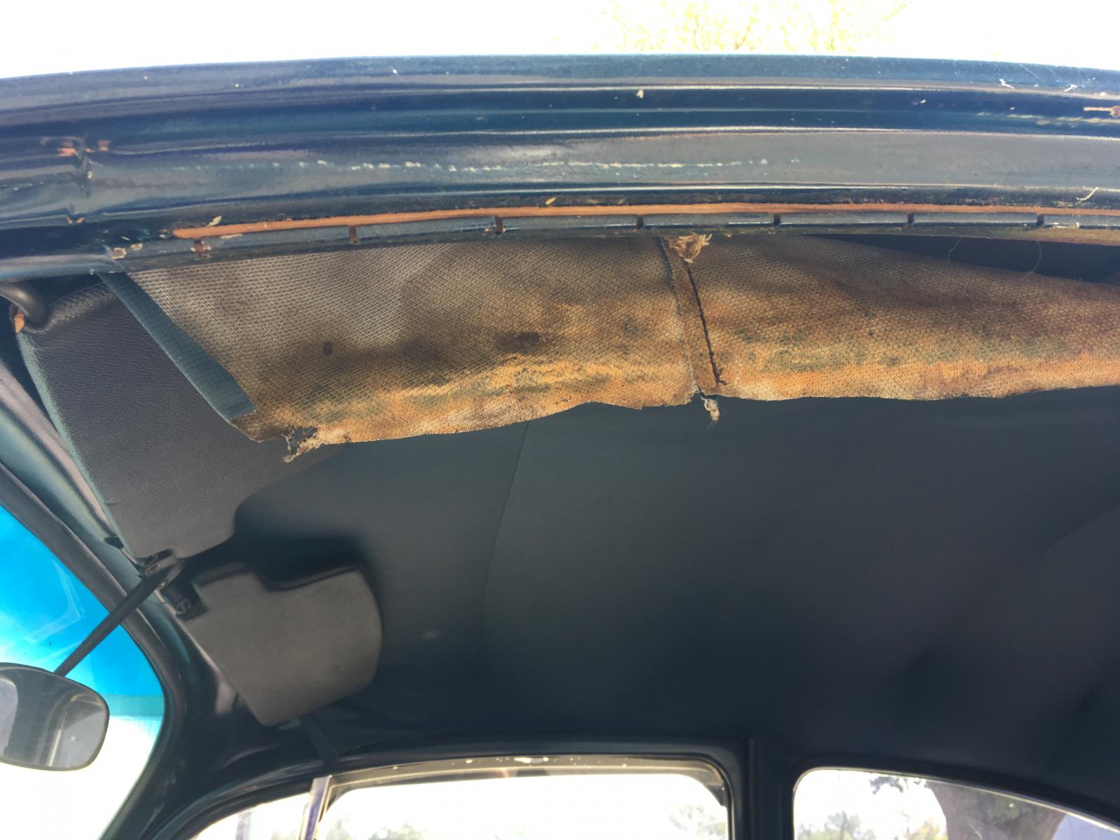

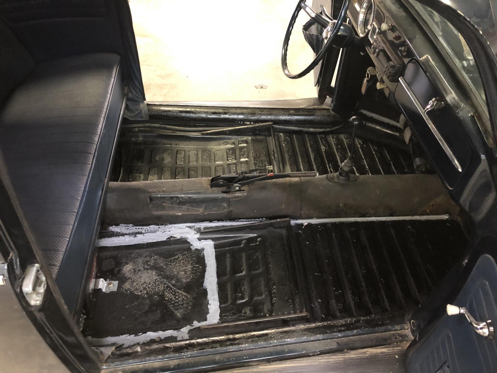

I’ve been home for a week from Christmas break and have been getting a lot of work done! Got my first 4.0 this semester at K-State so that is exciting. I started by adjusting the rear down an inch so it is just a half inch above stock. It sits level now. Did a compound and polish with a DA polisher and then waxed it.
Pulled the rest of the stock tar board out and wire brushed the rust a little bit and then applied some POR 15.for now I am leaving the patch that the PO has under the battery. It is sturdy but not pretty. Put in a new fuel tank from WW.
