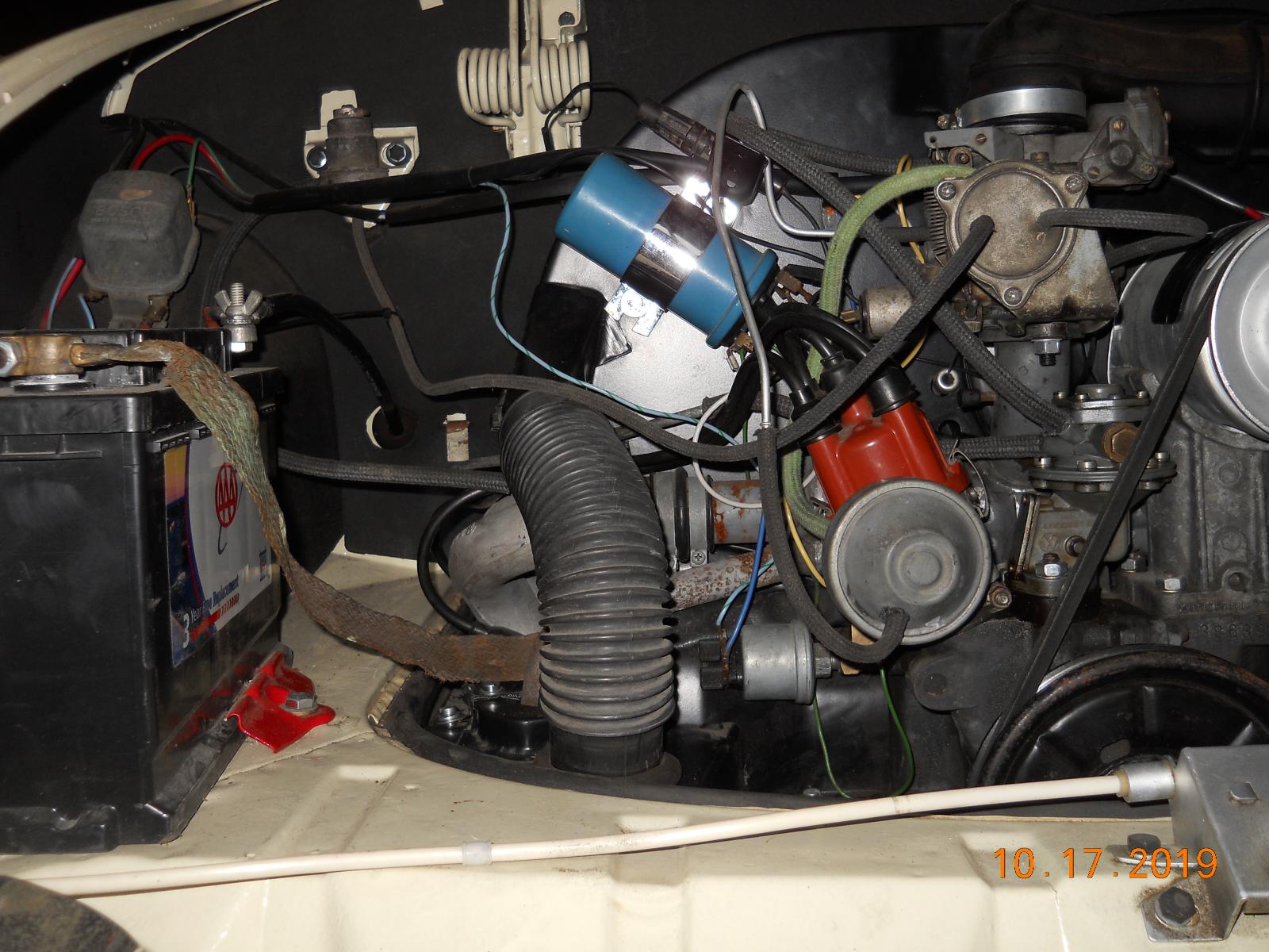

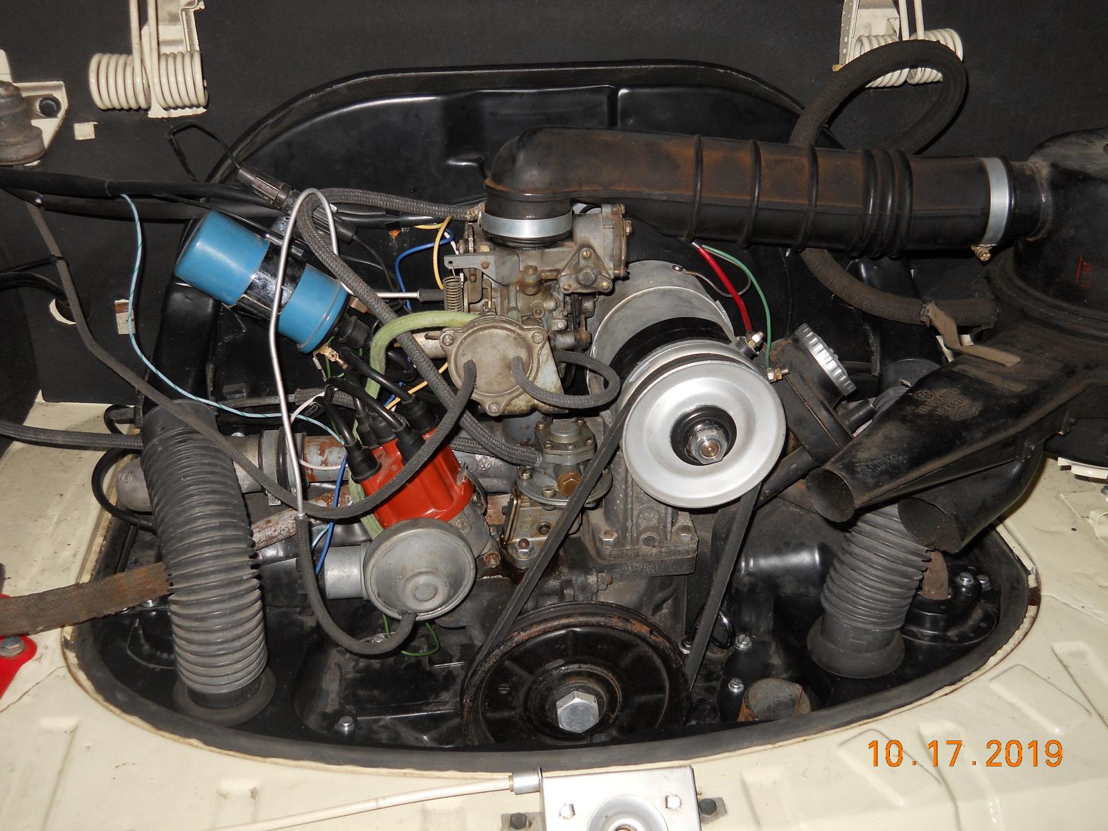

I have the 113905205AN Distributor. Here's a few photos of the engine.
I also have 2 spare Distributors that are different & I do not have any idea if they are good or not. Spares are 113905205AH & 043905205.

Is that also an altitude compensation device on the firewall (or was it a line for the AS?). Either way is it introducing complexity into your timing?
Try a little mouth suction on the line to the canister to see if you get movement on the advance internal to the distributor (with the cap off). That will let you know if the diaphragm has integrity.
Also for static I totally missed the part where you're not supposed to leave the key on too long. Thus I wrenched the pully, contacts closed, let it sit for 5 mins working on stuff, fried a bunch of stuff. If you have traditional points there is a way to use a test light on the #1 off the coil to set static. I also struggled with dwell setting vs. the points gap. Eventually I threw up my hands and got a Compufire point replacement which takes all that away and have never been happier.

Also - go through your Coil wiring again. The pic shows multiple wires coming off the coil points...unless you have the test plug wired in #1 should only go to the condenser.
https://www.thesamba.com/vw/archives/info/wiring/ghia_8_70.jpg

Since I'm on a roll you'll eventually need to put a hose on that crankcase fitting near the oil-fill area (It recycles air back into the air filter). Under that air filter you have an open pipe that goes to the engine tin pipe. They are both open in your picture. In theory that pulls warm air from the engine tin (near the thermostat under the engine) through a fitting called a stovepipe to get to temp faster.

That AN distributor is a good one. It's very similar to the 113905205AJ.
Keep that 043905205 distributor. It is good as well. You could probably use the AH one but it wouldn't be as good as the others.
You can static time any of them with points. That's good enough to get the engine started but you really have to dial it in with a light.

The 205AN is the same distributor mechanically as the 205AJ they just have a different vacuum advance range. The AJ is around 10-12* and the AN is 8ish. The 205AN will work fine in your application if it's in good shape and the vacuum canister is good.

Overall, your engine looks great. Very original with the correct German Pierburg fuel pump and the throttle position-er in place. BTW, does the throttle position-er work? I run them on my stock engines because I'm a purist. Plus, they are just cool to see them work. Wink
Let us know how it goes after you test the vacuum canister. Glad to help.

I searched the gallery for Altitude compensation, yes that is what it appears to be. So I learned another part!! Now my memory retention is not great, so hopefully I'll remember tomorrow! Confused
I tried the mouth suction. The black hose that attach at each end are so old that they leak terribly. I used a piece of Aquarium tubing to test it and the vacuum moves the distributor well. So I take it the canister seems fine on the advance side. I'll replace the black hose. While I'm at it I should probably replace all of it even from the Throttle positioner as well right? Is there any particular brand or type that I should buy? or just get what ever is available at an auto parts store?
How do I check the retard side? Or is that even the next step?

Also - go through your Coil wiring again. The pic shows multiple wires coming off the coil points...unless you have the test plug wired in #1 should only go to the condenser,
My Dash has extra gauges installed. You'll notice that I have 5 guages, not 3. the dash actually is from a 1962. The standard speedometer, Tach, Oil Temp, Oil Pressure, and Gas. All VDO. Long story about this.
I suspect the extra wire on the coil might be for the Oil Pressure?? Would that make sense? It's a really pretty Dash. Now if only the outside restoration looked as good as that Dash!

PostPosted: Thu Oct 17, 2019 2:22 pm    Post subject: Re: Timing question Reply with quote
Yes, I need to get on that as well. These are just a few of the items that the seller neglected to provide and did not advise me of.

PostPosted: Thu Oct 17, 2019 3:05 pm    Post subject: Re: Timing question Reply with quote
Is the 205AN correct for a 1971?
[quote="wcfvw69"Keep in mind that any original, 50 year old distributor should be disassembled, inspected, cleaned and lubricated. The factory grease is long gone and you're wearing metal on metal. In most cases, the two fiber washers are broken and gone, especially the lower one near the drive dog.[/quote]
Thank you. I will plan to rebuild the distributor, fuel pump, and carb during the winter. Thanks so much for that advice.
As I posted a bit ago, I tried mouth suction on the advance side and it seems to be working but the hoses are dry and hard and leak terrible. I need to replace them. I am going to get a hand vacuum pump asap.
The fuel pump has a very small leak somewhere. Just enough to leave the base slightly wet but not enough to drip anywhere. It will get a good overhaul this winter.
Should I bypass the altitude compensation device for now? Until I get everything else worked out? If so, do I just disconnect the hose to the intake and plug both?
Marc

PostPosted: Thu Oct 17, 2019 3:17 pm    Post subject: Re: Timing question Reply with quote
Marcdeb wrote:
Very nice dash!
The oil pressure gauge gets its signal from the dual pole accessory sender that is in place of the original sender. (Big round thing with blue wires going to it) The wire to coil, probably tach.

PostPosted: Thu Oct 17, 2019 3:54 pm    Post subject: Re: Timing question Reply with quote
Marcdeb wrote:
Should I bypass the altitude compensation device for now? Until I get everything else worked out? If so, do I just disconnect the hose to the intake and plug both?[/quote]
The 205AN was for 1972 and 1973 manual transmission bugs/Ghias. The 205AJ was for 1971.
The mouth suction test will show you the vacuum can will hold some vacuum and you can see if the distributor pivot plate moves. Only a hand vacuum pump will tell you if the vacuum canister leaks or not. I won't use any vacuum canister that leaks, even a tiny amount. That leak demonstrates it's on the cusp of complete failure. You hook up the hand vacuum pump to the back side tube of the vacuum canister and pump it up to check it. It should also not leak. If it won't hold any vacuum, the diaphragm is blown.
Wolfsburg West sells all the correct metric diameter German braided vacuum and fuel lines. I'd replace the all the fuel hoses and vacuum hoses. Do this to the throttle position-er and altitude position-er. Then, can you test the altitude/throttle position-er to see if it works. There's plenty of threads that show you how to test/adjust it. It's also covered in the service manual.
Yes, rebuild that original fuel pump vs. replacing it with a much lower quality "new" fuel pump.
The Samba member since 2004.

PostPosted: Thu Oct 17, 2019 5:17 pm    Post subject: Re: Timing question Reply with quote
I meant to share this in my other post. This one piece throttle positioner and altitude corrector was used on 1968-1970 VW's. I restored this one on my 69 bug. The video shows it working correctly.
When I've taken this bug to local VW shows, so many people ask "what is that thing on the carb". Laughing So many of these early smog devices were pitched in the dumpster after their VW didn't need to pass smog any longer. Old time VW owners or mechanics know what they are and smile when they see it in place, hooked up and working.
Most of my VW friends have functioning throttle positioners on their stock engines as well.

PostPosted: Fri Oct 18, 2019 8:08 am    Post subject: Re: Timing question Reply with quote
I'd bet the leak on that Pierburg is from the top square plate. You can see that it is bowed up in the middle between bolts. That happens when someone overtightens it. Mine was the same way, and I read somewhere in these forums that you can use a couple of adjustable wrenches to gently "form" the ears back up so that the bottom of the plate is flat. I was a little scared to try it, thinking for sure the ears would just snap off. But, surprisingly, the plate turned out to be pretty soft and malleable. Cured my leak, after a rebuild did not.
