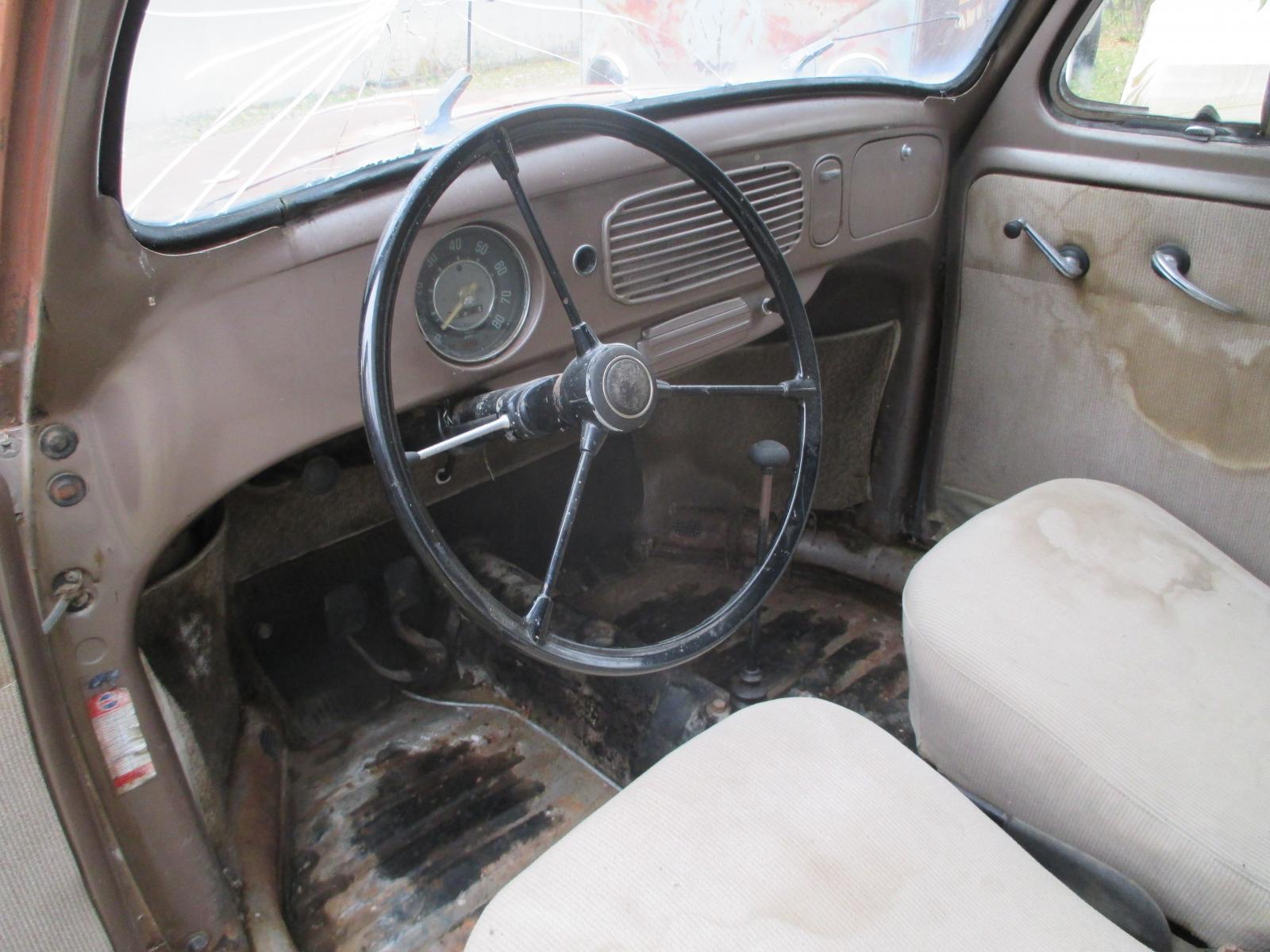

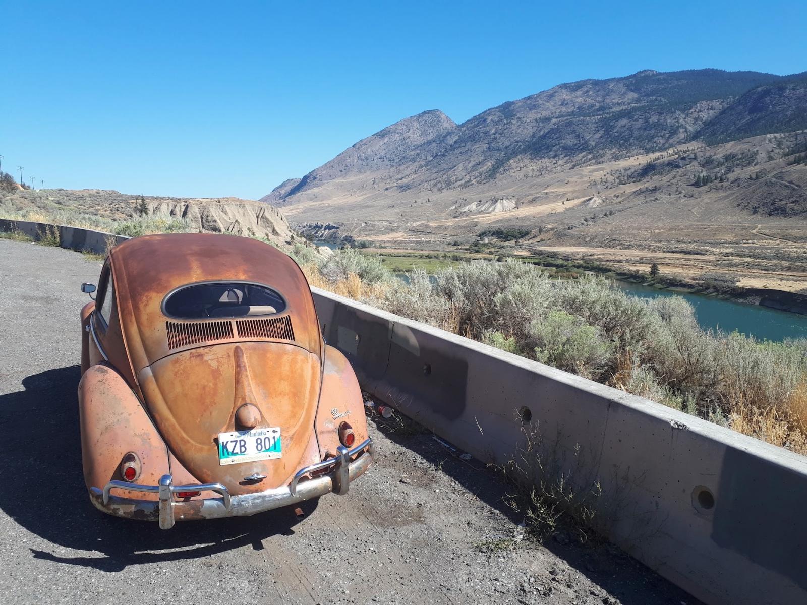

Bought this car with a friend 11 years ago and it is finally time to tear into it. It is amazingly original and solid for a car that has sat outside since 1978. Two major problems I am going to have to deal with are seized solid door hinges and a dented roof. As well the decklid hinges are both broken.

So my '54 has 3 serious problems to sort out.
1: the passenger door hinges are seized solid, they do not budge. I'll be looking for suggestions how to fix that
2: The decklid hinges are both seized and broken
3: the choke cable is seized. At the engine end the outer looks rust free but there must be some rusted part. I'll pull the gas tank in the next couple of days and see how the cable looks in the front. I'm hoping it will slide out of the chassis but not putting any money on it.

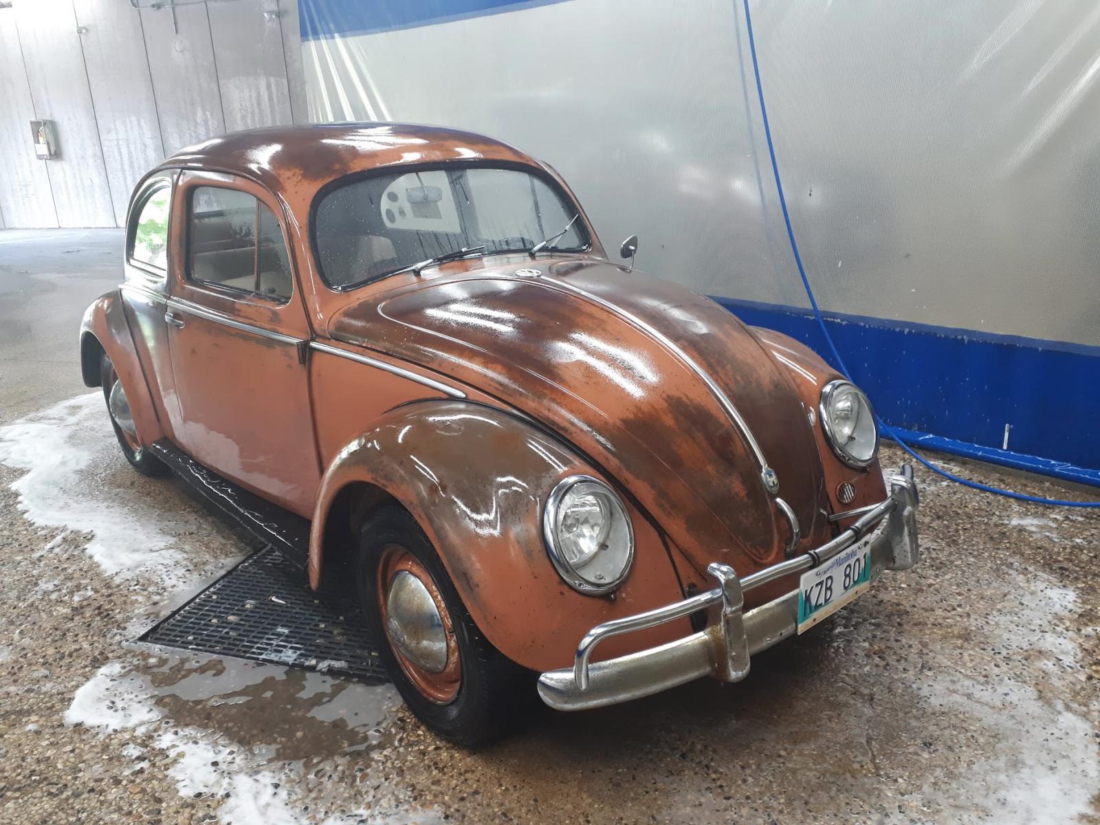

BTW ultramaroon in all its glory:

You should expect the choke cable not to cooperate. It is a steel cable in a steel wound sheath inside a steel guide tube and is likely rusted solid. Get up to the front once you get the tank out and start dribbling Kroil down the tube. Give it a year of this before using much force. Ultimately you will probably get the center wire out of the sheath, but the sheath may still be frozen inside the guide tube. You may need to run a new guide tube along the side of the tunnel inside the passenger compartment under the mat/carpet unless you want to cut access holes in the tunnel and install a new guide tube.
On the hinges, heat them up with a torch and get some penetrant in there. Do not use force to try to get the hinges moving--the rust is stronger than the hinge in some cases and you will bend the hinges or the door. Would be better to borrow/rent a hinge pin press and press the hinge pins out in place after using heat. Then you can get the doors off, ream the hinges and either reinstall the pins or install new pins, or install mirror pins.
On the decklid, no suggestions if the engine is still in the car. If not, you could get under and unbolt from beneath to get the decklid off. Then again use the heat/penetrant approach until you can free the hinges.

Major Woody has it to a TEEon the hinges. Heat and penetrant, several times over, then the press. Repeat several times before attempting any force. It will give in in the end.

It is amazing the way this car is coming apart. I took the gas tank out and tugged on the choke cable, a little force and then it slid right out. Once it was on the bench the inner came free and went back and forth no problem. On the problem of the hinges, I have bought the hinge pin tool
https://www.thesamba.com/vw/classifieds/detail.php?id=2252365
so I am stoked to see how it will work. I will have to drill the screws out tho, they are stuck solid. I have done this before and it works nicely. Once the hinges are off the screws turn out easily. I tried heat and an impact driver and managed to get 2 out but the rest are not moving. Pictures tonight.

That's awesome Don! I just removed the choke cable from my Black 57' oval...came out just like yours. Also removed one from the donor car, came out even easier. It's the little things in life... Laughing
Have you tried an impact driver on your door screws before drilling them out? I soak the crap out of them from underneath the hood. Let them sit for a few days ...I soak them a few times during that. Then I hit them with a little heat on the screw head before smacking them with the impact driver. Sometimes it works, sometimes it doesn't.
