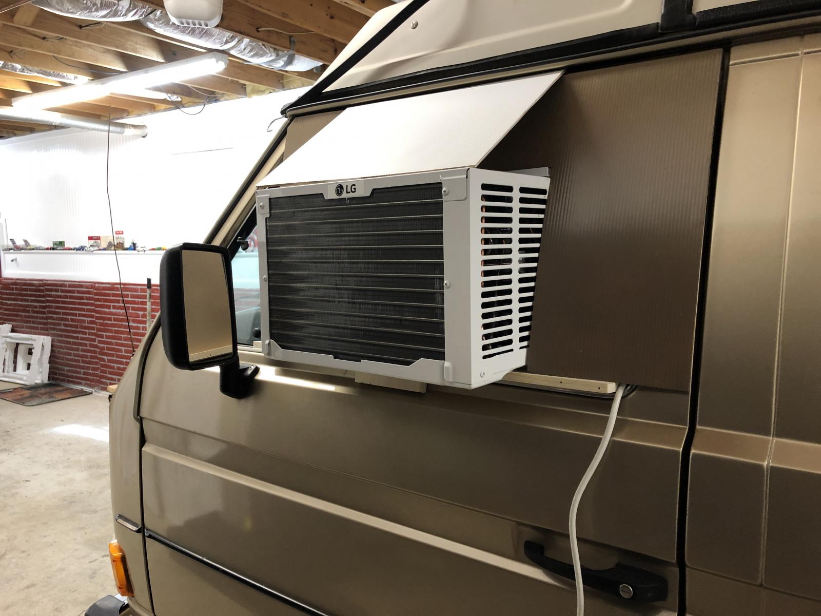

I started working on a camp site solution for air conditioning last week. Moved it to driver's side since most camp site's have shore power on that side. Corrugated plastic board painted brown, wooden board with brackets where the front feet of the a/c unit will be bolted to. plastic board held on to the exterior with magnets. Still have to make the weather shield (top white piece in the pic) fit, and work on the interior side, but making progress!

Much cleaner than the way I did it. But what keeps it from tipping back?

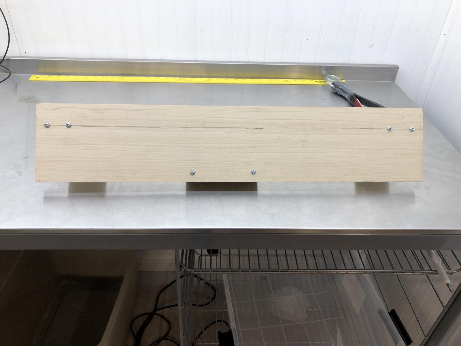

I can share with you what materials I've used so far, and what I'd do different.
Materials
5"X.5"X36" poplar board
36"X24"X4MM corrugated plastic board
neodymium disc magnets
I cut the wooden board to 28" to fit the window. Using the scrap pieces I cut three more pieces, two long, one narrow that are screwed into the 28" board. The whole assembly fits the windows sill as a saddle.
The A/C unit's front feet will be drilled as will the wooden board so the two can be attached/detached as needed.

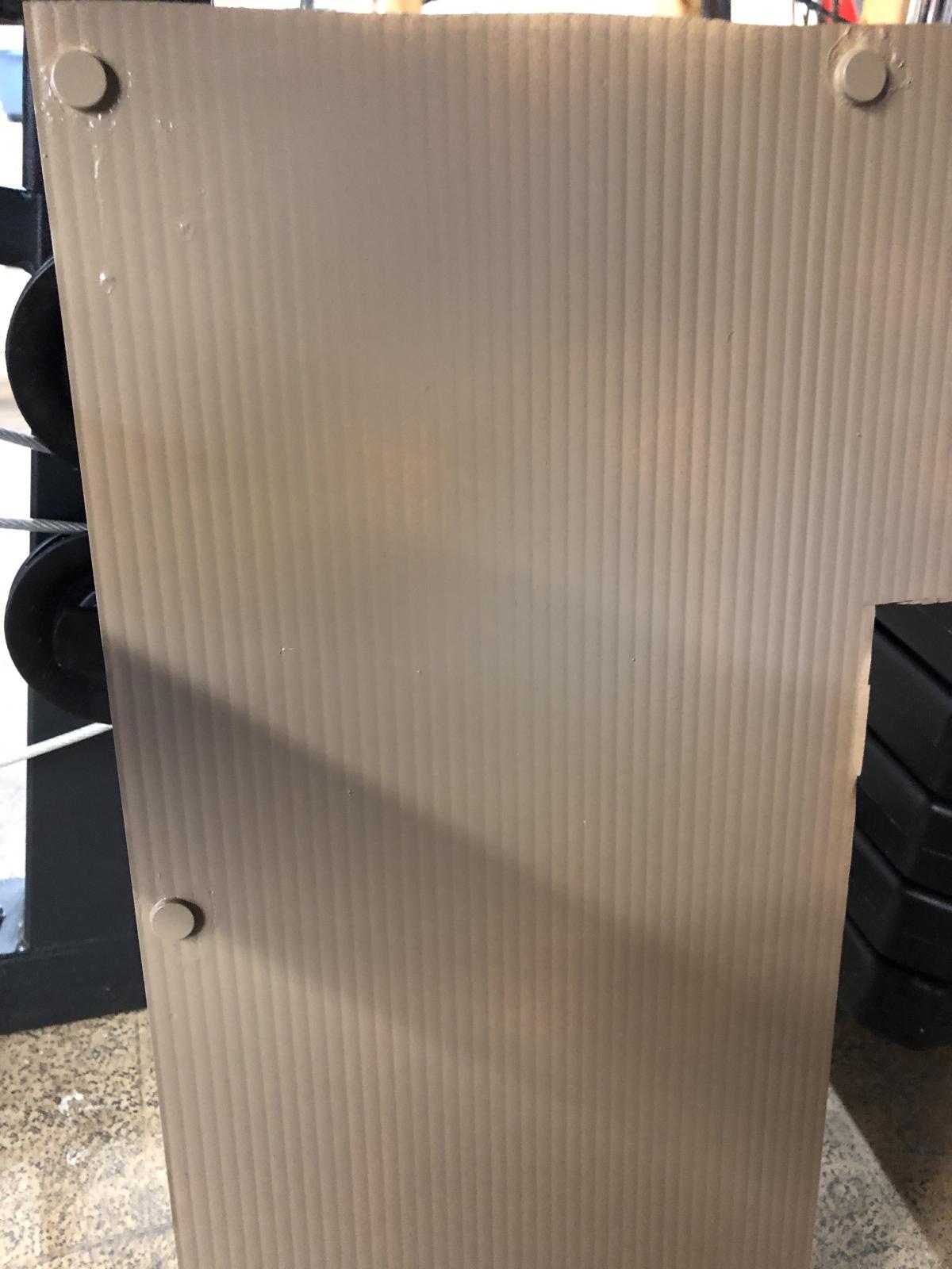

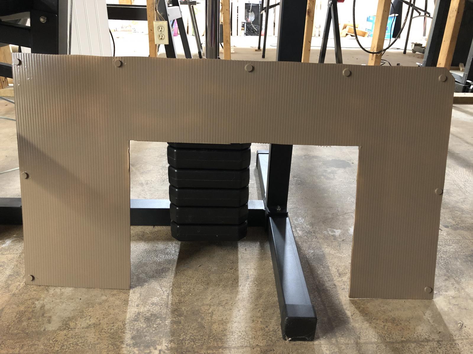

The size corrugated plastic board I used is too short for the one piece to fit from rear door edge to tip of vent window. Instead I cut the piece to fit from vertical vent window post to rear door edge, and then trimmed to fit from top of wooden board to top door edge. A notch is cut in one top corner to match the angle of the front door edge.
I measured the height and width of the A/C unit and cut a section out of the corrugated plastic board so it fits around the unit. I messed up the cuts and didn't get them as snug as I'd like. I'll probably have to use some kind of foam gaskets to make it seal. I used the cut out piece as a lean-to to cover the top of the exposed A/C unit. This can be held on with smaller disc magnets.
With the corrugated plastic board cut I superglued the magnets around the perimeter so it attaches to the exterior door and vertical vent window support.

I wanted to share a follow up for this setup. I took it camping off-grid. The a/c unit and generator combo worked great! It was 89 degrees at the camp site and this cooled off the interior of the Westy as I had hoped it would, even after being heat soaked.
The problem was with rain. A 2 hour downpour happened a couple of hours after setting up camp. The a/c unit and generator were fine in the rain, but the corrugated plastic surround around the a/c unit allowed way too much water intrusion, and there was nothing that was going to stop it.
I've got some waterproof nylon cloth that I'm going to use from now on, and attach it to the vehicle with magnets. That was the other failure, the magnets that were glued to the plastic board started coming off. That was with using Gorillia's version of super glue.
