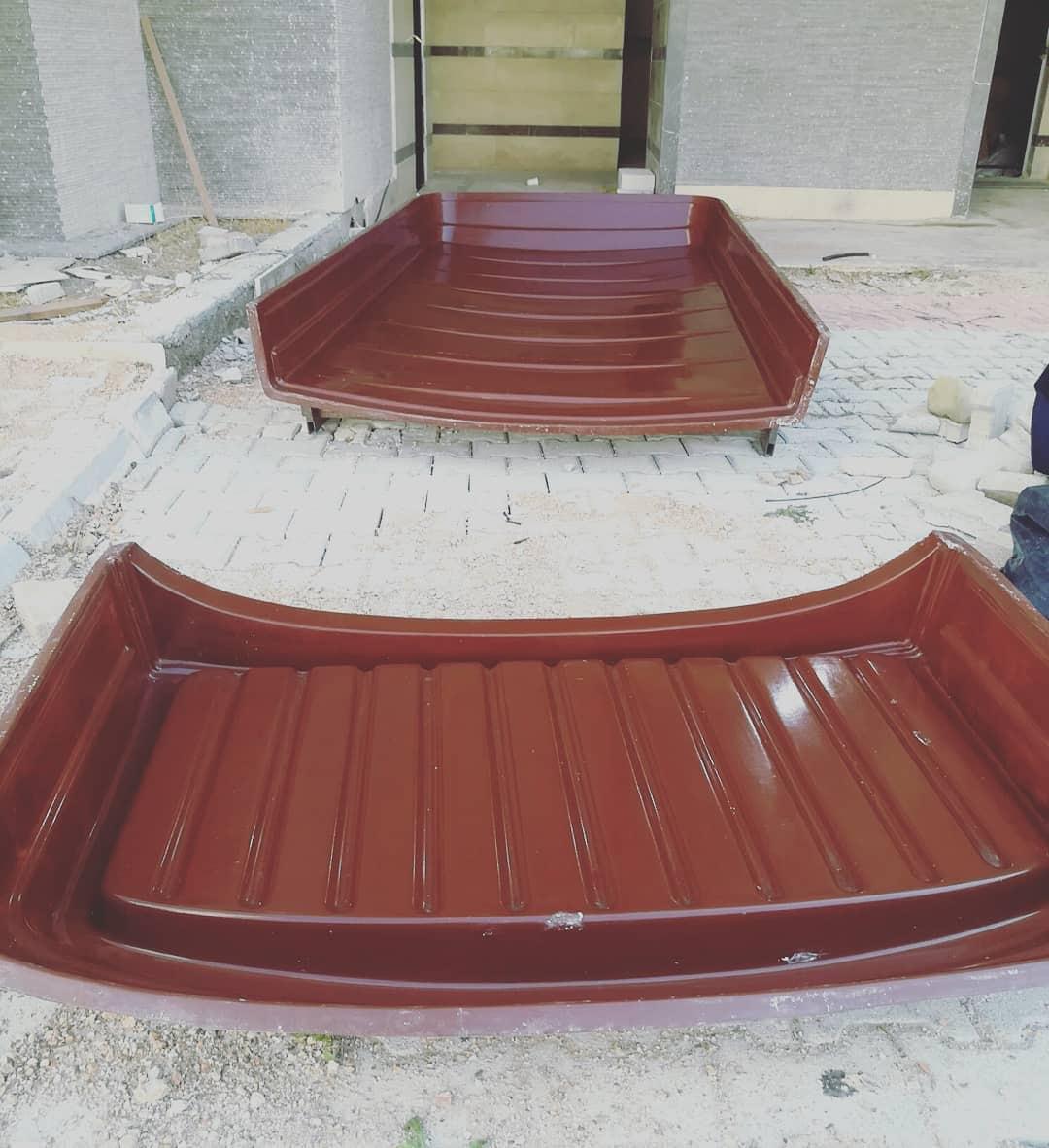

Hi Everybody,
I am writing from Turkey. Almost more than 10 years I am interested in aircooled vw's. Now: I have more than 8 aircooled vehicles. I just start to produce westy roof production with high quality mould. If anybody interested with it I can share my experiences on that.

Hello,
A late style pop top on an early bay(hinges wrong way). Who makes a canvas and hold down strips for that bastard? The roof openings holes are different sizes... Maybe I'm missing something...
Yet, the workmanship on the top looks good.

PostPosted: Wed Nov 20, 2019 10:43 am    Post subject: Re: Westy Roof Production Reply with quote
The horizontal lip around them at the bottom is not OEM, and would make using a seal impossible. If you made them without that lip, they would be better IMHO - or is that lip cut off before installing???

PostPosted: Wed Nov 20, 2019 10:44 pm    Post subject: Re: Westy Roof Production Reply with quote
Angus II wrote:
Hello,
You are right, we can do like this cndition only Smile I couldn't say OEM or Original Mould Smile

PostPosted: Wed Nov 20, 2019 10:47 pm    Post subject: Re: Westy Roof Production Reply with quote
In this photos, you can see the after demoulding shape, not finished. Trimming the lips and assembling of hinges will be done. I just started Smile

PostPosted: Fri Nov 22, 2019 1:05 pm    Post subject: Re: Westy Roof Production Reply with quote
Those look really nice! What is the material you are using? Fiberglass, ABS plastic, or something else?

PostPosted: Sun Nov 24, 2019 10:44 pm    Post subject: Re: Westy Roof Production Reply with quote
Thank you Smile We are using fiberglass.

alinghi12 wrote:
Nice dude! You make the molds yourself?? My friend and I are working on making a sandwich mold of the syro poptop. FYI we found quite a few places to source hinges and other pieces. Looks 🔥🔥🔥🔥
We can make moulds ourselves. Next point for moulding is monoblock mould for vw T1 and T2

PostPosted: Sun Nov 24, 2019 10:47 pm    Post subject: Re: Westy Roof Production Reply with quote
We started to produce hinges(4mm thickness) and pushbar.

PostPosted: Tue Nov 26, 2019 2:13 am    Post subject: Re: Westy Roof Production Reply with quote
Very nice!
How are you planning to finish the inside... there should be this soft stuff named flock to absorb and hold condens.... Are you planning on selling them?

PostPosted: Wed Nov 27, 2019 6:30 am    Post subject: Re: Westy Roof Production Reply with quote
kingkitesurf wrote:
Very nice!
There will be a seal between the car body and the product. After all assembling step, I will send many product to Europe.
