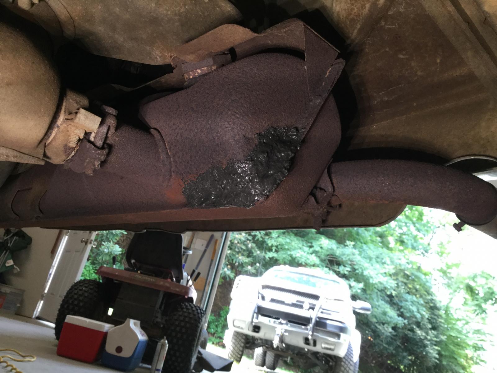

I have decided to introduce my recent adoption of a survivor 71 Squareback. I need to do a tuneup and fix a few things. It’s previous owner recently passed and the car was her father’s. It never left the family. I guess its a two owner car then, but is in remarkable shape and everything works mostly. Driver window needs love amd it has two nasty exhausr leaks. It drives slow and sounds like poop but really runs ok considering the leaking exhaust and that it has been sitting for years. But she kept it a garage and maintained the car well over the years as it feels like its totally original. I think the headliner is OG and has not amsingle tear!
This is where i found her.. fired right up the first time i hit the key.
Everything sounded pretty good at start up and i liked the dry engine compartment. I ran it down and back up a steep drive and it pulled fine.
First thing to do was plug exhaust leaks, since thhey can burn valves and the fuel hoses looked fairly recent. The muffler is toast but i thouht i d try some patch kit crap to get to drive it til i can do the muffler job. Later i adjusted the valves to .005 -thx Eric G for the pic! These pulleys look different than the beetle!!
I found a few exhaust valves tight, and pretty white looking plugs that were newly installed...that makes me worry about hot running...?
But the valve adjustment went well enough and its running smoother sounding with the leaks fixed.
Heres how that went:
Its not beautiful but itsmholding. The other leak was from around one of those large nuts threading into a pre heater riser box thing guess on top of the muffler. I taped it and used one of those hose hose clamps and its tight now.

Normally you would try to tighten the big nuts holding the two smaller heat exchangers to the main muffler body, but as rusted as it appears, you might just twist them off if you tried!
The stock muffler is a pretty decent, low restriction, balanced system. You may end up needing to replace the small HEs, and definitely will need new copper crush rings there. These can be hard to find, so start looking now and await good deals so you are ready when it really comes apart.
There is a thin 46mm wrench needed. They occasionally come up in the classifieds, but are getting pricey. Maybe find someone local who could lend you theirs? More prep for that noisy, curse-filled day!

As Phil mentioned start now sourcing out the new muffler as it will continue rot out and have it on hand when needed. Also I had to replaced my muffler and my memory says I got the copper ring in this stuff. See attached.
https://www.jbugs.com/product/341298003.html

When the muffler is off, replace the stock muffler-to-head bolts with the smaller copper or brass style... much easier to wrench, and with a dab of anti-seize, will not rust in place like your present nuts have probably done!

Yes i am dreading the muffler swap. I once did a brazilian or mexican muffler job on my old Super Beetle and there was a fair amount of cussing and struggle. It didn t fit too good, but it was cheap enough for a broke high school kid
I looked around at type 3 mufflers and they re a little more dough. Im just hoping whatever i get will fit without ‘mods’. Somewhere i saw a Dansk. Will that fit ok?
I just bought a hardware kit for the van i m working on. I had cool copper nuts. will copper colored nuts be better somehow or do they all rust into a mess anyway after enough miles. Course i guess if you do it right you don t need to worry about getting back off.
Main thing i need to know is muffler swap doable with engine in the car?

As far as swapping the muffler in the vehicle. Honestly it is easier with the engine on the stand. I like my skin on my hands. You had some rustosis on several of the nuts. The separation of the small pre heaters will require heat and lots of it. Do shop for the decent muffler components. I was shocked when started shopping for the muffler.

Nice looking SB. I also had problems with those muffler nuts. I ended having to buy a complete set of 'service wrenches'. Not the ideal tool but it worked, I have since used that set for other things as well. I also had to buy a die from China to clean up those threads and a massive nut to weld onto the mini heat exchanger.
