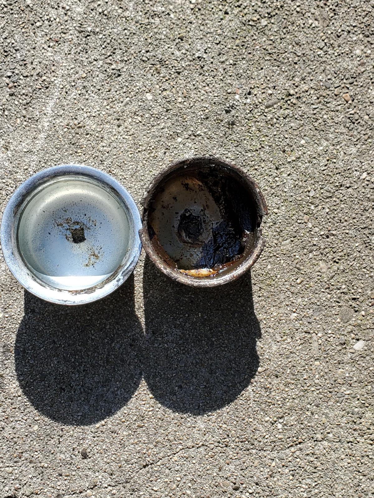

Hey guys

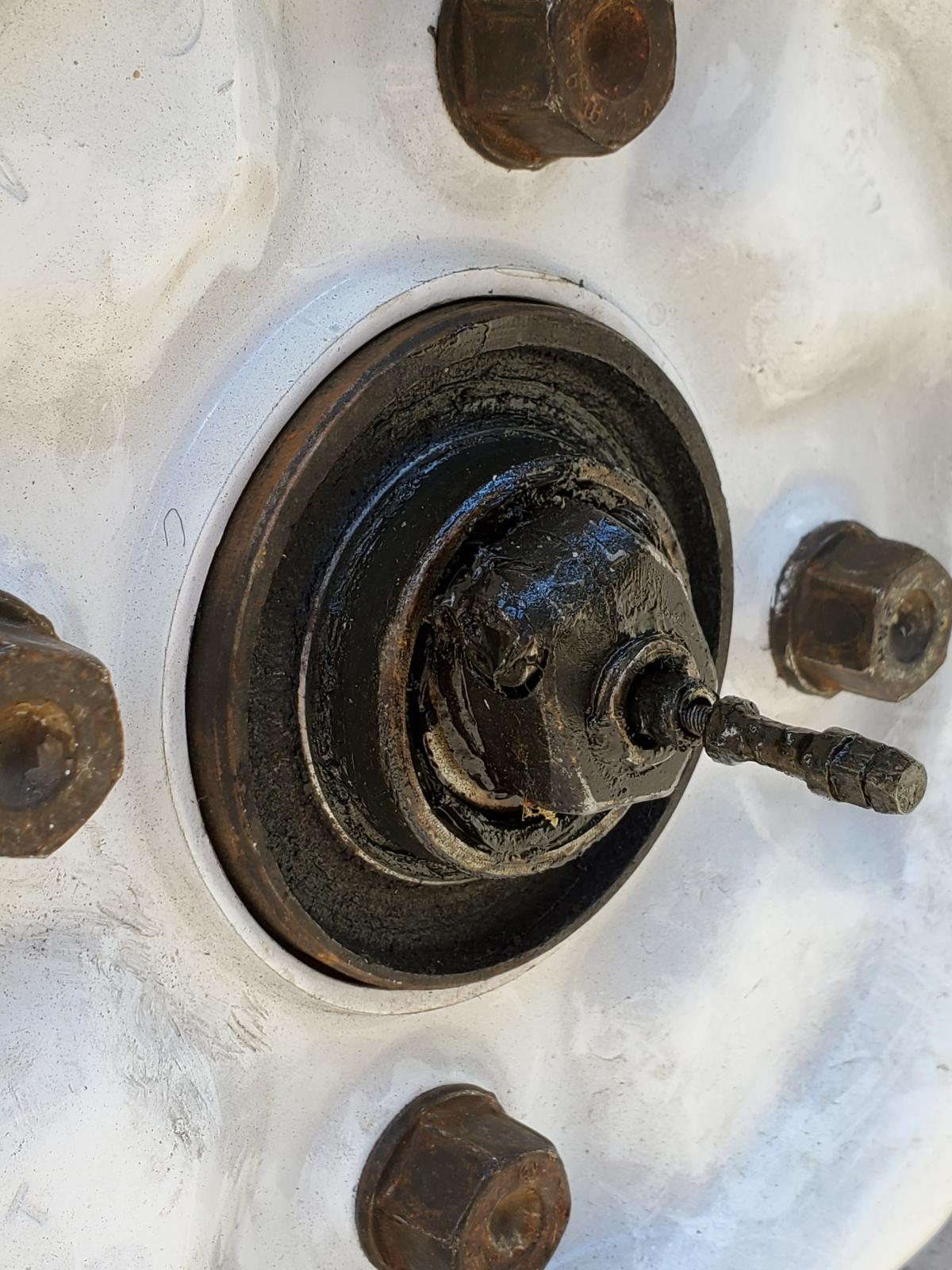

Speedo grease cap that holds the speedo drive in place on the wheel hub. Is that cap t3 specific? I got a replacement and it doesn't seem to fit the hub. Just kinda spins around. Doesn't seem big enough that I could pound it into place . Can i get a part number or am i missing something easy?

Send it back and source out a pre owned one (used) It would be more then likely German.

They should be the same. It's possible that your rotors were machined a little heavy there.

Maybe i'm not understanding its installation properly. Mine is a 73 which would take the flared grease cap. I don't understand how its held in and turns with the wheel unless you just hammer it ti'll its stuck to the rotor hub. But the one I got looks too small to be able to fit in the hub of the rotor where i'd assume you'd press it in.
Insert the cable into the square hole, and install clip. Next, hammer it on. It's a tight press fit.
Then as the rotor spins, so does the cap, and finally the cable.
Thanks, figured that.
Just seems like this one is too small as I tried to see if it would fit this weekend and it just spun freely in the rotor's hub.

So what happened to the original dust cap? Generally they are snug fitting and need to be pried off when removing.

Well I'm out of ideas. Got a 73 grease cap off the classifieds and it fits more snug but not enough. There isn't a circlip or anything that holds the cap on? It's just press fit?

Nope, just a press fit. Same for RWD domestics. Or FWD rear hubs (rabbit/golf) and some Hondas and Toyotas.
It's possible you're not driving it on far enough. You do have a lot of cable sticking out. Do you have the rubber plug in the back of the spindle for setting cable depth in place?
Guess i'll have to take it to someone because i'm pounding the hell out of it and its just not sticking.

On the aftermarket cap I had to dimple one with a punch to make it fit snugly. I put about 6-8 dimples on the side with a round punch.

So heres what it was.
Bad Rotor.
The rotor i had was some chinesium and i replaced it with a german rotor, everything works as it should now. Old one just wasn't machined properly.
