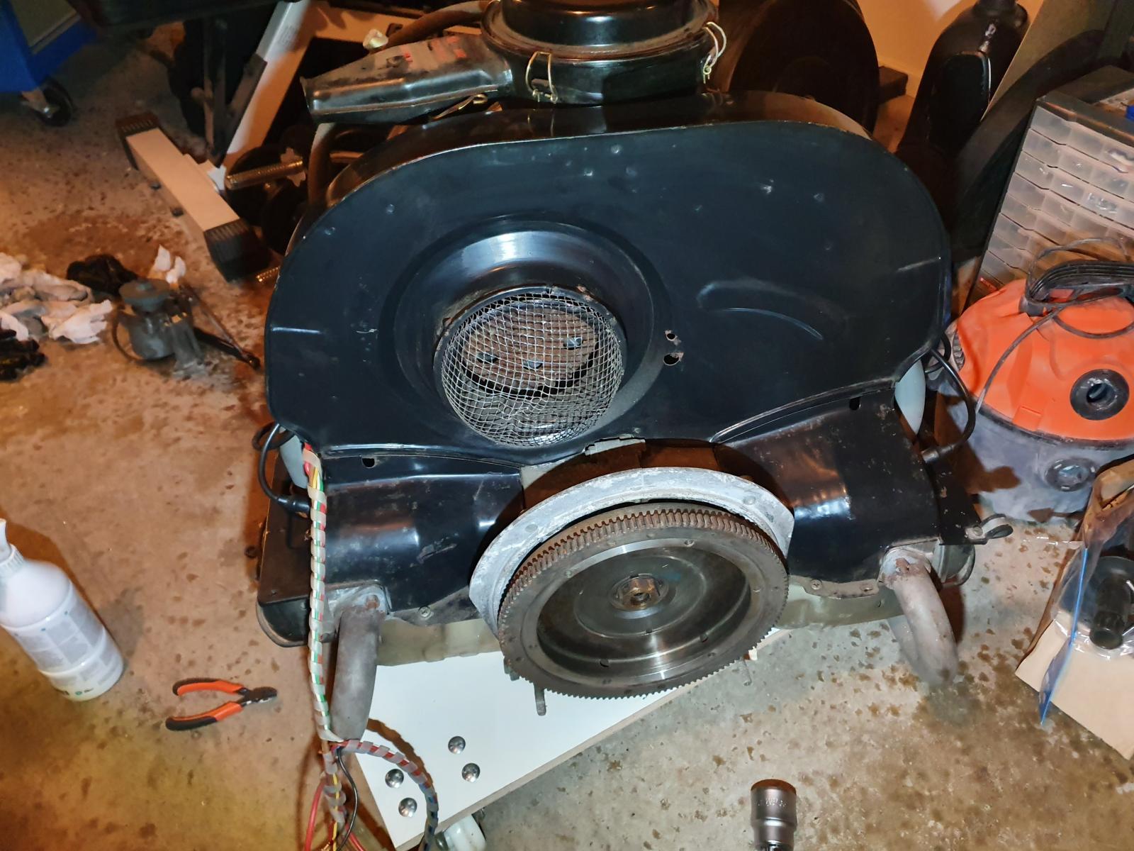

PostPosted: Thu Jan 09, 2020 7:01 am    Post subject: Re: Replacing worn engine with a industrial engine - Change what? Reply with quote

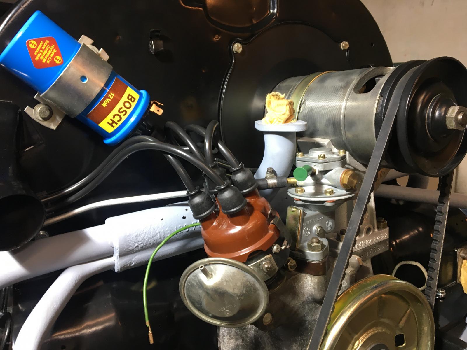

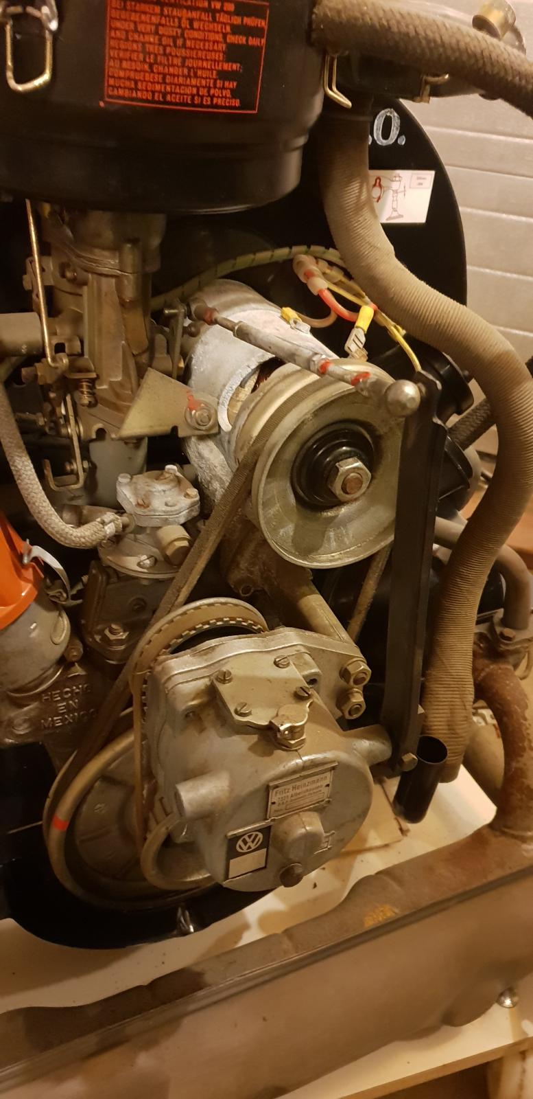

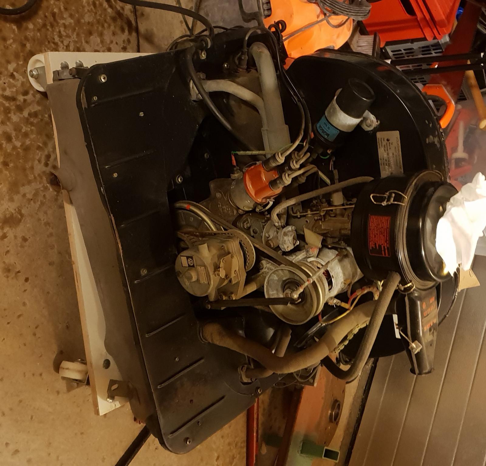

Ok great, here are some additional photos...
And no heater tubes, these I will remove from the other engine. Thats the plan atleast.
tasb Premium Member
The Distributor Distributor
Joined: April 27, 2002
Posts: 6675
Location: Pentwater, Michigan
tasb is offline
PostPosted: Thu Jan 09, 2020 7:48 am    Post subject: Re: Replacing worn engine with a industrial engine - Change what? Reply with quote
We'd needto see the front side of the fan housing in order to determine if the thermostat and flaps is in place.
That's either a 26 or 28 PCI Solex carburetor that I don't believe is set up for a vacuum advance distributor.
I would source a German Solex 30 PICT 1 carburetor with the added fuel take off fitting and a 113 905 205 K vacuum advance only distributor. That pairing was factory stock for 1966 1300 through 1967 1500 single port street engines.

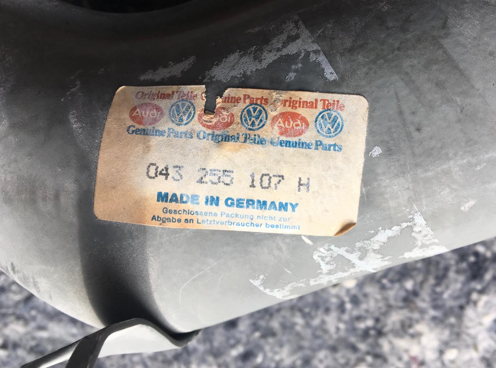

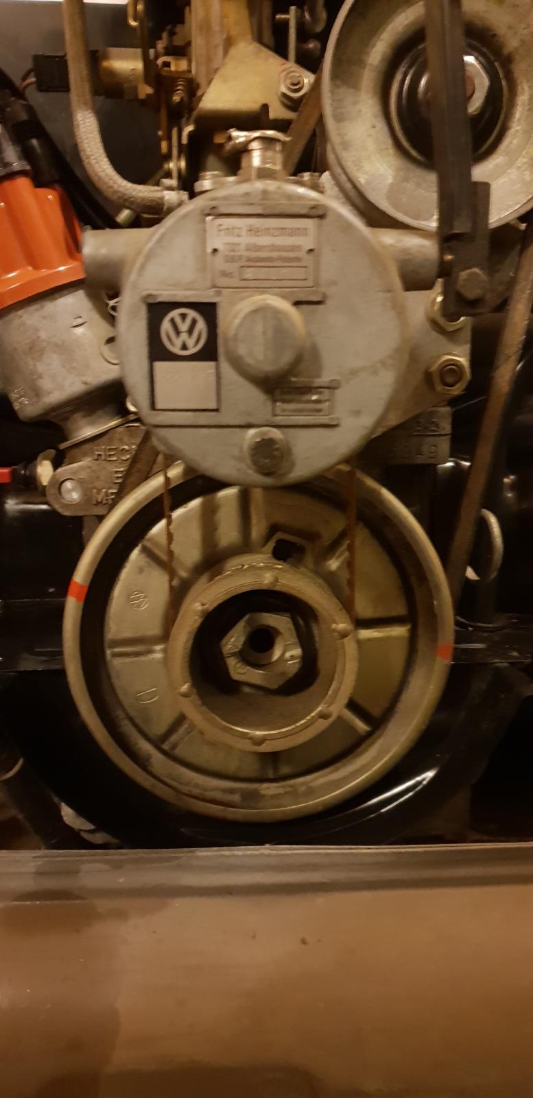

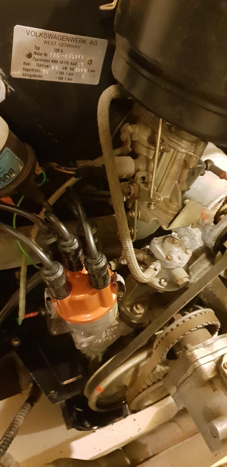

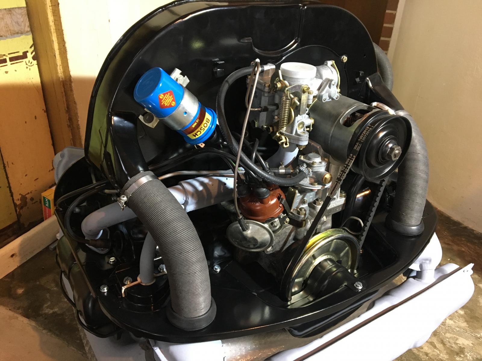

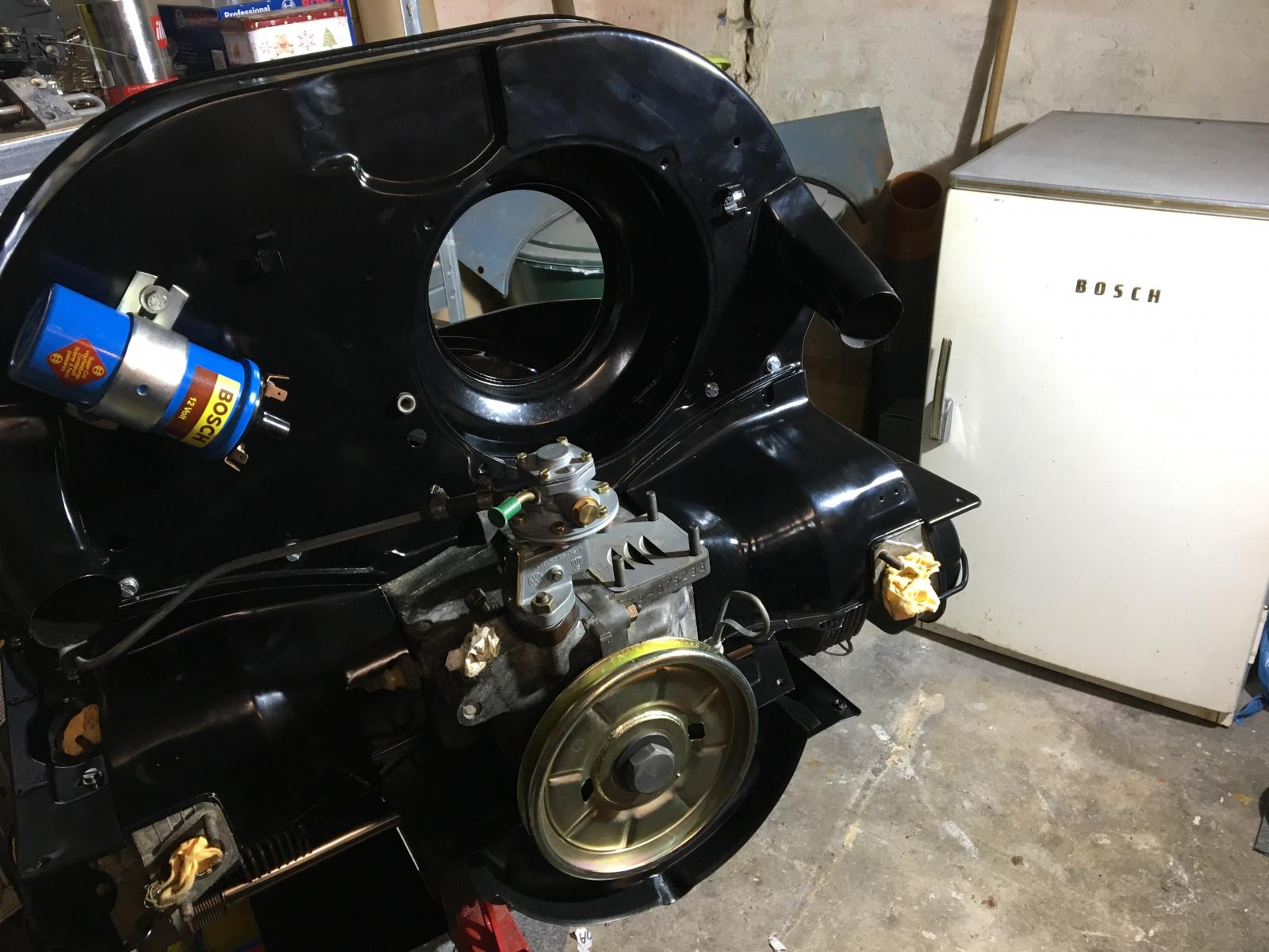

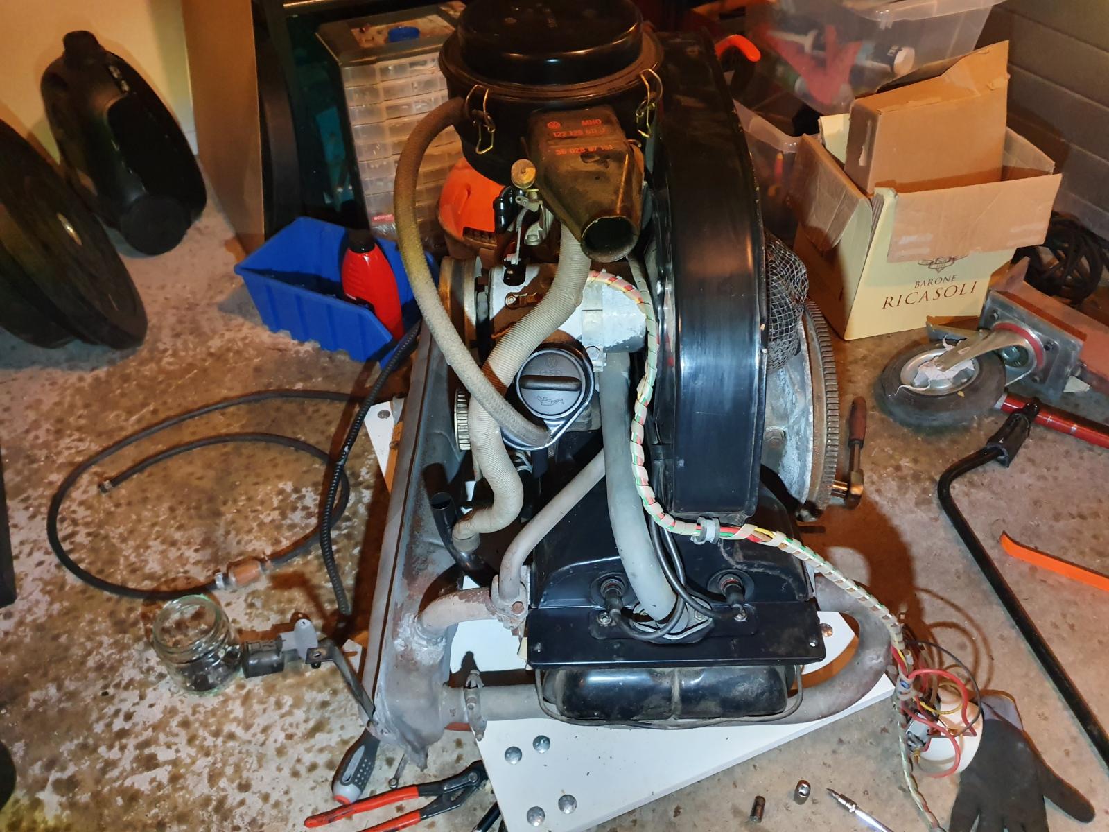

PostPosted: Thu Jan 09, 2020 11:36 am    Post subject: Re: Replacing worn engine with a industrial engine - Change what? Reply with quote

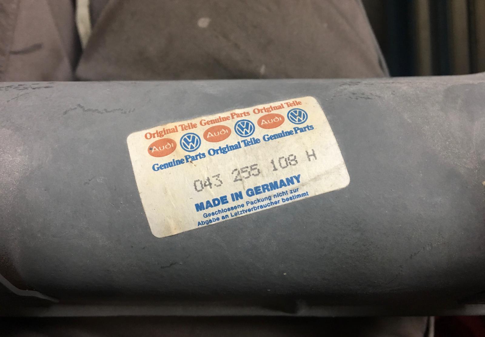

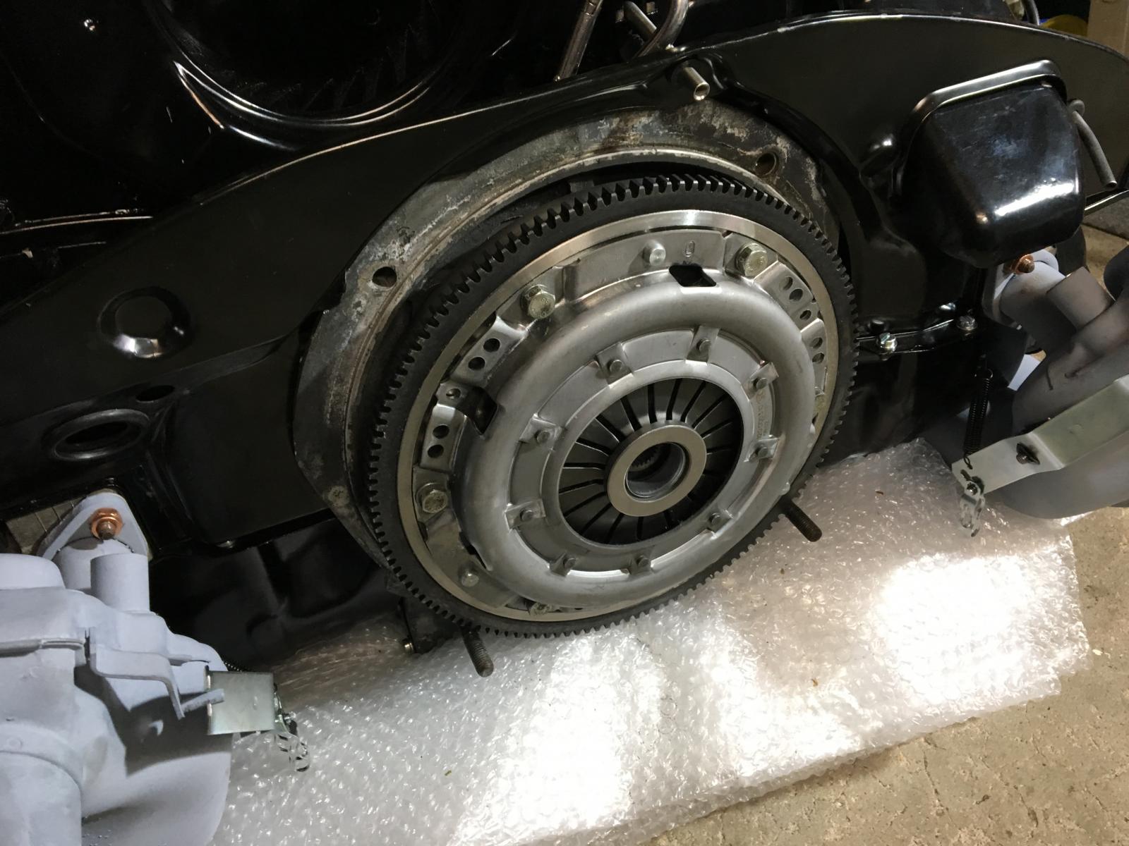

Here are some pictures of the back.
So its a good engine?

PostPosted: Thu Jan 09, 2020 11:53 am    Post subject: Re: Replacing worn engine with a industrial engine - Change what? Reply with quote
No thermostat assembly.

PostPosted: Thu Jan 09, 2020 4:06 pm    Post subject: Re: Replacing worn engine with a industrial engine - Change what? Reply with quote
Your first pic is of the front of the engine as in facing the front of the car. You may have a good long block there- don't know about the cam issue. You top end parts are another story. Carburetor, intake manifold, distributor, fan shroud should be changed out. It's advisible to source the thermostat assembly. You should be ok with coil, generator. you may need different cylinder heads?

PostPosted: Thu Jan 09, 2020 4:25 pm    Post subject: Re: Replacing worn engine with a industrial engine - Change what? Reply with quote
What is the problem with the intake manifold?
Probably could source the rest from my old engine.

PostPosted: Thu Jan 09, 2020 9:16 pm    Post subject: Re: Replacing worn engine with a industrial engine - Change what? Reply with quote
If the heads are 1500/1600 you'd be all set but that 26/28 PCI was from the 25/36 hp era and if the manifold is too the two don't interchange.

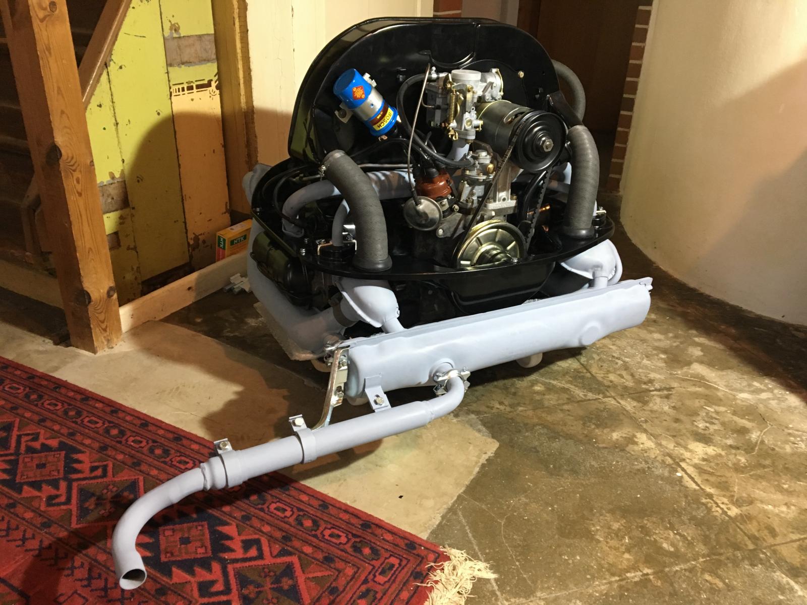

PostPosted: Sat Jan 11, 2020 1:39 am    Post subject: Re: Replacing worn engine with a industrial engine - Change what? Reply with quote
I recently built up the same engine. It’s the earlier German AS21 case. This engine is quite similar to the early bay window „B“ engine.
Depending on how the result should look like, you do have lots of options completeing your engine. My aim was to have an almost stock looking one for my 67 deluxe with the advantages of the later engine (better case, more power, etc.).
Presuming your aim is similar to mine you will have to choose the correct tinware for your modelyear. There are many changes to them over the years. Check the gallery for your correct setup.
You’ll need the thermostat. Industrial engines don’t have them.
I decided to go for the doghouse fan shroud to have the cooling improvement for the third cylinder. This includes some more changes like larger fan, offset cooler incl. flange and additional tins plus sealings etc.
New crank pulley is needed with corresponding advance marking.
Then of course the heat exchangers. Try to get genuine VW ones, no repops. I was lucky to get hold on two NOS ones. They are the later style though, but do fit.
If you’re installing a carb together with the governor you have to choose the correct intake manifold. Also you might want to go for the bigger 105mm generator. Then you’ll need the correct generator stand aswell. Industrial engines usually came with 90mm gens. The intake manifold for industrial engines doesn’t go with the large generator. There is a version with a slight offset of the intake so the carb travels a bit to the left, creating enough space between carb and gen. Then there is the mentioned variant for the governor (It’s the version „G“ as I recall).
The 12V setup would require the 130 teeth flywheel with 200mm clutch. Don’t forget adjusting the crank endplay here. This is crucial.
I paired a NOS Garbe Lahmeyer distributor (113 905 205 L which I converted to the adjustable „B“ version - thanks to „tasb" here at thesamba) with a NOS 30 PICT-2 carb. This is my result.
There are differences in the cam shafts for industrial/street engines. The valves seem to be the same though. I heard that the springs for the valves are different too (different tension). Nevertheless I haven't experienced any issue driving a similar industrial engine setup in my deluxe for many years previous to this latest one.
-EDIT- I just x-checked some VW references for the partnumbers for cam, valves, etc. They are generally the same as on street versions. But there exist m-codes for industrial engines too, which may leed to deviations. I found a set of pistons and cylinders specific to the industrial version only. So genarally speaken, I guess the standard version of the industrial engine is pretty similar to the street version.
It’s been my daily driver back then for about six years with lots of long distance trips - no props even in the cold of Finnish winter at -30 C daily driven.
So nothing to worry about Wink

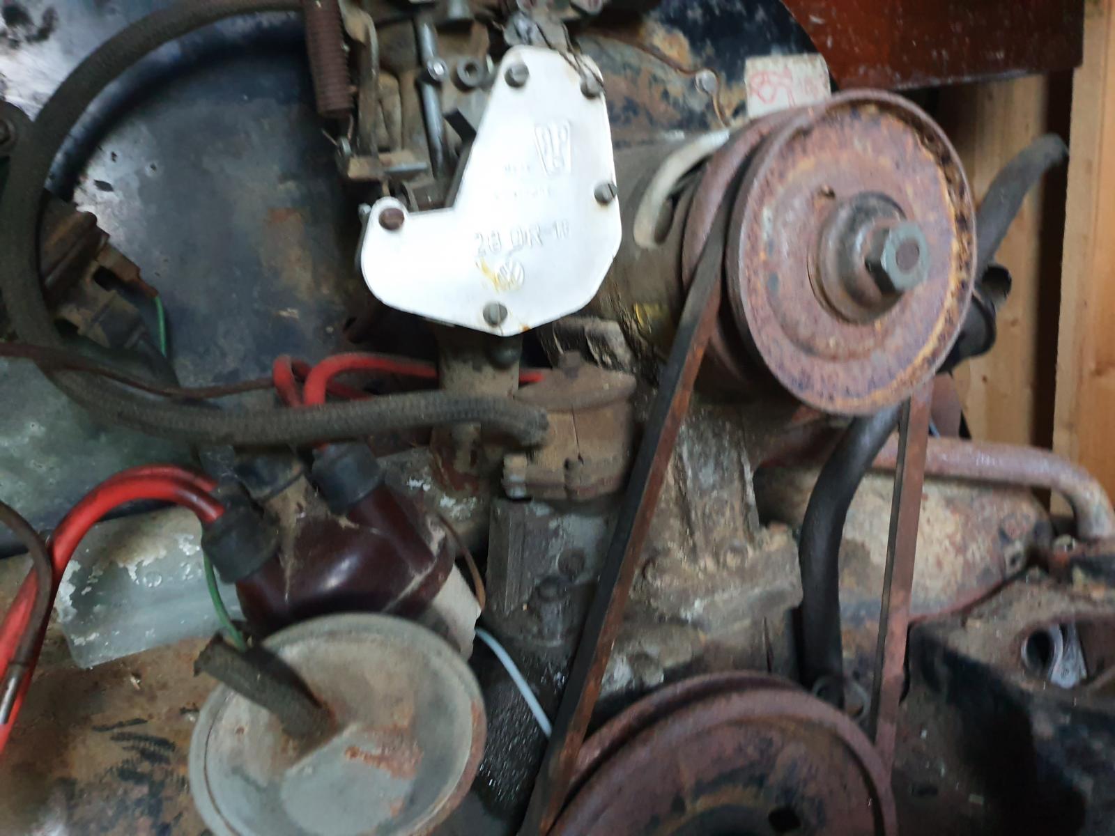

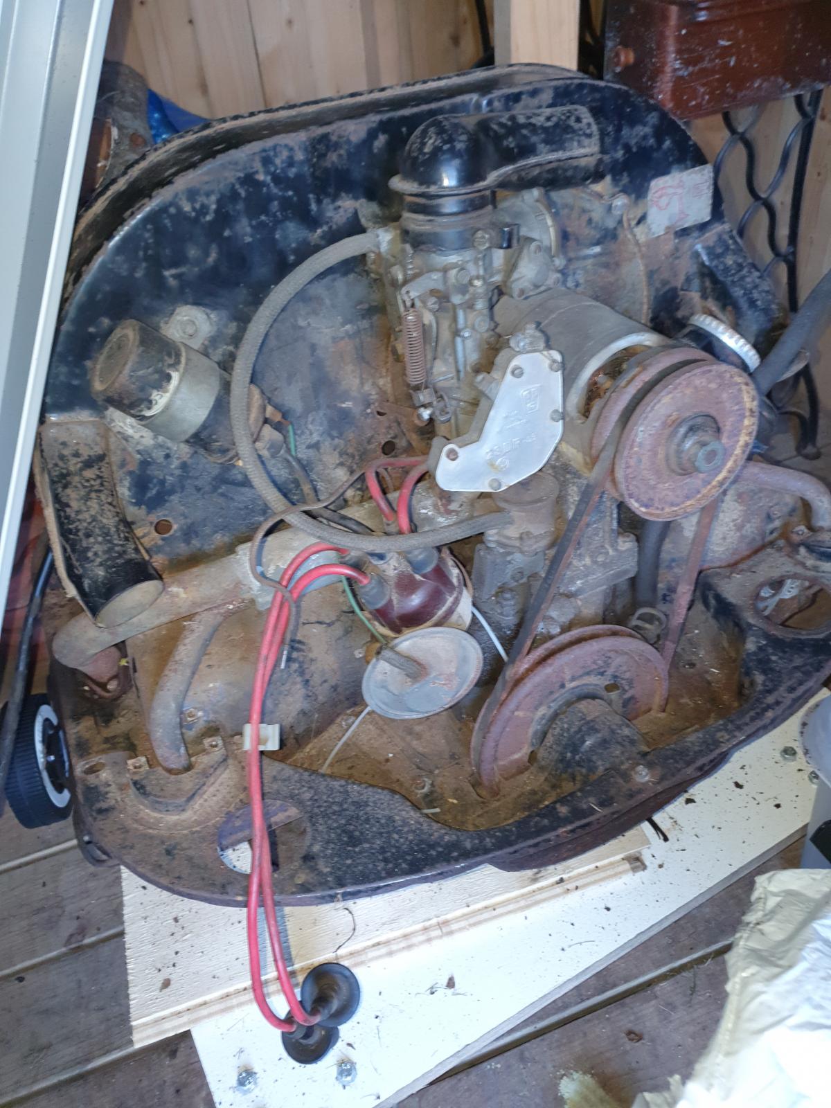

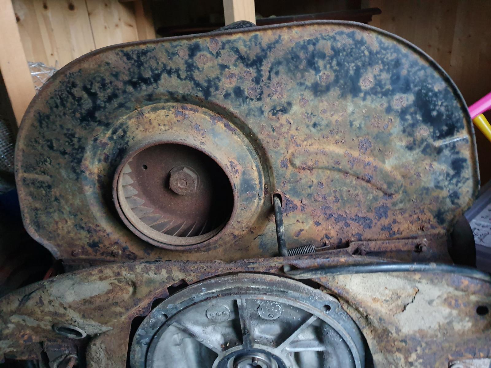

PostPosted: Sun Jan 12, 2020 7:47 am    Post subject: Re: Replacing worn engine with a industrial engine - Change what? Reply with quote
Thanks for a very informative post @Tizan. My plan is to build a motor with the same intention as you, a reliable engine with a little extra power.
Here are some photos of the original engine.
Thinking about sandblasting the heatexhangers and if possible reuse them.
What could be salvaged from it?
Doghouse fan shoroud with additional parts might be a good uprade?
