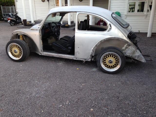

I got this beauty home in about 15 months ago. She had 16" BBS porsche wheels, kerscher coilovers in front when i bought her.
April 2014 i parked her and started rebuild. I want a GL.

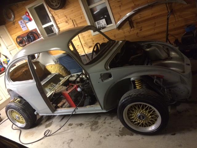

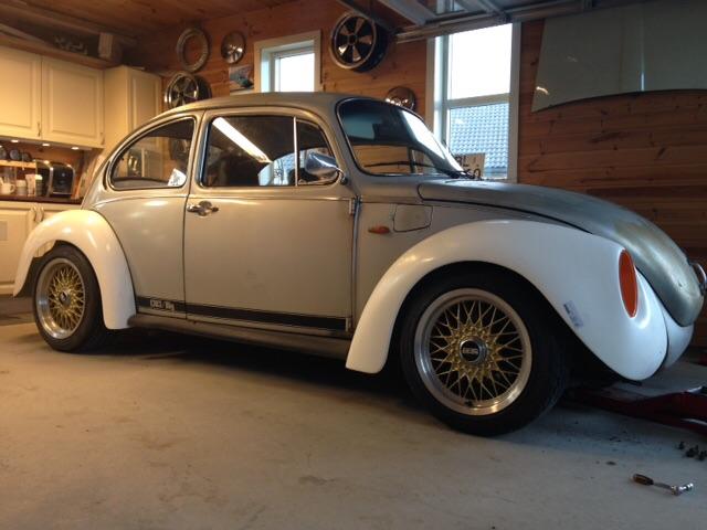

May 19. 2014 I parked the car and started strip down.
New csp fibreglas fenders tested
Finished sandblasted

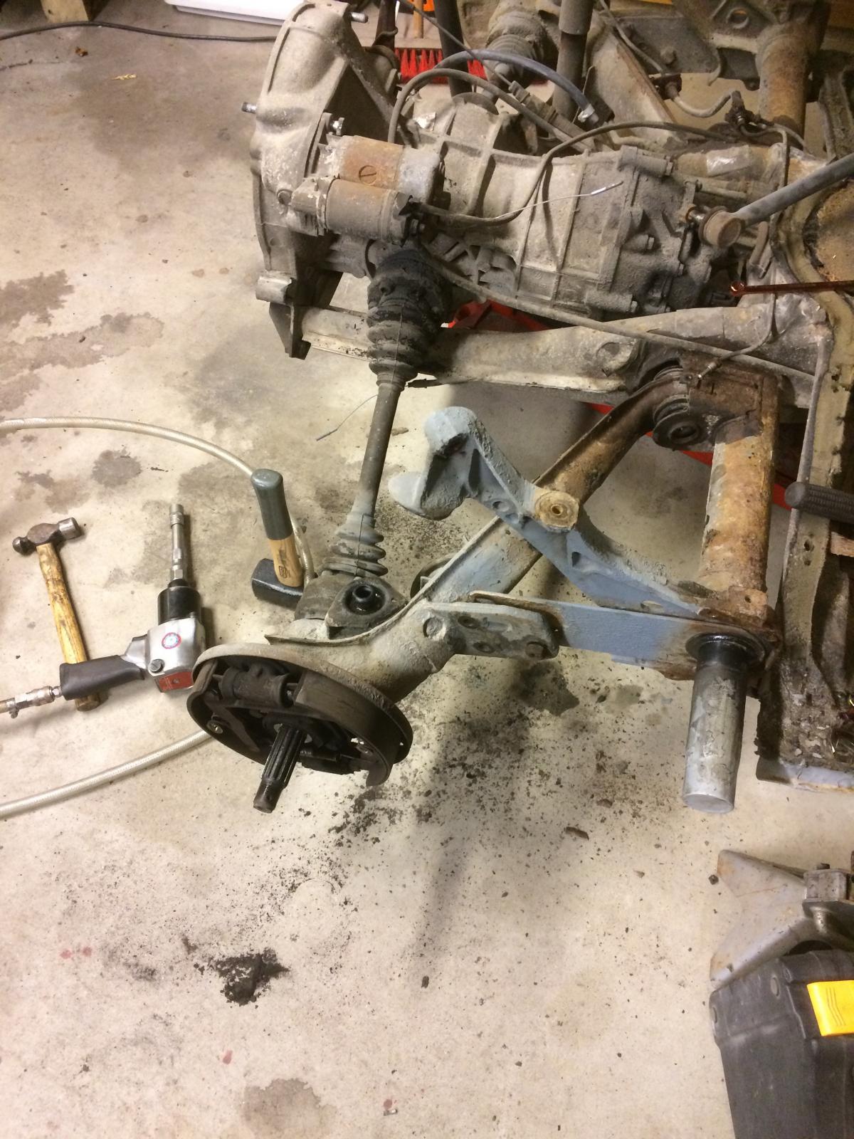

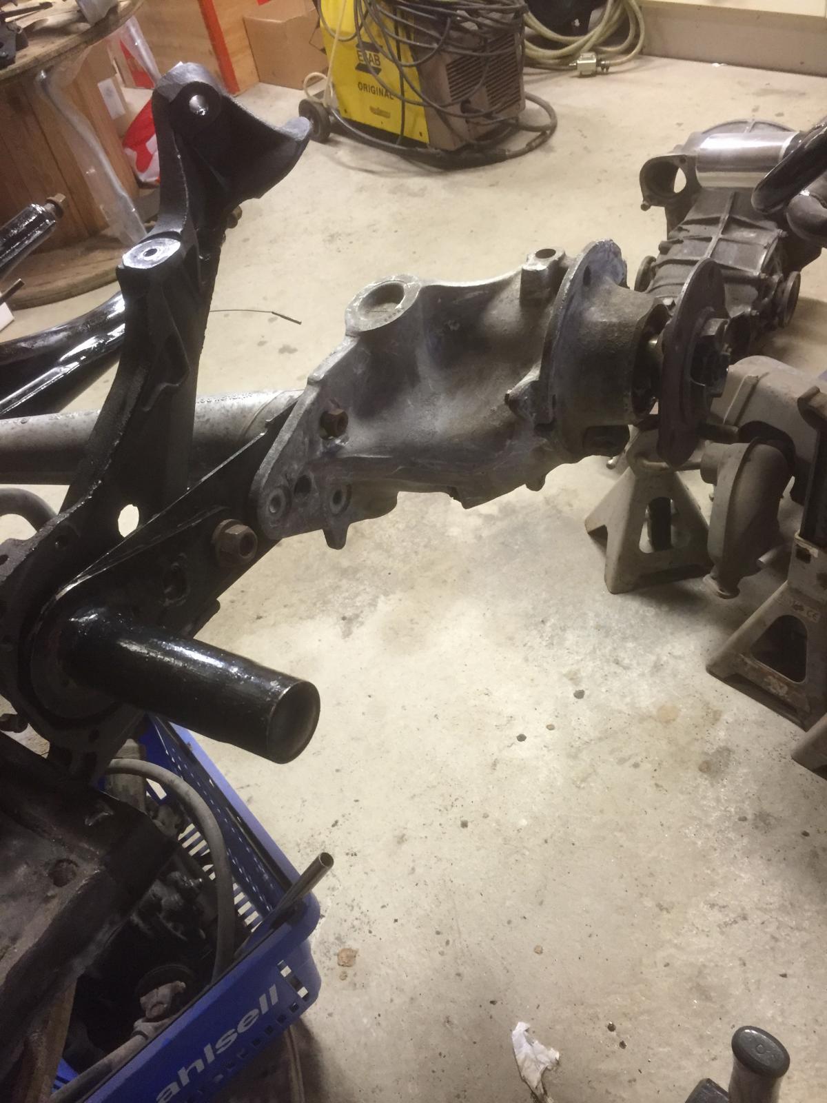

PostPosted: Sun Mar 08, 2015 1:22 pm    Post subject: Reply with quote
A little time in the garage this evening and right side of irs is almost in pieces. I need some new tools to unscrew the driveshaft. I guess this had been easyer if I had not dismounted the handbrake Confused
I think a new 6 mm umbraco and a big drill will do Smile

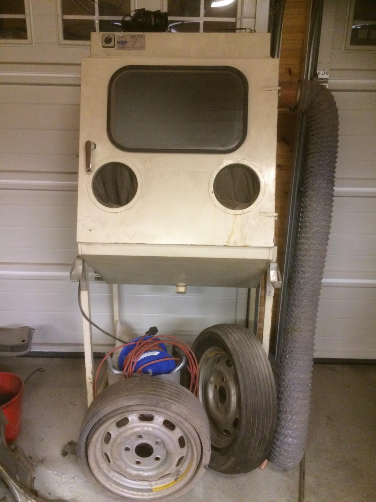

PostPosted: Mon Mar 23, 2015 3:22 pm    Post subject: Reply with quote
Finally everything is apart and I can start with the fun part :-/
I am lucky to have a cabinet type industry in my garage for as long as I want, and then its just to start with the parts...

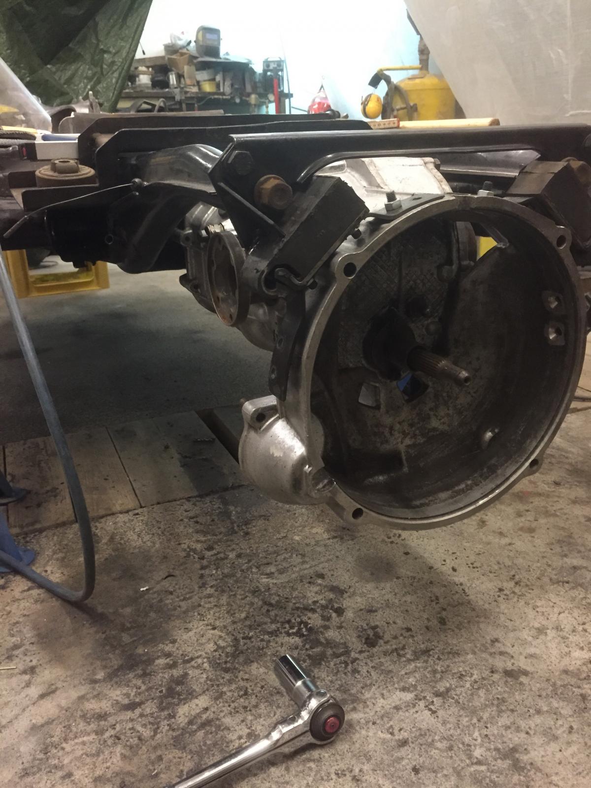

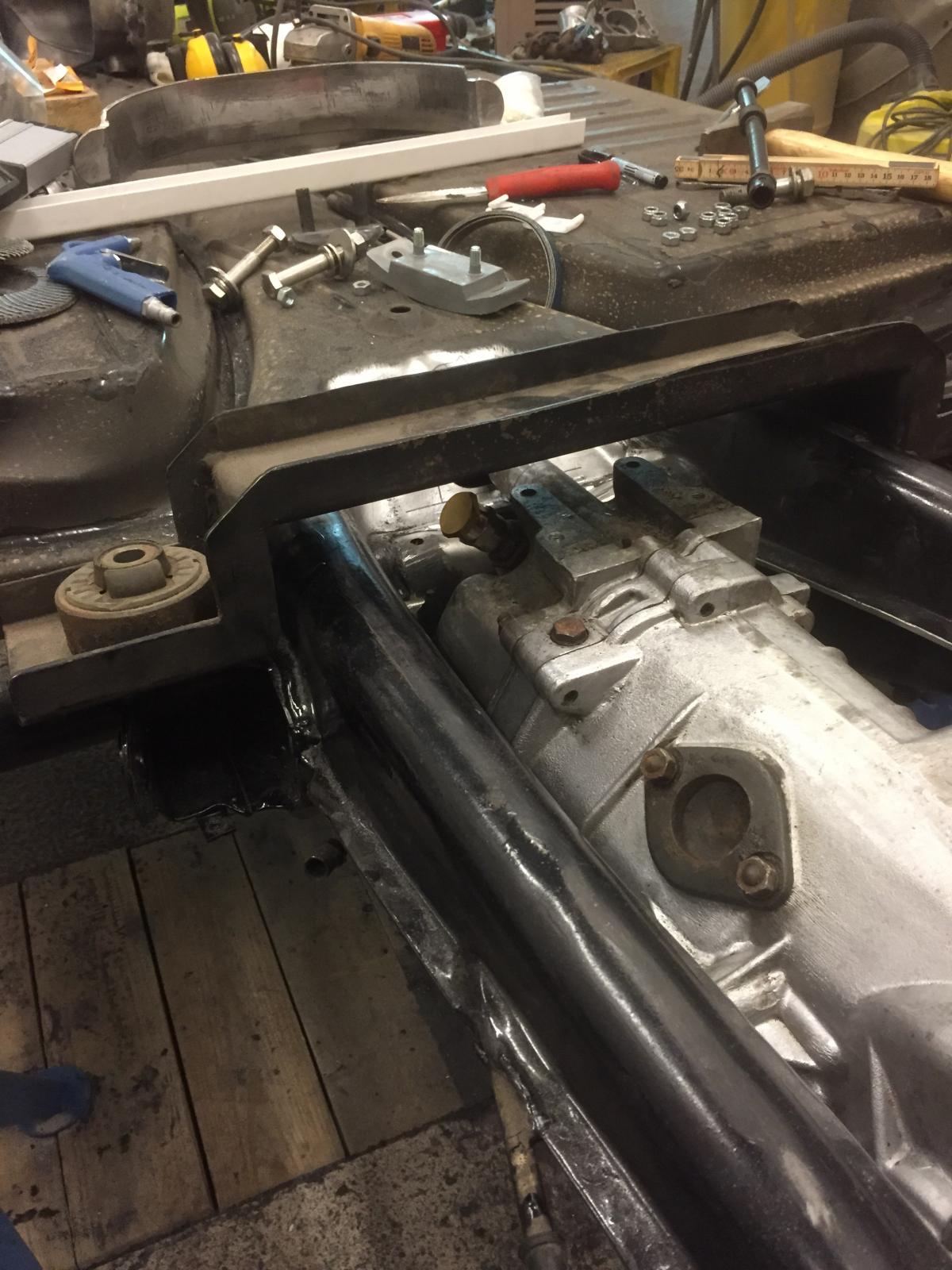

PostPosted: Mon Aug 17, 2015 3:09 pm    Post subject: Reply with quote
As usual a lot of more work than i thought, but its going forward.
Rear mount I had to make of an old one and the new front mount also needed some cut an weld...
Almost there with the gearbox.

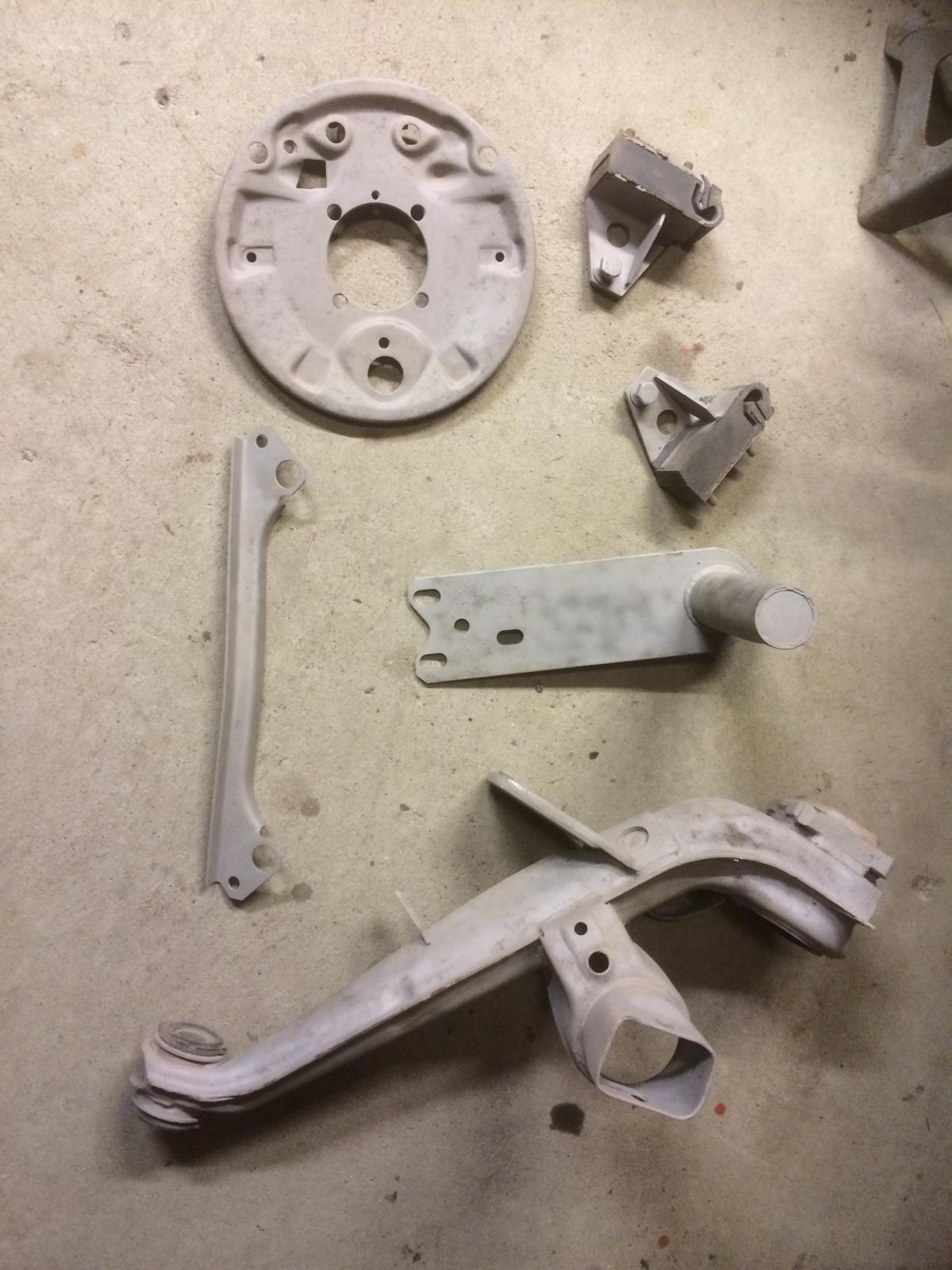

endresta
Joined: January 12, 2007
Posts: 190
Location: Norway
endresta is offline
PostPosted: Wed Aug 19, 2015 1:40 pm    Post subject: Reply with quote

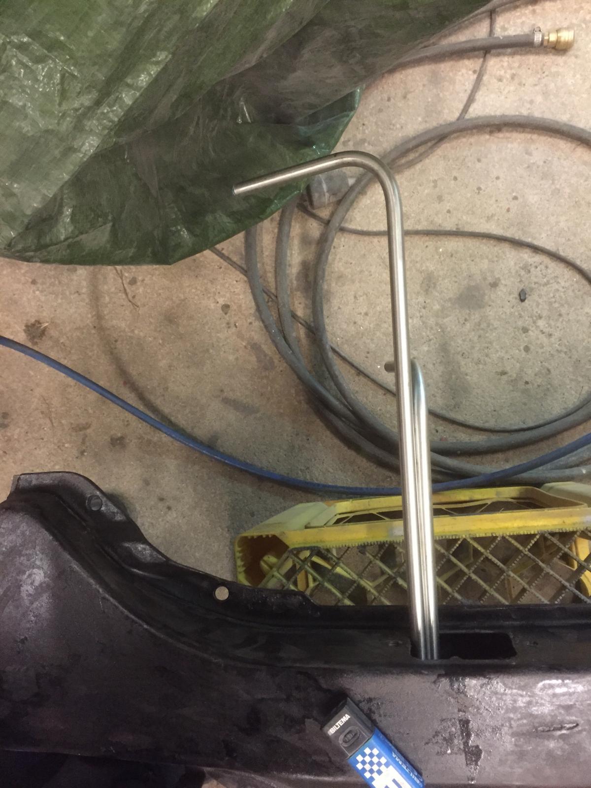

New day, new possibilities or what it says....
The gearbox mounts are finished, next is to close the new gap or hole where the shiftcoupler is.
And when I first have this area open I want to pull new fuelpipes in the tunnel.

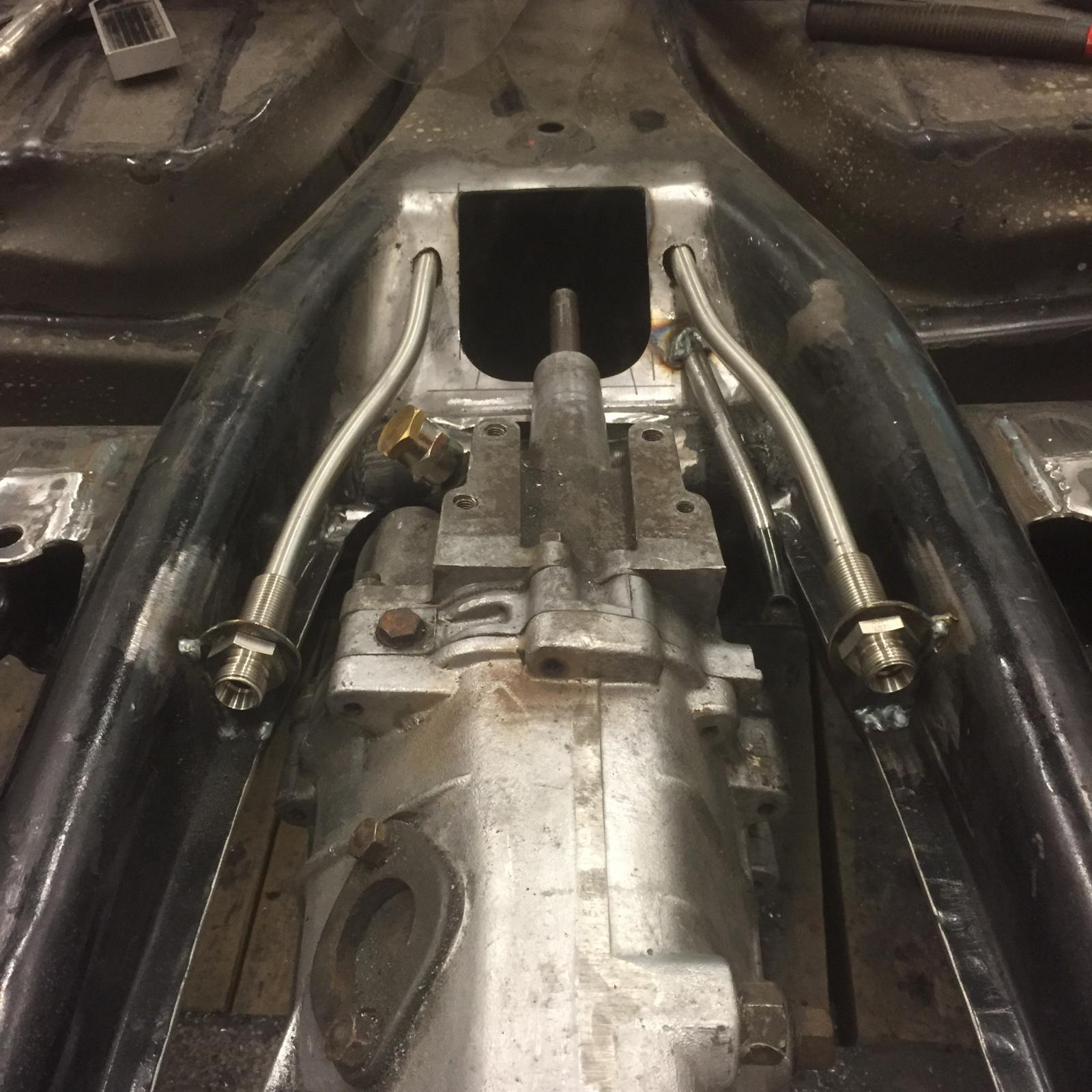

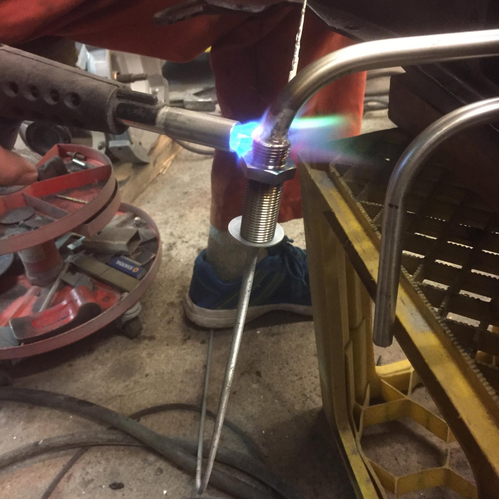

PostPosted: Wed Aug 26, 2015 2:38 pm    Post subject: Reply with quote
New fuel lines finished. Thanks to my good friend Kai for all the help, could not have done all this without you.

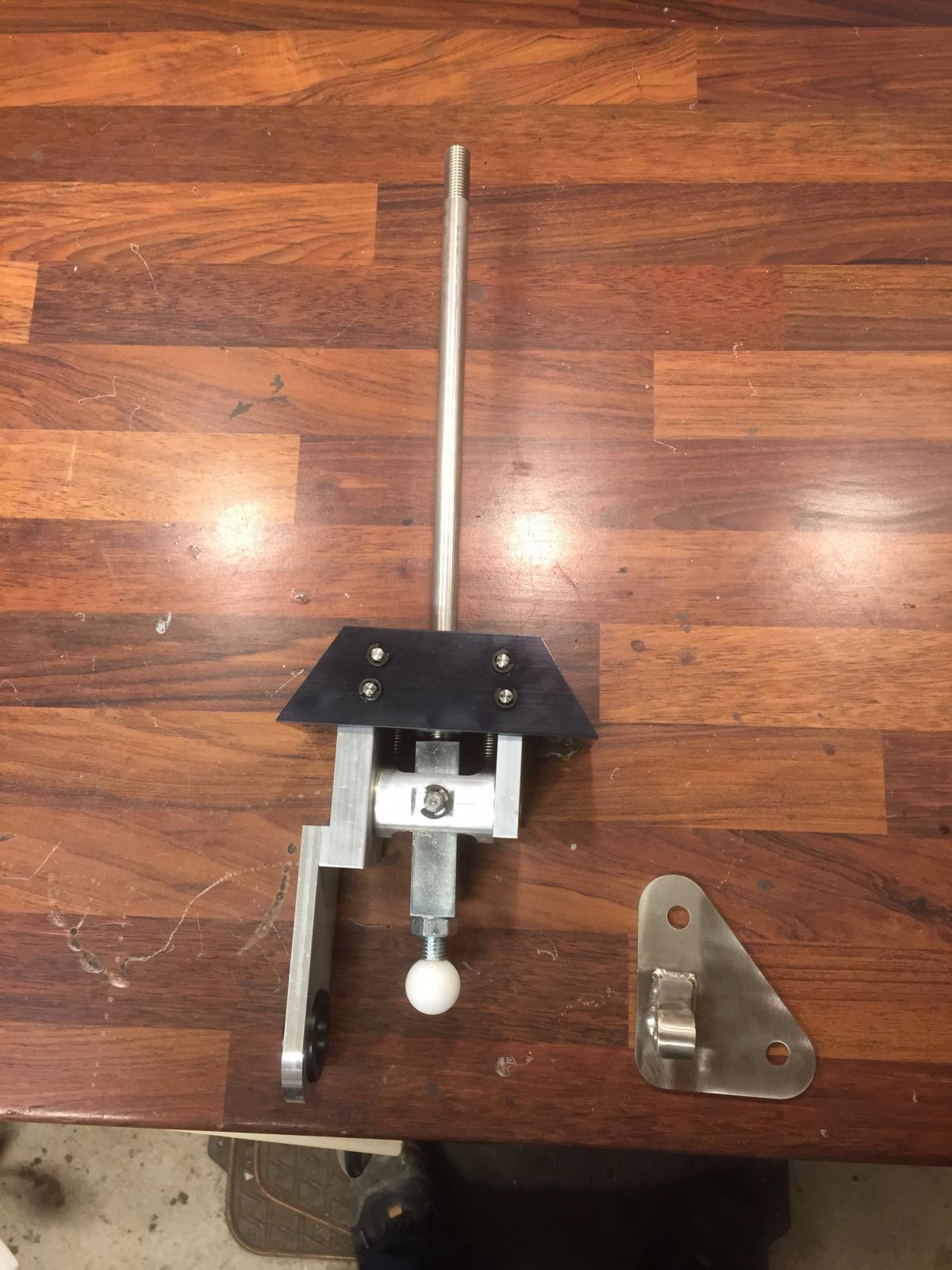

PostPosted: Mon Aug 31, 2015 2:27 pm    Post subject: Reply with quote
The transmission finished in the rear end. Cut the shift rod 6 cm and weld in again. Make a housing around after. Finished yeyyy 😊😊😊 and the best part, every gear works😃 this gearbox have been in storage for about 15 years so I look forward to try it 😁

PostPosted: Mon Mar 28, 2016 5:36 am    Post subject: Re: My -74 SilverBIG Reply with quote
Its been a while since last update, but a lot of work is done. Floorpan and all parts for wheels and suspension is painted and started to bolt together again.
In the front, new porsche 944 mastercylinder, kerscher ball joint for 944 spindle. Working with the brakelines
Porsche NA brakes redone. New gaskets and pads.
Porsche 901 gearbox painted and mounted. Working with the rear trailing arms and brakes. Hopefully finished with all the work with the floorpan by late spring....
