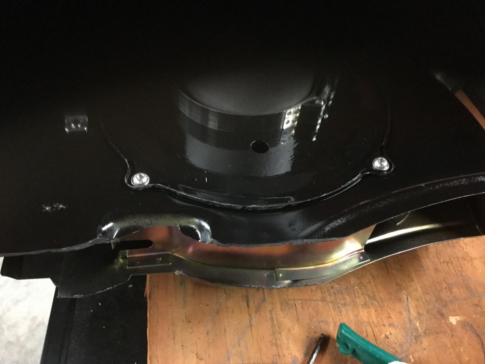

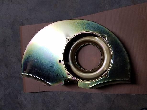

PostPosted: Thu Apr 02, 2020 5:21 pm    Post subject: Re: “Newer style” doghouse any good? Reply with quote
The scat shroud and scat backing plates work as it should, vent down.
Photo from Scat:
Photo of the Scat shroud I am putting together right now:
