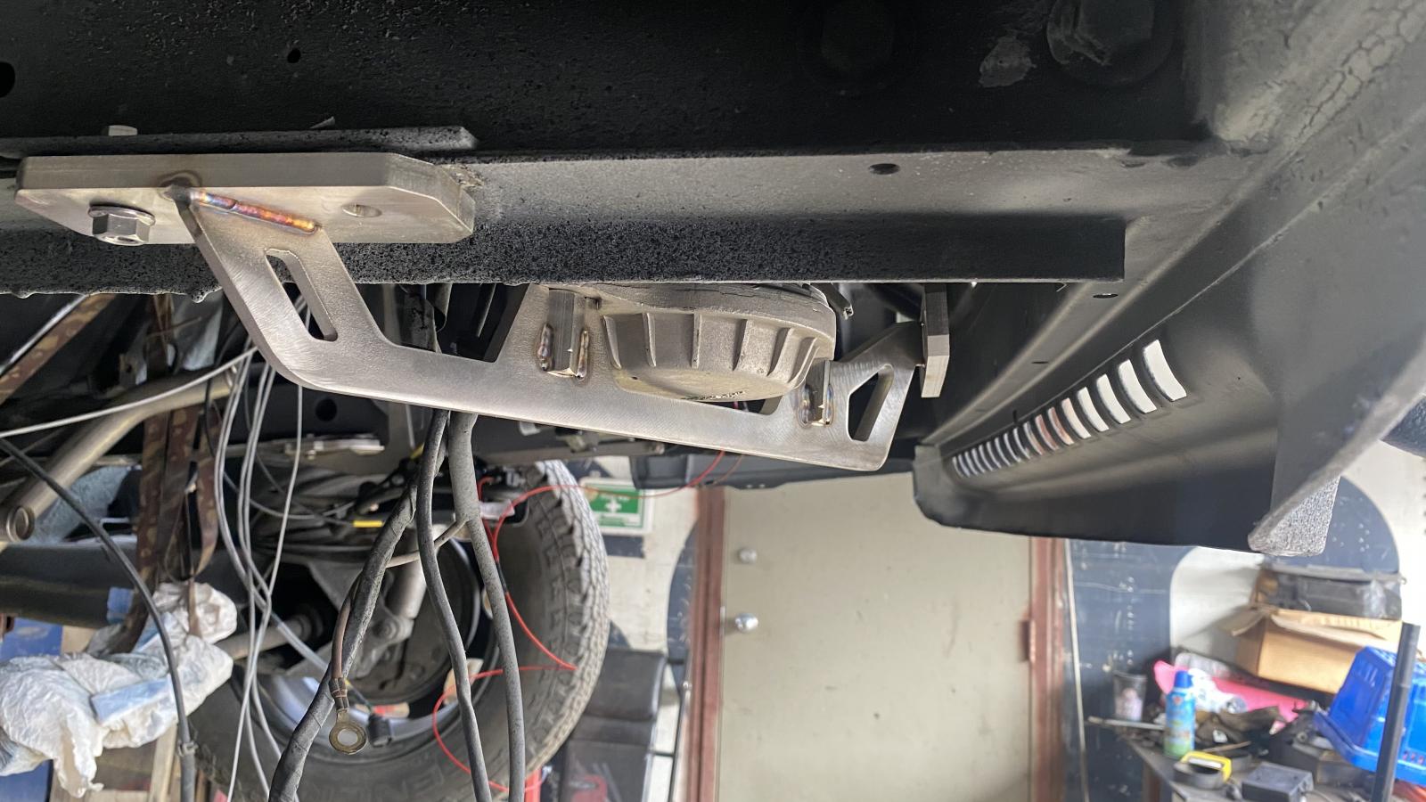

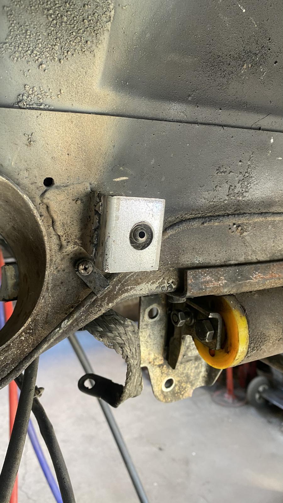

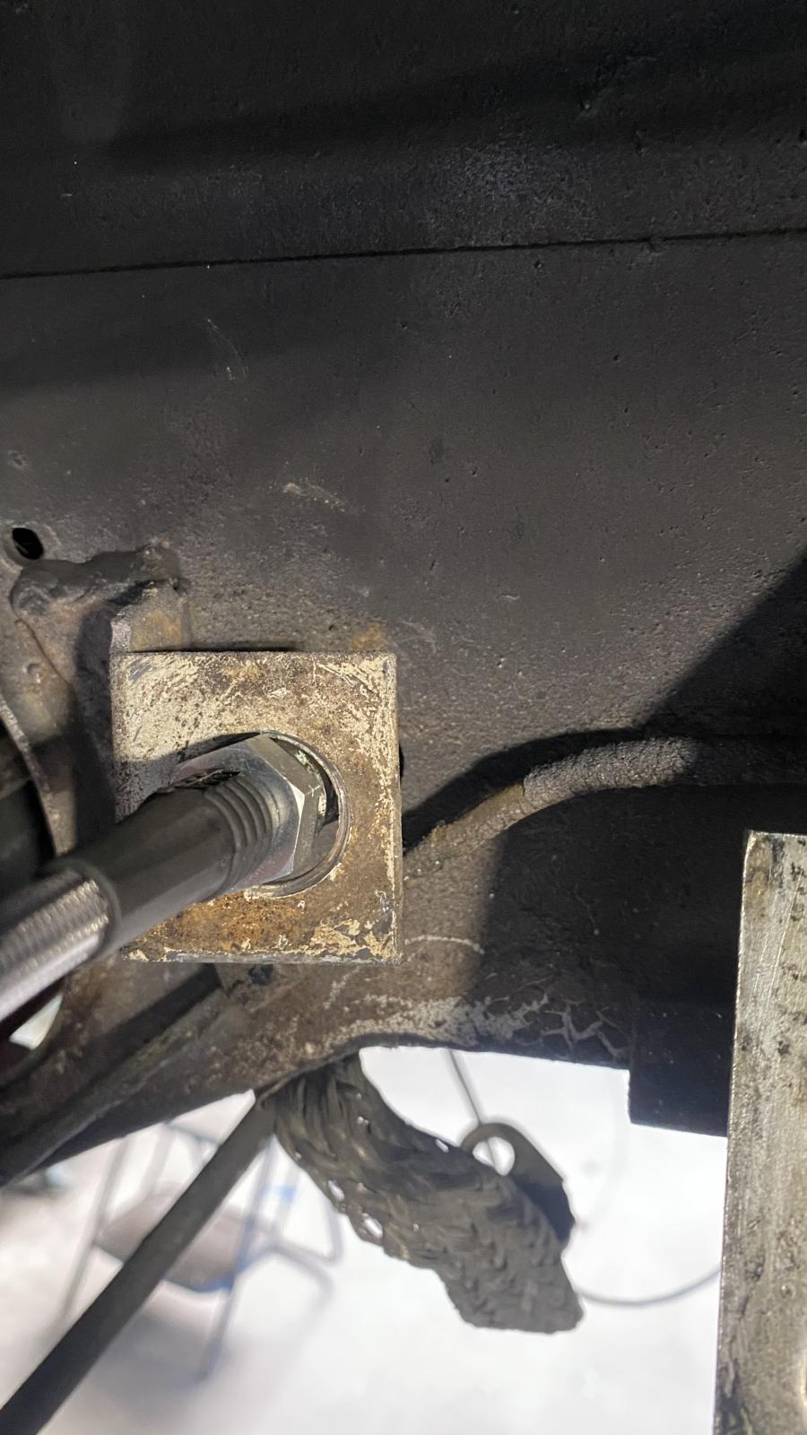

As I was test fitting my new clutch slave, I noticed the rubber hose from the frame to the slave was totally rotted. It was holding fluid, but I suspect that wouldn’t be for long.
I ordered a new braided line from burley that simplified the whole design anyway.
When I got it, it was really different. The nut on the end went from 17mm to 13mm and didn’t have the fit I was looking for- it was loose and killed like it wanted to fall out.
So I contacted burley. It’s nice to have some good customer service. He texted me back and we chatted it out. Short of it is that my old design is.... NLA from what I can tell. So I made a new bracket.
Cut it out of some spare galvinized sheet metal, welded it back on- and now I have a proper modern sized mount.

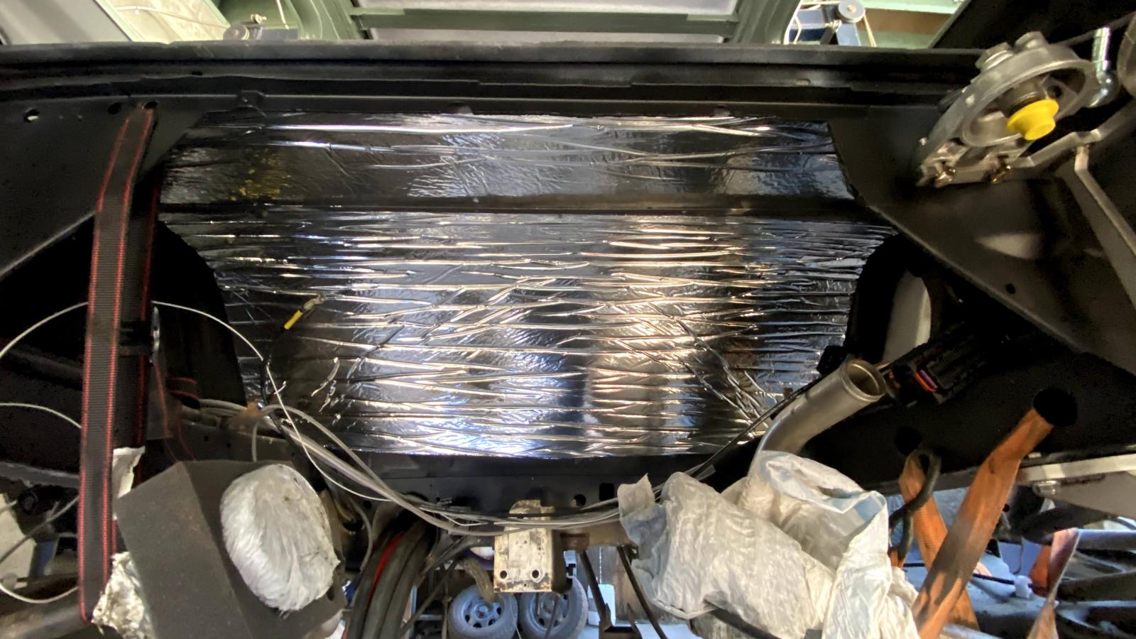

completed, painted and mounted lil brace for the new hydraulic line:
I also did some test-fitting with the new, nice sound deadening (VB-TSM http://cascadeaudio.com/car_noise_control/vb_tsm.htm) from Cascade Audio guy in Louisiana. I would sleep on that stuff- it was expensive, but damn it was nice. And I cant rave more about the customer experience buying from Earl. Seriously cool dude.

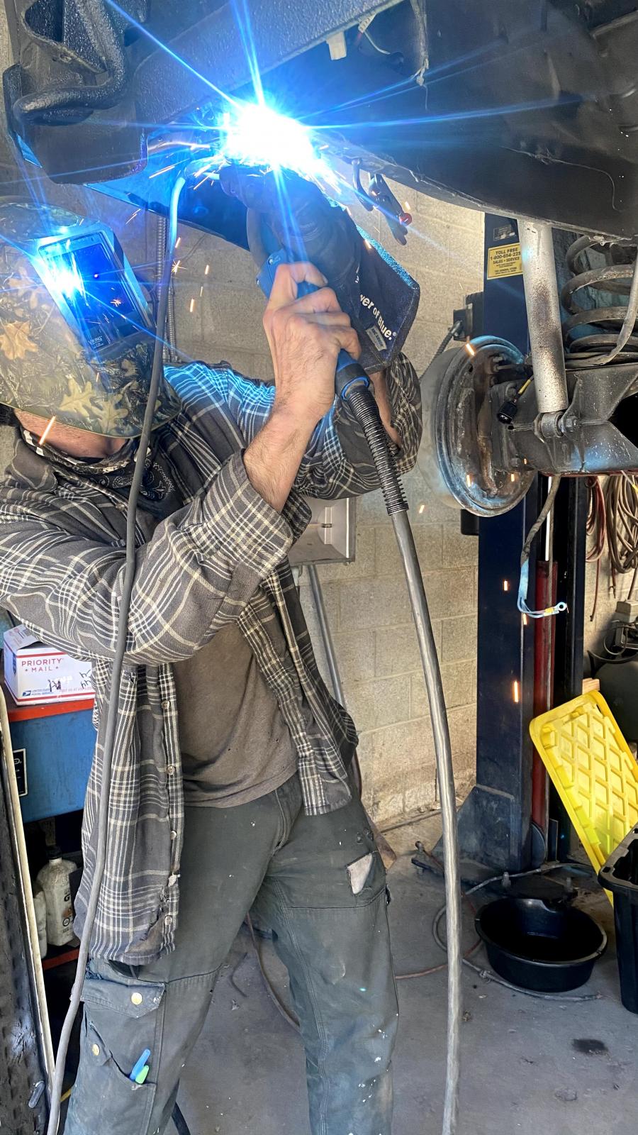

PostPosted: Tue Dec 01, 2020 5:36 pm    Post subject: Re: 1981 (@wileythewesty) TDI conversion, from ground up Reply with quote

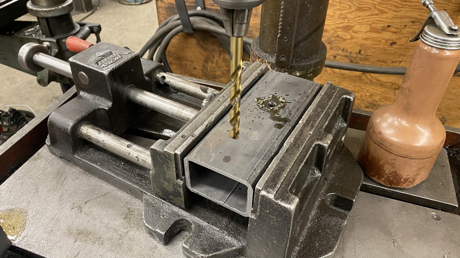

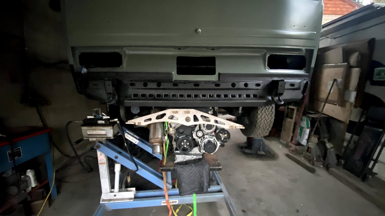

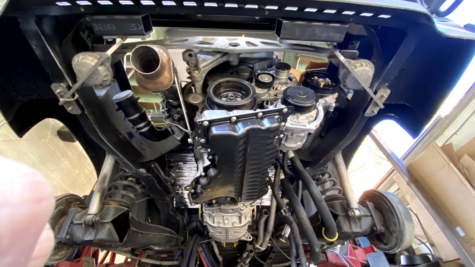

Today i did some drillin' and weldin' to migrate the engine mounts back toward the rear about 1.5".
I added a reinforcing plate to the frame, as I felt that it needed just a little-teeny-weenie bit more than what it had with the original mustache bar
hindsight, while i had the welder powered up, i should have filled the old holes, but whatever. im not always a perfectionist.
I did a test fit with the boxeer engine, and this is where it landed the mounts.
Here are is a pic. It was fun.

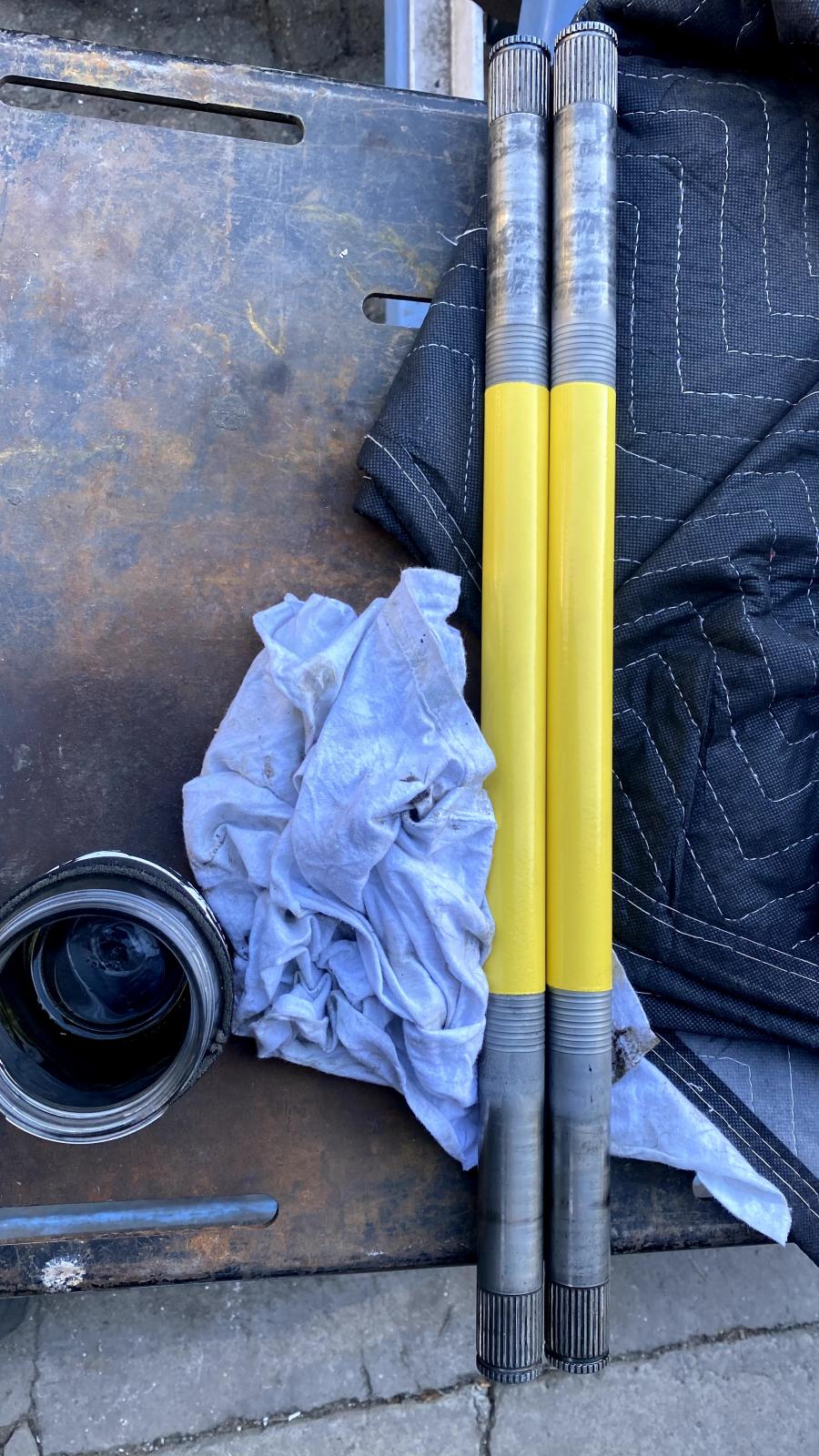

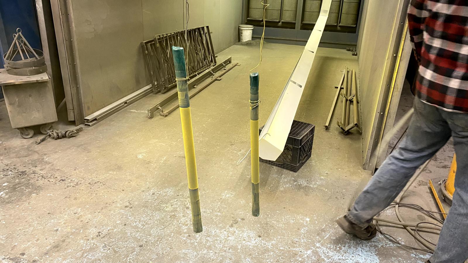

Today I did a little repair on the CVs that were in disrepair...
some pow-pow coating on the rear axle rods to make em purdy:
I left the paint off the boot match area as i figured i didnt want to mess with the tolerances. Powpow is no good with that

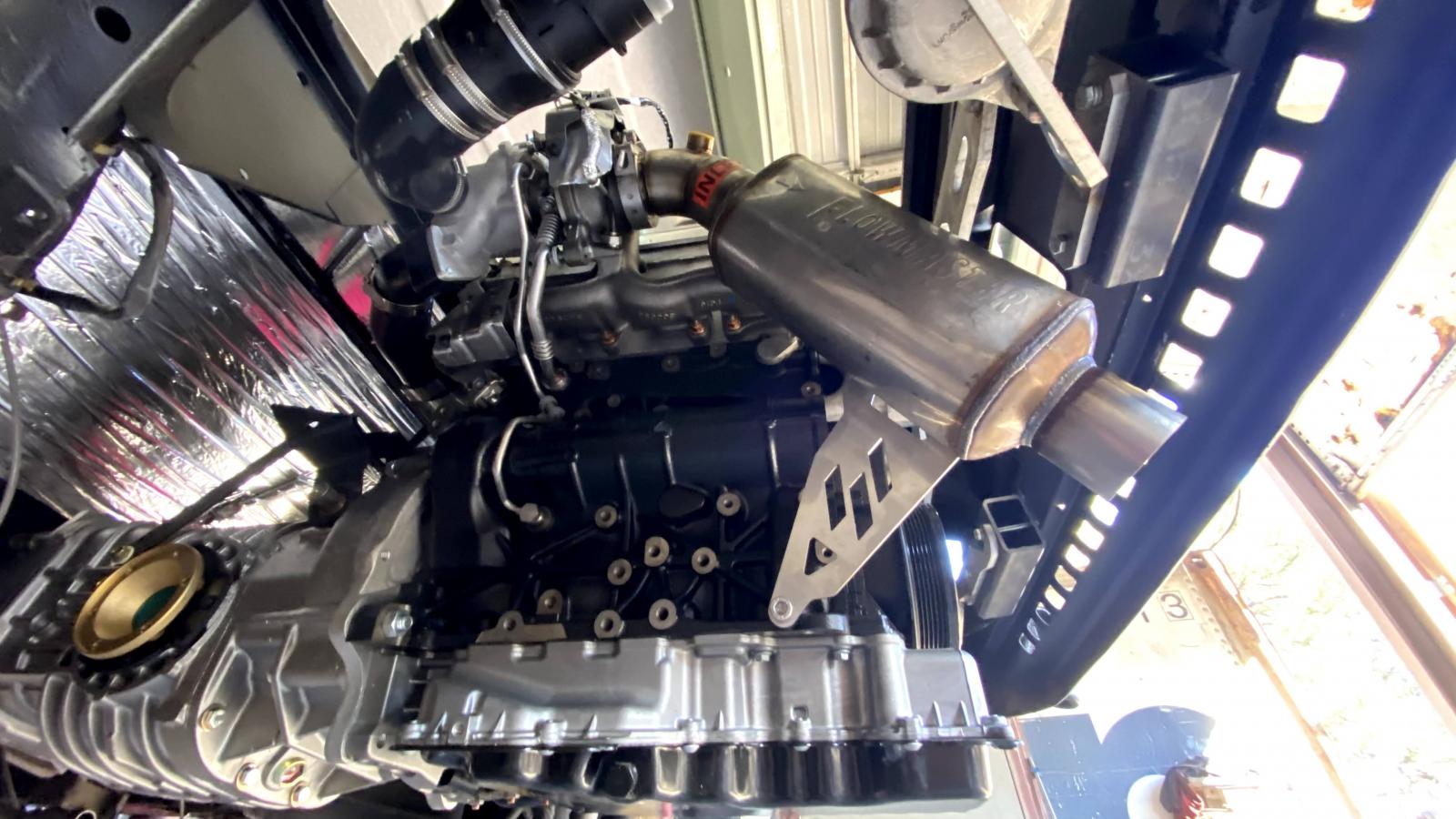

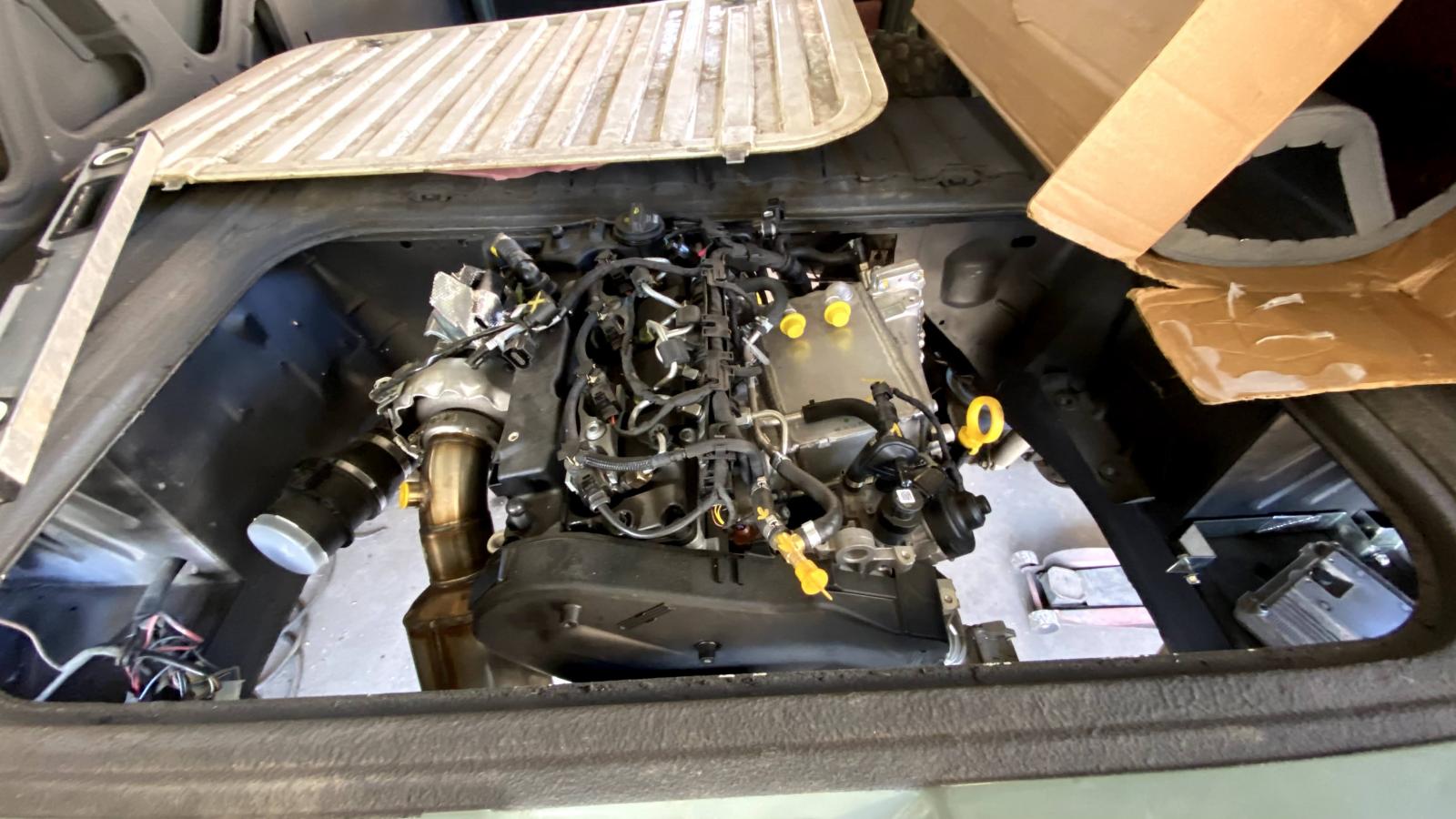

Test fit #1
I put the thing in.
Aircooled 091 transaxle (as everyone knows) pushes the engine forward about 1.5"
Some ghetto mounts (on the left) as temporary spacers. Ill likely be cutting the boxeer SS mounts and extending them to fit the aircooled placement.
heres a few pics next day after i worked outside until 10pm with a headlamp in the freezing tahoe winter to mount this thing solo:

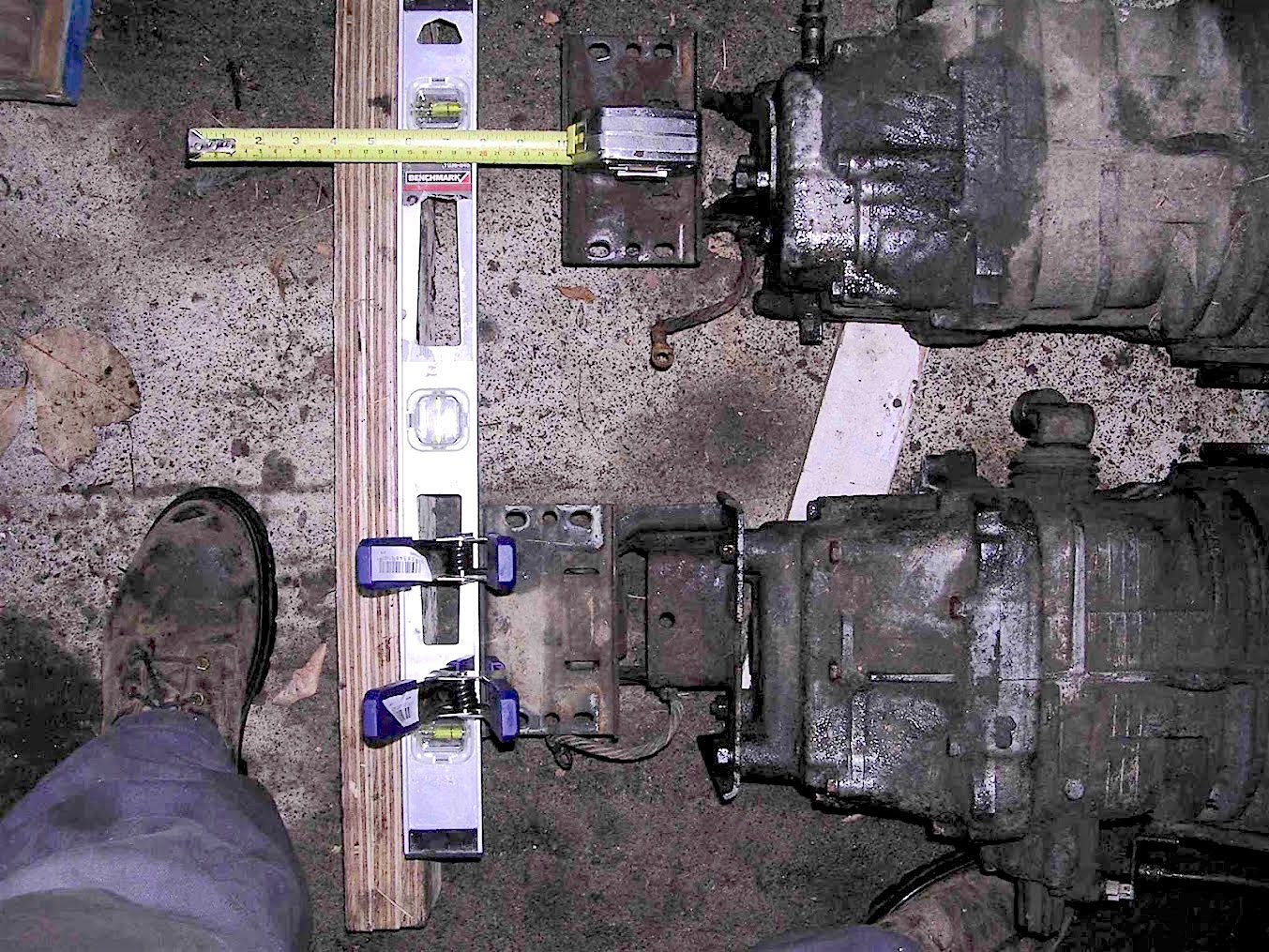

Great to see the fit pics. FWIW, images showing length differences of my old trannies:
air cooled vs wbx front mounts. ~ 1 - 1.5" difference
https://lh3.googleusercontent.com/pw/ACtC-3dtIwpR6...4-h1015-no
air cooled vs wbx tranny. WBX: ~ 0.8" longer. It seems the bigger factor in length increase was at WBX mount stand offs:
https://lh3.googleusercontent.com/pw/ACtC-3exB6oHP...4-h1015-no
Overall, I saw ~ 2.25" difference
https://lh3.googleusercontent.com/pw/ACtC-3elP75Tr...3-h1015-no
https://lh3.googleusercontent.com/pw/ACtC-3cFBfPoN...17-h516-no

those trans pics are awesome. i never had that much context on the sizing differences.
that should be a sticky
