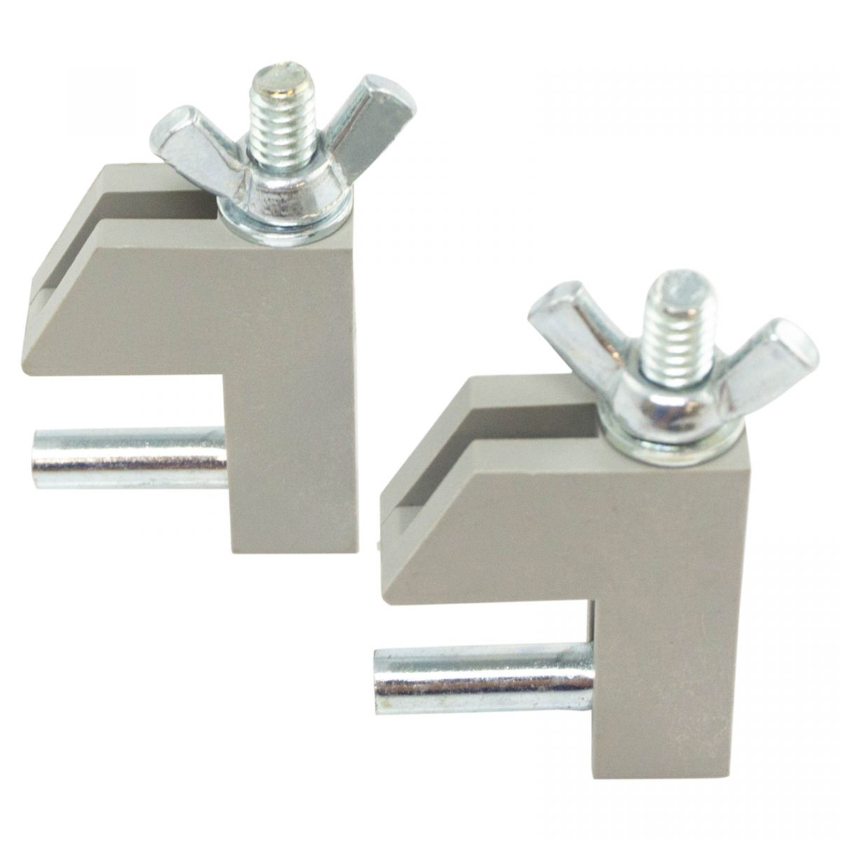

When you get the old filter out, cut it open with a utility knife and see if it is full of rust particles.
Make sure you own something like this. Handy for all sorts of troubleshooting including replacing the fuel filter..
https://am-ebay-images-items.s3.amazonaws.com/item/AM-628398464.jpg
