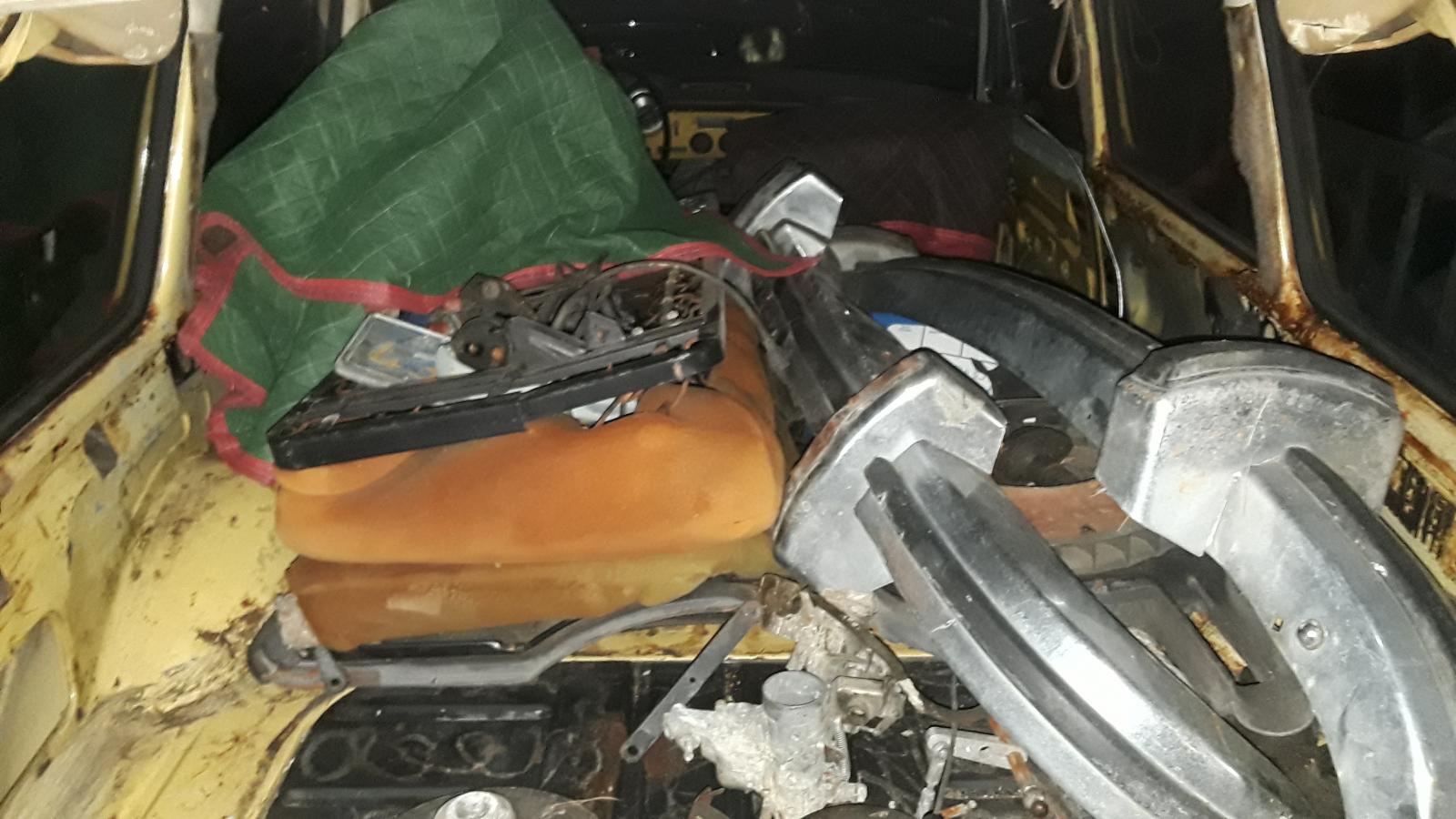

Did some clean up on Sunday, looks like most of the parts are all there except for some interior stuff.

Motor looks OK, some surface rust here and there but it spins freely.
I think all the tin is there but since this is my first I'm not sure.
You guys see anything missing??

Upon further inspection looks like the motor has the wrong Air Deflectors, probably part of the reason he was having problems.
Lucky for me I had a set of OGs stashed away.
I think the only tin left to get are the ones that go over the manifold.

Looks like the entire thermostat assembly/system is gone as well.

Those are the a type 3 pancake engine tins for sure. Not sure what the engine had on it to start with. They are different then the type 1 engine sheet metal.
Oh most important don't throw anything away!
