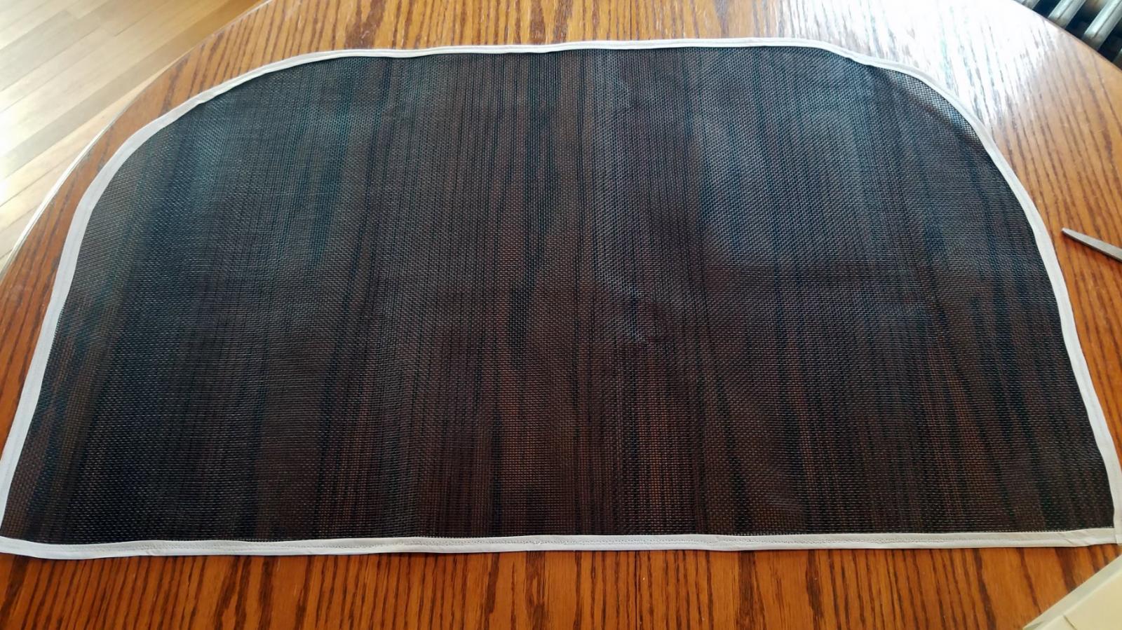

This is my second screen replacement on my 87. The first didn't last all the folding and developed tears in it.
I tried to fix those tears with the peel and stick screen tape but that was a bad look. So, I made another to glue in as I had the first time.
I made a pattern out of cardboard and transferred it to screen.
The Fancher's instructions gives a great step by step if you make or buy a screen from them.
