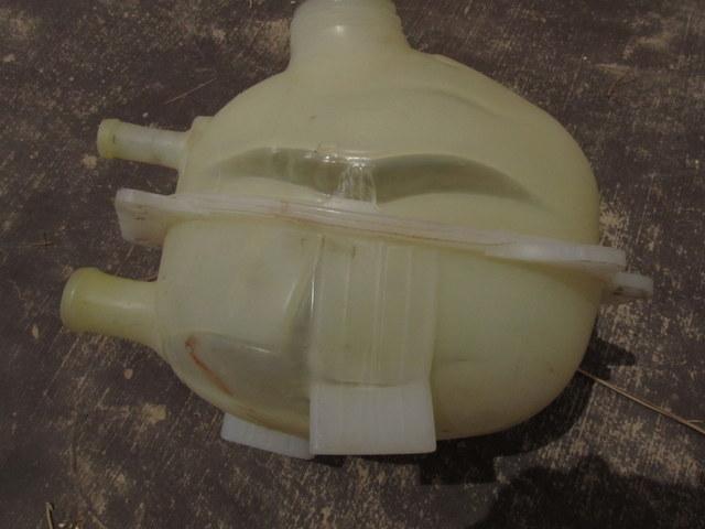

I came way too close to losing a new to me 2.1 engine because the cap blew off a new plastic tank while the engine was idling while I had gone inside to get a something to eat or drink. Luckily the flood of coolant killed the engine so I haven't noticed any damage to the engine. IMO the presently available plastic tanks are junk and should not be used.
Another advantage of the metal tank is that you can get a low pressure 4-7 psi cap for it, which can reduce the likelihood that other aging parts of the cooling system will fail from pressure.

The original tanks got hard and brittle with time and would split, while the recent replacements are too soft and can't handle the heat and pressure.
Note the deformed threads that allowed the cap to blow off. The tank had an ~ one year old Bleu cap on it. The fan switch which seemed to have been working normally when I went inside apparently failed just as I walked out of sight and let the engine begin to over heat.
