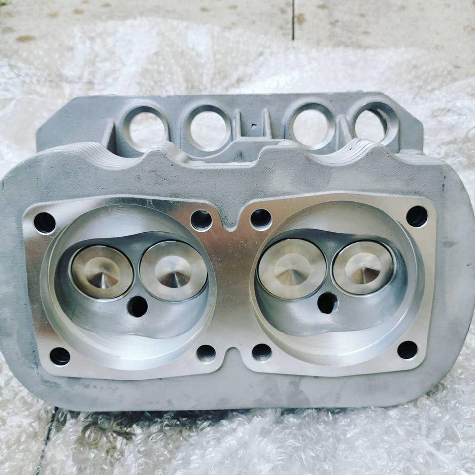

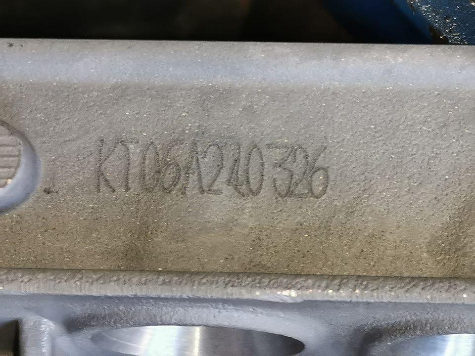

Just saw a post on FB that called into question the authenticity of some advertised AA heads. Upon receipt of the heads the usual AA markings were removed and a new 'classic line' logo was etched in its place. The person purchasing the parts contacted the vendor just to be told 'they are from the same factory'.
Im wondering if these are rejected seconds or clone.
Anyone have any experience with this product line?
The red flag for me is the milled casting identification numbers. Like the 049 heads that were rejected by RM quality control to then have the ID removed and then resold by empi. Seems like a lot of back door deals coming out of china

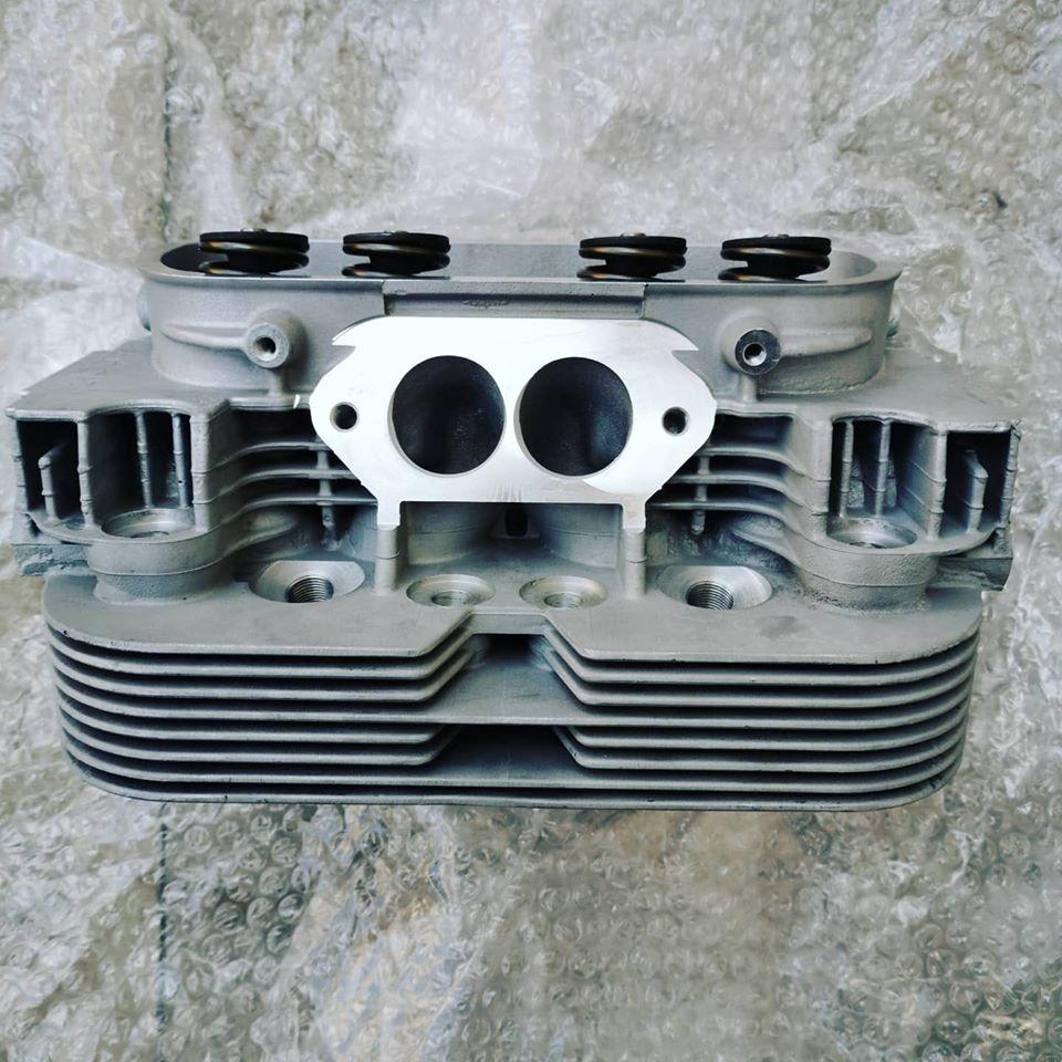

It's not an AA500 casting, the intake ports are different, and it has two cooling fins by the exuast studs, and it has siamese first cooling fin instead of one thick one, so, clearly it is not a AA500 casting.
Bugpack and Empi had NEW heads too,
maybe they are made made in the same factory? Think

They are AA knock offs. - An earlier design as I understand it. The heads themselves are reasonably OK. I don´t trust the guides, valves and springs for anything serius. Out of the box the valve to guide tolerances are often close to "worn" In the stock valved version the intake port volume differ a lot from head to head. Some are OK, some have WAY to much port volume, which results in sloppy performance. They are sold by the dozens in other parts of the World where the currency is not as strong as "ours"

They match the pictures YOU supplied of, the "502" head.
On page three of YOUR sticky
With the exception of the spark plugs. However that is a mater of machining, not the casting itself.
It is surely the same Dies (aka molds, except, die casting)
AlteWagen wrote:
Sad 502 No longer in production. 40x35, 14mm short plug, heart chamber, solid chamber, 3 full fins.

Good catch! I got my 502s directly from Johnny (AA sales rep) right at the time they changed foundry for the 501/502 back in 2011-2012 while working at a local speed shop. They stopped production of the 502 at that time as the improved 500 casting (with extra material at the port flange) was released.
This makes complete sense. The 501s I have were the ones with the 'dropped port' issue which made the port floor extremely thin and had a pretty severe dogleg. Dont remember why he said they changed foundries, maybe they kept the prototype molds and continue to crank them out.
One other question, is that auto group based in denmark?
Johnny was the one who told me of all the back door 'brown box' specials that happen in china. All those pistons that AA rejects in QC end up being sold to the public by the manufacturer once any identifying marks are removed. If you ever see a AA product in a brown box with markings removed you better pass on by.
This happened to RM and look what happened, they no longer offer their product. Id be pissed if I took my product to be manufactured somewhere and then they sell it out the back at half the price.
What you are saying is exactly my point. Same factory different sticker? Lets take Autolinea for example a few years back they produced the VW 043, CB 044 and the GO1. Same factory,3 different products with VASTLY different quality standards. When I got my 501s and 502s AA had the bare castings imported and finish machine work was done at Brothers. Not sure if that is still the case but according to some other recent threads on FB the quality has dropped a bit on the genuine 501s as well.
https://www.facebook.com/groups/1529589444006140/p...3483430394
The crack between the seats is typical on 44x37 but the guide clearance is real bad.
The industry is very incestuous and its obvious that some of the players are irritated when the curtain gets pulled back on all the shenanigans.
