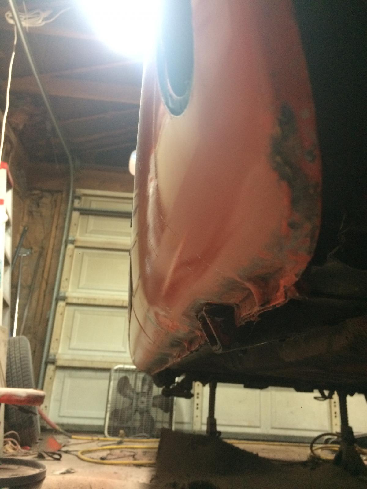

PostPosted: Sat Feb 24, 2018 6:06 pm    Post subject: Re: 1972 Internet buy Reply with quote
Rockers look amazingly solid. Drain holes on the bottom surface are supposed to be there; you really are lucky. Maybe drill a hole in the front and rear faces of the rockers in the wheelwells and spray a rust-preventative paint or wax in there with a long wand, to prolong them.
Left headlamp bowl and seal lip also look really good. Is the right bowl and lip also good?

PostPosted: Sat Feb 24, 2018 6:23 pm    Post subject: Re: 1972 Internet buy Reply with quote
I hope they're solid,we'll see. Good idea on the rust preventive. Here's the right side headlight bucket after I removed the mud, has some accident damage
