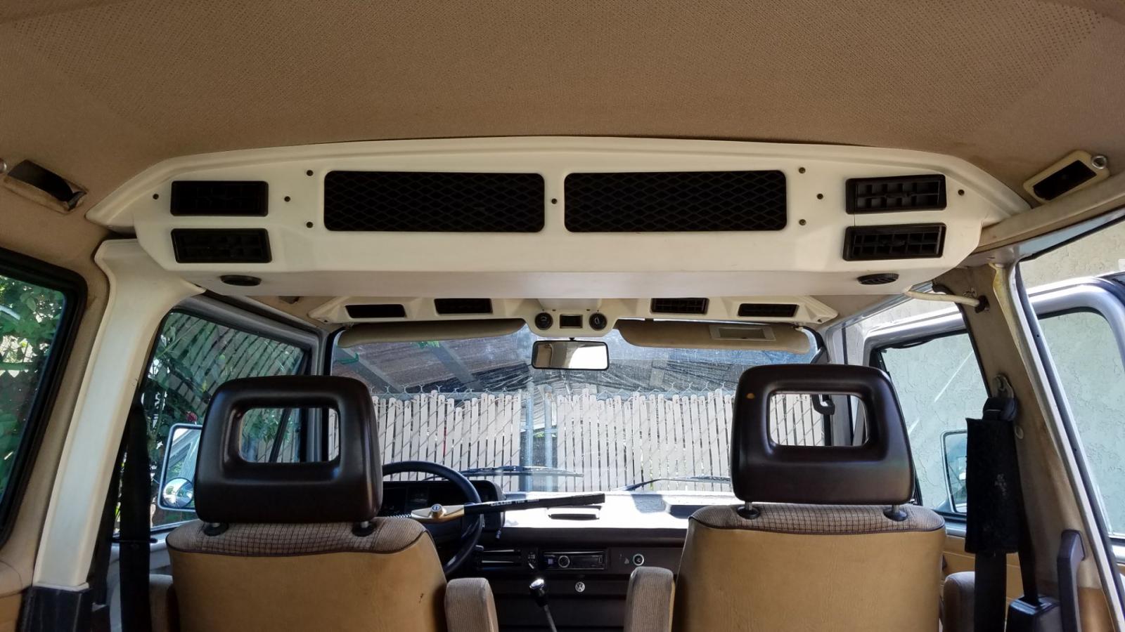

Thanks for the info. The reason I'm asked is that a previous owner on my newly acquired 85 installed some later parts (rectangular HL's & grille, rear windows with vents - 89?).
Also, this van has air conditioning, but it does not have the center overheat duct running down the middle of the roof as my 87 syncro did. It has a dual "boxed-in" section of ducts over the driver & passenger seat, and no ducts aft.
Was that normal for an '85 tintop with AC?

PostPosted: Tue Jun 30, 2020 4:12 am    Post subject: Re: Looking for a list of standard and optional equipment Reply with quote
There was an after market kit that had the evaporator and vents above the cab.
Lines ran up the B pillar.
Post a photo of yours to help verify the design.

PostPosted: Tue Jun 30, 2020 5:05 pm    Post subject: Re: Looking for a list of standard and optional equipment Reply with quote
Looks just like that. Was it a dealer-installed system?
Why not select the AC option box when you originally bought the van?
