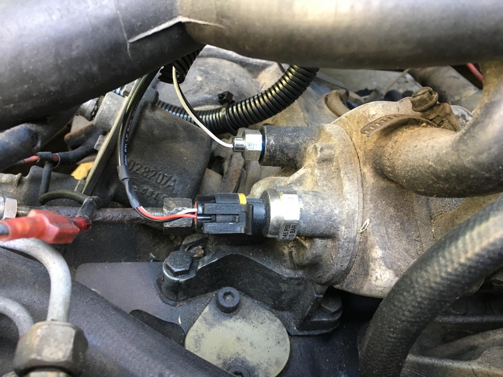

Hi All,
The AAZ head on my engine has the 3 sensors in the photo below:
Is this engine supposed to have the dual-oil sensor dynamic oil pressure warning system? There is a second sensor above the oil filter mounting, but it's not connected to anything.
My coolant temperature gauge is only working intermittently. I am going to crimp some new connectors on those two wires, since the current ones are rather chewed up, but is there anything else I should check? Is this actually a legit set up for AAZ coolant sensors to drive the Vanagon coolant cluster gauge? Why are there two of them?
Thanks for any advice.

PostPosted: Sun Jun 23, 2019 8:20 pm    Post subject: Re: AAZ oil and coolant sensor questions Reply with quote
The two coolant sensors are the same part 049919501 that feeds both the dashboard gauge and the glow plug timer. The difference in their function, though slight, is in their location on the head. I would guess that the upper sender on the outlet flange to the radiator feels the hottest and that is why it feeds the gauge. So for most accurate readings the yellow/red wire should go on the outlet on the side of the head.
Coolant temp sender (circuit 32) on side of head outlet is yellow/red.
Glow plug heat sensor (circuit 14) screws into the heater outlet on back end of the head is black/yellow, (diagram says blue/white).
Oil pressure switch (circuit 29) on back of head is blue/black.
To test the gauge I used a needle to pierce the insulation on the yellow with red stripe wire that enters the instrument cluster (position 6) and ground it with the ignition on. That immediately caused the temp gauge to quickly head for the hot end of the scale and the red light to start blinking.
The AAZ oil sensor came on the engine so there is nothing to connect it to on the Vanagon. I put an oil temp sensor in there and a gauge in my cluster.

PostPosted: Mon Jun 24, 2019 6:24 am    Post subject: Re: AAZ oil and coolant sensor questions Reply with quote
Thanks for the reply Gnarlodious. I think those circuit tracks you listed are for your '83 and not my '82, but it got me pointed in the right direction.
My early Bentley (only goes through 1987 MY) has:
- ENG TEMP SNDR (PRE-GLOW SYST) on track 17 with a blue/white wire
- COOL TEMP GAGE SNDR on track 34 with a blue/yellow wire
The photo above is shot looking down at the part of the head closest to the transmission, so the coolant sensors are located on the passenger side/driver side. When I first looked at the wires, it seemed like they were both green/yellow, but after some scrubbing, I think the upper wire in the photo (passenger side) is actually blue/yellow, so that should be the gauge.
That said I have no idea why the other wire is green/yellow. I'll see if I can trace that that wire.
The oil pressure is on track 31 with blue/black wiring, similar to the '83, and that seems to work okay. At least the red light comes on at ignition 1 and goes off a few seconds after the engine starts up.

PostPosted: Mon Jun 24, 2019 7:59 am    Post subject: Re: AAZ oil and coolant sensor questions Reply with quote
Looks good but just a warning on that Glowshift oil temp sensor, it can bottom out and eventually crack the thin metal and start leaking oil out the potted wires. I measured with a depth gauge and used a thick crush washer under it so it seemed like it had clearance but it started leaking about a year later. I had to replace my sensor and put it in the taller tower which has more depth, so you may want to swap them proactively.
Also you might want to know that Glowshift has sold two types of temp sensors. The newer one uses industry standard “10k thermistor” resistance. The different sensors are not compatible with the display unit. If you do ever need to replace that sensor the type is marked on the hex surface in writing I can’t really read from the photo.

PostPosted: Tue Jun 25, 2019 12:09 am    Post subject: Re: AAZ oil and coolant sensor questions Reply with quote
I have to say, you have 2 different water temperature senders on this outlet.
Usually there is 1 sender 049919501 on each aluminum flange for the early diesels: white/ blue wire for the temp gauge on the heater outlet flange on the cylinder head (facing forward) and yellow/blue on the flange by the injectors. Often it has 2 yellow/blue wires on one spade crimp there.

PostPosted: Sat Jun 29, 2019 6:57 pm    Post subject: Re: AAZ oil and coolant sensor questions Reply with quote
I think it's just photo angle weirdness, because the temp sensor is definitely in the taller tower. That's the one further to the back in the picture. I'm pretty sure I noticed the same thing you did about the length of the temp sender and the depth of the port and guessed right the first time. (crosses fingers)
Thanks for calling it out though.
I got the gauges all wired up and around town the oil pressure seems to run between 20 and 65 PSI depending on oil temperature and RPM. I haven't driven it enough yet to get a good feel. I hit 205F on the temp, but nothing higher yet. I'll have to take a longer drive on the highway soon to get a better sense of what's normal for this engine.
The boost gauge in the Glowshift 3-in-1 is also working, and I'm topping out at 4-5 PSI boost driving around town. The EGT sensor is not tapped in yet.
The Glowshift gauges are rather blingy. I'm not really a fan of that aspect of things, but they were relatively inexpensive and are working okay for now.

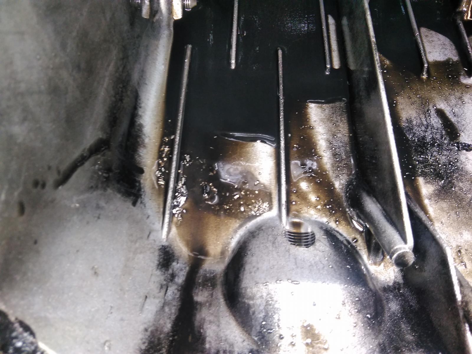

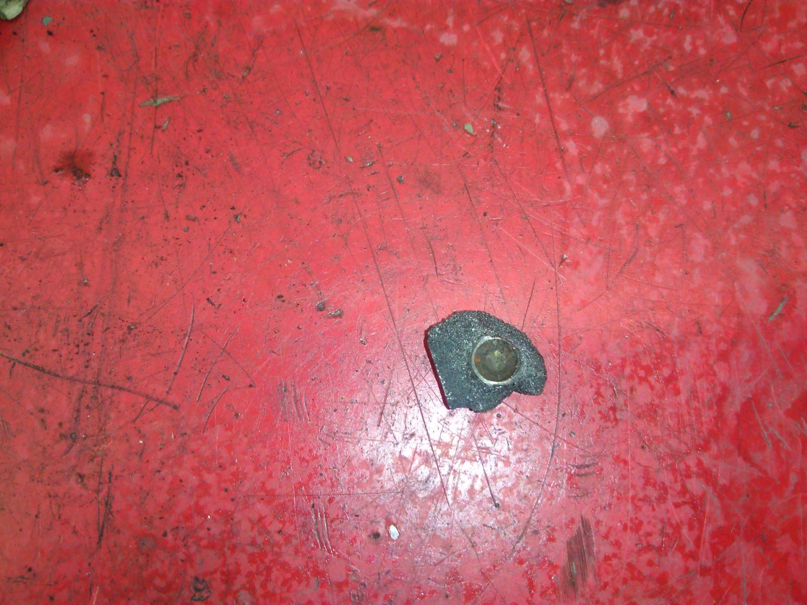

PostPosted: Sat Dec 21, 2019 12:02 pm    Post subject: Re: AAZ oil and coolant sensor questions Reply with quote
So, good news/ bad news:
Dropped the oil pan, and swapped out the oil pump.
Light still burns.
Plus, a bunch of other sadness;
Skid-plate Rust:
Swarf in the oil pan:
Fussy rare earth magnet from oil pan:
Found this little gem tucked away in the corner:
And where it came from:
And lastly, found this in the old pump screen:

You might want to check the intermediate shaft bearings. They often disintegrate like that and cause low oil pressure. If you have the later AAZ timing belt tensioner with integral tension gauge, then you can blame that. If you have the earlier solid tensioner, you can blame yourself or whoever installed the belt for putting it on too tight and trashing the bearings. Injection pump shaft bushing might have been damaged also. You might want to track how far that crack in the block goes and maybe drill it off to stop it growing. You also might want to put sealant on that one bolt that was too long so it doesn't weep oil.
Sooo...where's the good news?
...um, it doesn't leak oil at the moment?
