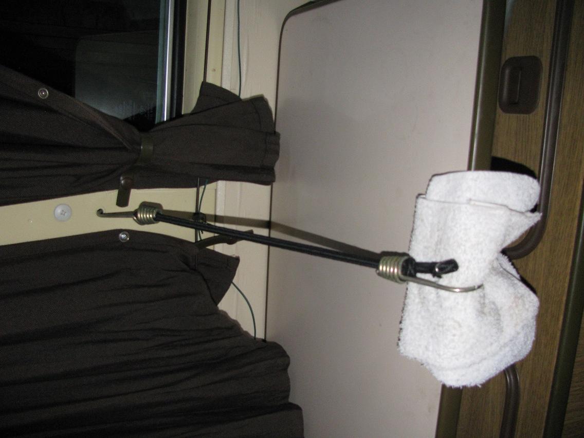

PostPosted: Wed Jun 10, 2015 9:17 pm    Post subject: Reply with quote
I have been using a long bungee cord that hooks from behind the stove side cabinet grill to the back edge of the closet cabinet by the side window. Hook the bungee in front of the table and it's good. I also use the smaller front table in the back.

BitterBeerFace
Joined: June 11, 2010
Posts: 386
Location: Southern MN
BitterBeerFace is offline
PostPosted: Wed Jun 10, 2015 10:01 pm    Post subject: Reply with quote
Forgive the rotation...
1980 Full Camper, been in the family since it was brand new!
