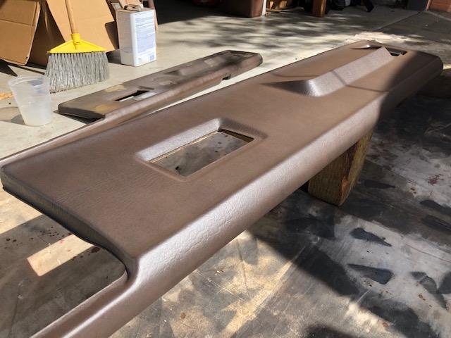

I've done the color change.
Here's my write up on how to do it and some photos of how it turned out.
https://www.thesamba.com/vw/forum/viewtopic.php?t=735299&highlight=

felixbobcat
Joined: December 13, 2017
Posts: 172
Location: Los Angeles
felixbobcat is offline
PostPosted: Sun Jan 10, 2021 11:59 am    Post subject: Re: Experience Painting a Black Padded Dash to Brown? Reply with quote
I did use SEM Paints and Prep. Looks great after 10 months.

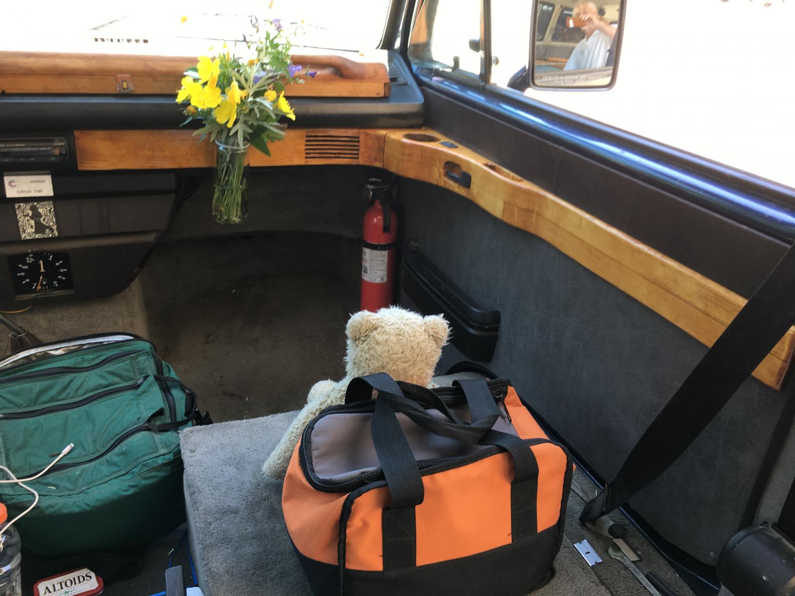

PostPosted: Sun Jan 10, 2021 12:40 pm    Post subject: Re: Experience Painting a Black Padded Dash to Brown? Reply with quote
djkeev wrote:
There is a product available called SEM Color Coat .....
https://www.semproducts.com/product/color-coattm-aerosols
This is a very good product but can you find the brown you want?
Dave
I've use the SEM Color Coat on a door pocket where a section was cut out for speaker clearance by a PO. I made a patch from black plastic and used JB weld to glue the patch in and then painted the bottom of the pocket and the inside of the pocket with this SEM paint. I painted the bottom of the pocket without taping off the side and the color is strikingly close and I cannot tell where the new paint fades into the reconditioned brown plastic. In certain circumstances (materials, lighting, etc.) I'm sure some could tell the difference, but it's a good match to my eye.
https://www.gowesty.com/product/paint-prep-/4474/interior-paint?v=
The lighting changes in this photo, because the angle of the surfaces, and I literally cant take a photo with both the side and bottom in the same light.
Jim Davis

felixbobcat
Posts: 172
PostPosted: Sun Jan 10, 2021 1:20 pm    Post subject: Re: Experience Painting a Black Padded Dash to Brown? Reply with quote
SyncroHead wrote:
Felixbobcat: THANK YOU! I had not found your post in my previous searches which looked for "paint" in the subject field.
This gives me great encouragement to try this. I'll also use the SEM Vinyl Prep product as well. I've used the SEM Cordovan Brown (#15023) on a door pocket and the color match was great!
An odd thing I noted in your post: SEM makes a color named "Bluebird Brown". Laughing
Thanks again for pioneering this.
Jim Davis
Hi Jim and Thanks!
It has really worked great for me so far. I think the the real key is in the prep like with any paint job. The SEM Vinyl Prep is absolutely necessary plus I was also able to do it on a warm day, not always possible this time of year depending on your location.
Yes Bluebird Brown is an odd name but it really helped in creating real depth into the paint job. It's a nice lighter brown that helps offset the darker Cordovan.
I also found that by starting with a deep black background created the perfect base color to start with that's why I restarted and gave it a coat of black.
I've used SEM on other cars and it is amazingly durable paint.
