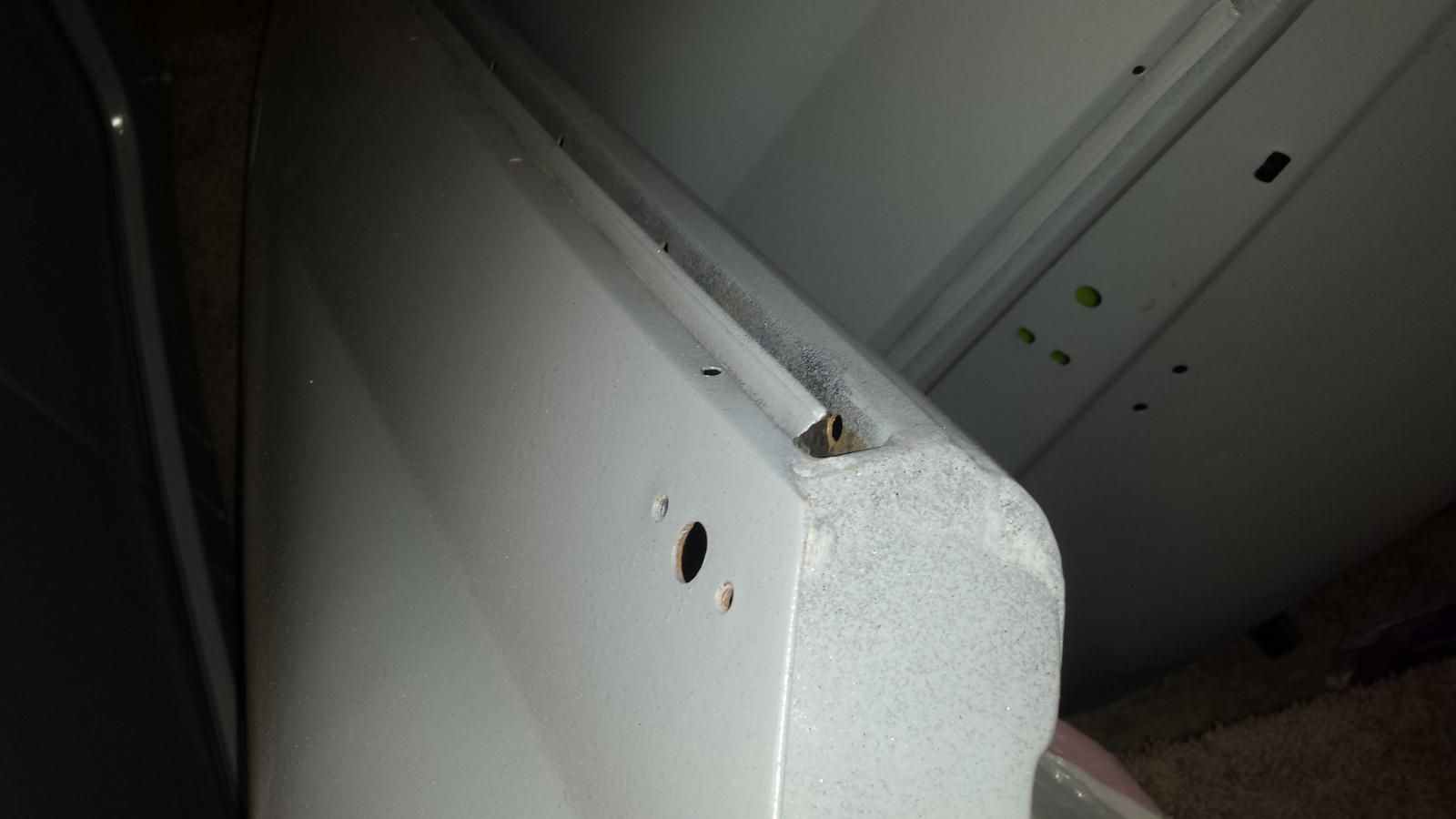

The colored part is missing on my ghia on both doors. What exactly is it called. And is it avail new?
I'm having difficulty identifying it on the parts manual.
Thanks!

I think it's the metal of the door - inner door skin.

On my 71 it's a strip spot welded to the door. I doubt you will find a replacement part number for it since it appears to be a part of the door.

Does anyone have any measurements of that part -- total height and height that protrudes above? I can try to recreate.
Or, I'll have to look for someone cutting up a car.

For my 1971 Convertible:
31 & 1/16 inches long,
1 inch tall BUT it has a 1/8" fold over seam towards the outside of the door,
Rises 7/16" above the door
Make sense?

Thanks! That does help! That bead formed by the fold-over is probably important to holding down the rubber strip properly.

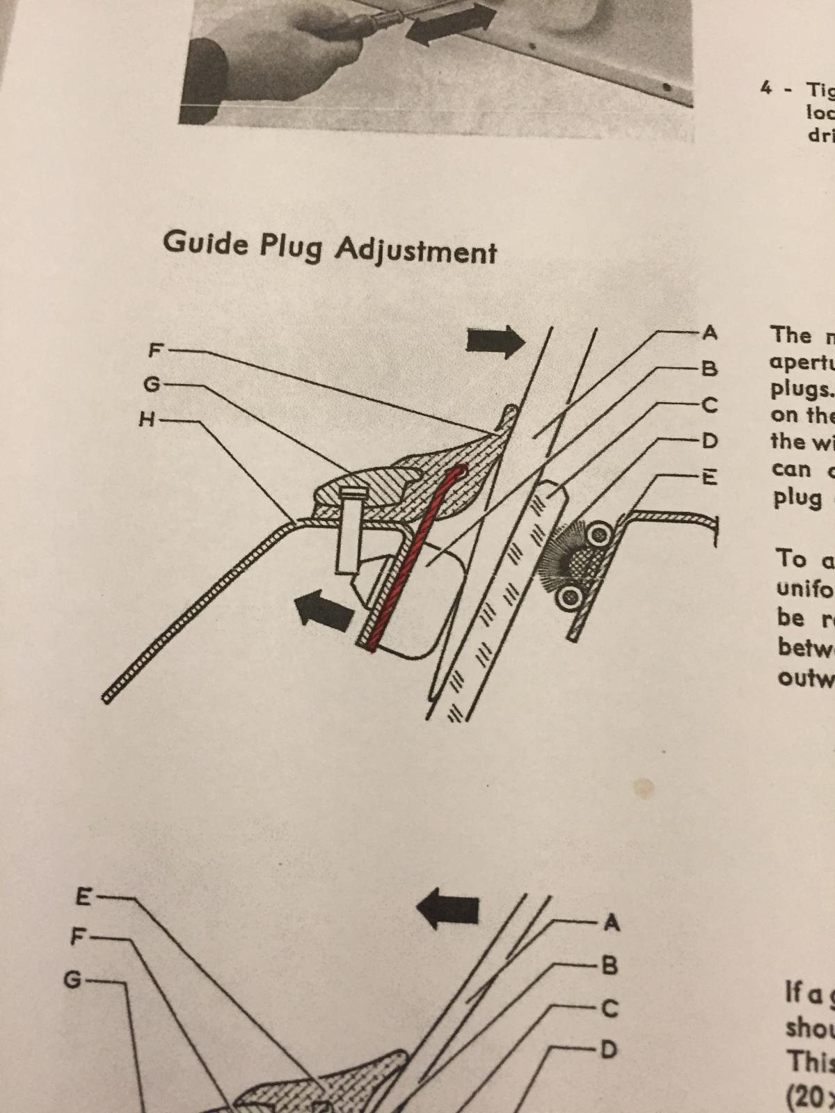

The rubber is held down by 5 or 6 expanding clips (kinda like those that hold door cards on) that hook to a channel in the chrome trim and then down through the rubber to hold it. Several differences in doors over the years. This thread should help.

What is "A" in the diagram?? C is the glass correct?? I think mine needs an adjustment.
Just a guess on my part but in that diagram, "A" looks like it might be a tool used to adjust the position of the guide plugs. Maybe by wedging it between the glass ("C") and the plug, you can spread the sheetmetal a little and gain a bit more clearance if the windows are tight and difficult to roll up & down.

xzener
Joined: June 03, 2006
Posts: 1778
xzener is offline
PostPosted: Fri Sep 07, 2018 2:50 pm    Post subject: Re: Door window scraper question Reply with quote
My issue is the rubber doesn't press against the glass in a couple areas.

PostPosted: Fri Sep 07, 2018 3:05 pm    Post subject: Re: Door window scraper question Reply with quote
Have you tried bending the subject piece of metal towards the window.
In looking at mine (disassembled) it looks pretty wavy. I'll straighten it out before assembly in 6 months or so.

Turns out these metal strips are available.
Through Wagner-Blachteile:
https://www.wagner-blechteile.de/produkte.html
