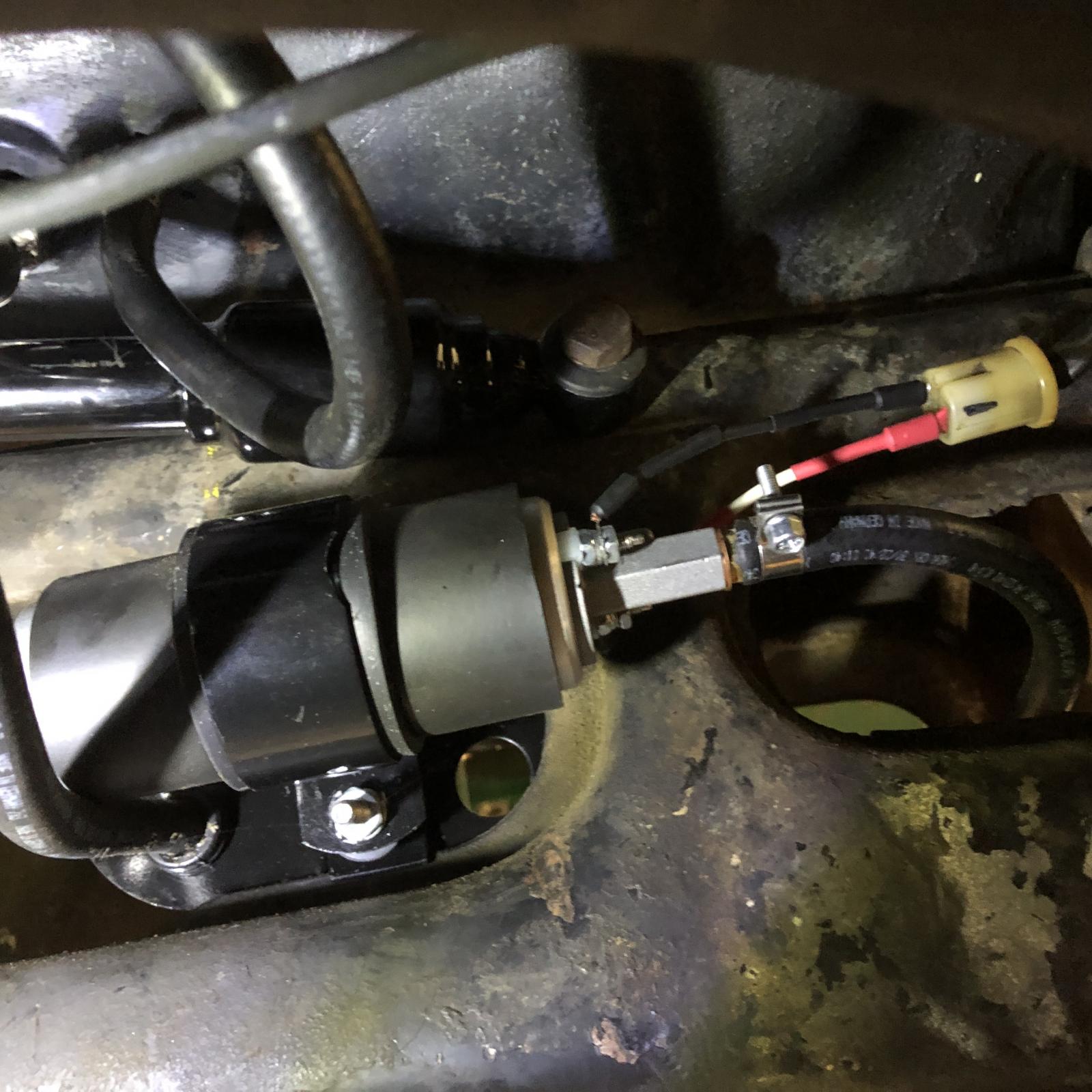

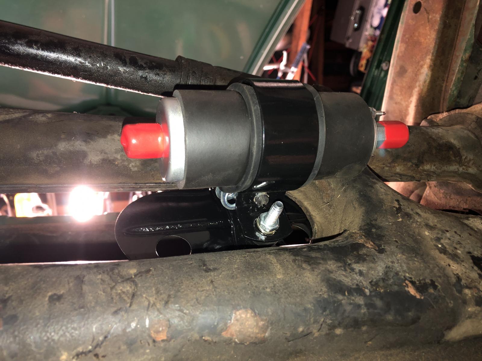

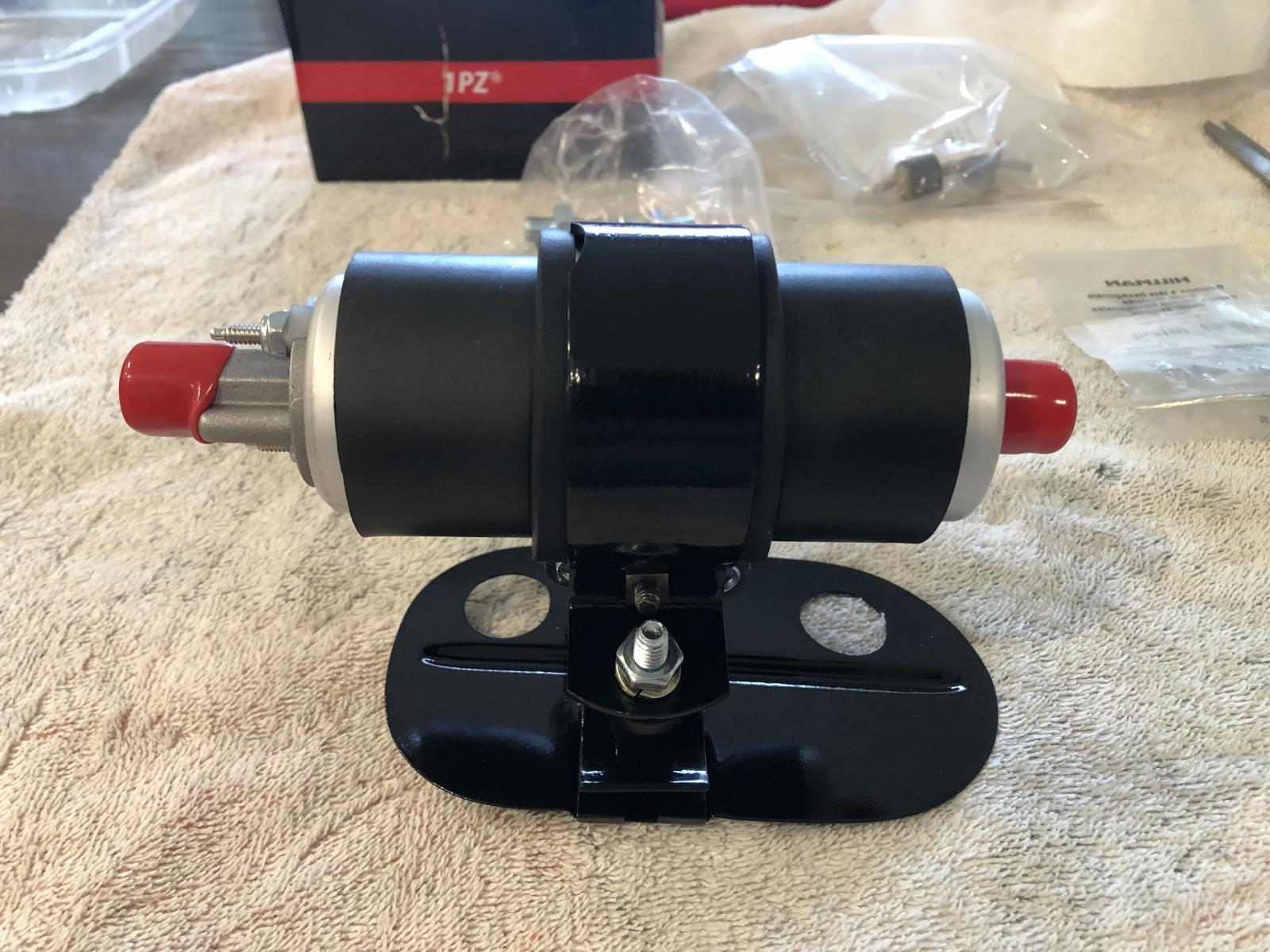

As mentioned above, the ford ranger external pump (located on the truck's frame rail, not inside the tank) is an ideal replacement. If you can't find one locally, grab one of these, like I did. Note that the original fuel pump has three ports, one to feed the fuel loop, one that loops into the return line and back up into the bottom of the tank, and of course the inlet port, coming from the angled tube beneath the tank. You will need to remove the 3-way "Y" fitting and eliminate the hose that was routed directly from the original pump back to the tank.
I've included photos of it mounted on the original plate, and back onto the beam. The center of the beam is a better location than the original mounting place towards the outer end of the beam due to the locations of the input/output ports on the new pump. The space is too tight to connect fuel line placement to these ports if left in the original mounting location on the beam.
