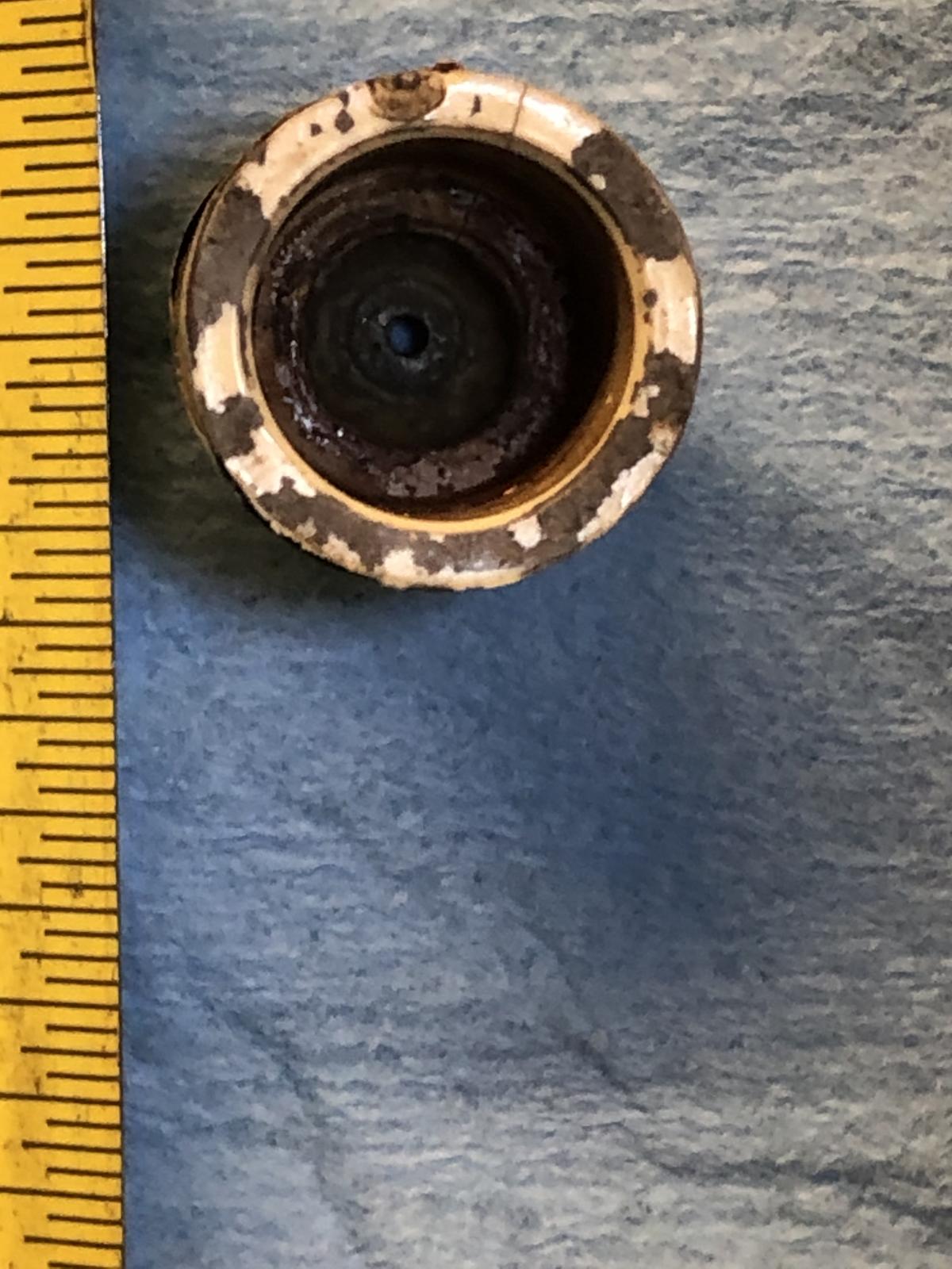

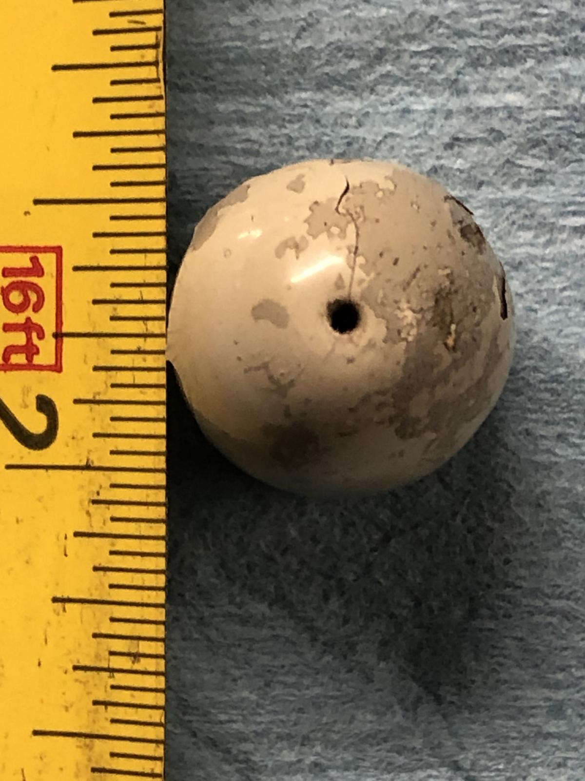

The hinge was changed out for one with threads if the car wasn't fitted with one with the threaded one. I've done it once, I had to hire a VW hinge pin removal tool to do it.
Thanks for the part numbers harrymarlin. Does your bug have the thread sticking out for an accessory mirror, or no thread so it needs a plug?
I have the original cap for my RHD 65 Sedan, pics of it below, I intend on repainting it. I have seen both hinge pins with threads for the accessory mirror, and ones without. For a 1967 convertible I have no idea, but from what you wrote above I would think so. This is the cap, hope it helps, although of no use to you if you need a plug:

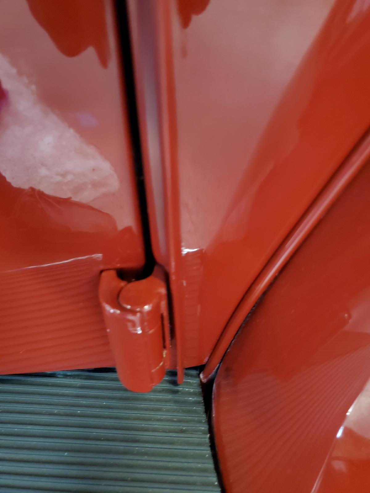

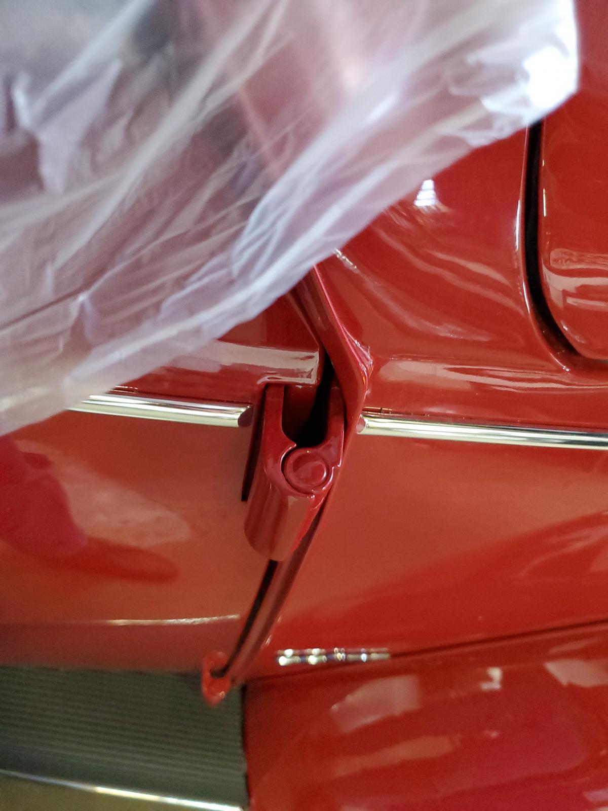

I finally got a chance to look at my hinges, and it looks like they don't need caps (I'm not sure how I got so confused!). They are as 61SNRF noted, above. Thanks for all of the responses! Now I have some hinge caps I don't need. Wink

For what it’s worth my UK market ‘67 base model (1200) has the hinges with the little plastic caps (and no slot in the hinge itself for oiling) on all but the drivers upper hinge (because the slot is needed there for the threaded pin). My hinges are all original. It shipped with only a single mirror (drivers side) hence no slot on the passenger side upper hinge, nor one of those threaded caps.
The black plastic caps had been painted over on all the other hinges as I’d imagine is quite common, but in reality they are designed to be removed so you can drop some oil on the top of the hinge pin (it is recessed by around 5mm) and then replace the plastic cap.

PostPosted: Fri Dec 04, 2020 1:26 pm    Post subject: Re: Hinge cap, plug, or cap nut? Reply with quote
cb1990s wrote:
However before you anything like that just check that the hinge DOESNT have a slot in it for oiling - if it doesn’t have the slot then it’s got a plastic cap on it and in theory you should remove the paint on top and then you’ll see the little cap that clips in and out for oiling the hinge.
Thanks cb1990s! It looks like all of my hinges have slots, so I guess I don't need the covers/caps I thought I did. I appreciate everyone's information in me getting to this understanding!
