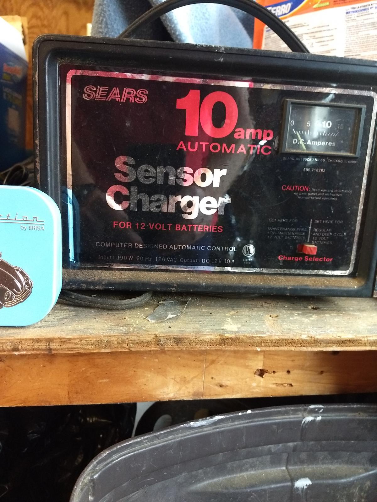

I inherited this charger and I imagine that I imagine was made in the 70's. It's been sitting on the shelf since I got it as I have another much newer one.
My question is - would you still trust it to use it?
I didn't want to use it/give it away/sell it if it's outdated and shouldn't be used.
It's in good shape - no frayed wires, etc.

A batter charger is not the same as a batter tender. One is designed to charge a battery that is dead while the other is used to maintain a battery that is not being used.
It's probably OK to use for it's intended purpose.

I’ve had one like that for over 25 years.

Yes I sure would. We have an old Diehard at home from Sears it seldom gets used my dad bought it new in 1983 works like a charm and it lived most of its life outside because we don’t have a garage. But I always bring it in for the winter.

This charger was made by either Schauer or Woodward-Schumacher for Sears. It has the Sears logo that was used starting in 1984, so it's no older than that.
These work great if your battery has gone dead from sitting for too long and you want to give it an overnight charge in the garage.
Too bad it doesn't have a switch for 6-volt charging.

Absolutely!
A great charger! They don't make them like this any longer. Use it and treasure it.

why do you think it will not work?
just because it is old
does not make any difference if that was the case then through you old VW away

Because technology changes, I'm not mechanically knowledgeable about these things and I know that there are folks on here that are.
Thanks for everyone's input. It's a keeper.

No joke i have the same exact one if not nearly identical. works great. It was stored in a barn until i inherited it.

Lead acid batteries, none of the new fangled stuff, different internal resistance.
To clarify....... use only on
FLOODED lead acid batteries.

I assume by "newfangled" batteries, you people mean stuff like Optima.
For my batteries, I've used my 1970s era Schauer charger for decades, typical Interstate, Autozone, O'Reilly batteries.

its better thaqn the modern chargers that wil not charge a dead battery....for some reason...I use battery chargers to charge dead batterys, the batterys that arent dead dont need charging...go figure.

Yes! Use it, it's a keeper for sure! I scour garage sales for those old chargers for the reason stated below.
Modern chargers Mark are designed to be idiot proof. That means they are polarity protected so that the average idiot cannot reverse the polarity and plug it in causing damage to the charger, battery and possibly the idiot. So they need to sense polarity before they will give an output. If the battery is dead or very close to it there will not be a strong enough polarity feed back to trigger the sensing circuitry and allow the charger to output a charge.
Yes hook a stone dead battery in parallel with one that has some charge with the charger on both for a while and the dead one will come up enough for the modern charger to recognize it as a legit polarity and charge it on it's own.

I have one like it but it has 6/12v switch
it's a great old unit, i'd use it without hesitation
