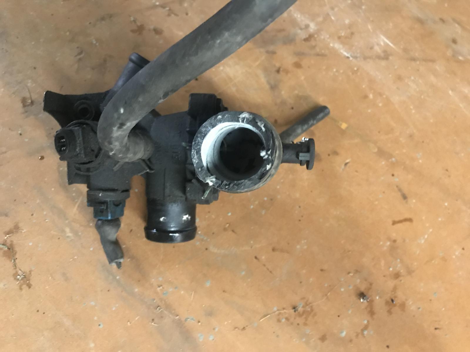

You are off a little on the small bleeder hose at the top of the thermostat cover. That has a manual valve that is intended to be opened only during cold filling and bleeding.
This lets trapped air escape as the waterpump fills the radiator return pipe and hose after it first fills the radiator

I didn't know that upper thermostat bleed hose was hooked to a manually operated valve. I know the valve was there but never had need to bleed it. I always thought it would just dribble past the threads as the radiator bleeder screw does.

Let's look at the thermostat housing.
It mounts on the front left of the engine, it is partly in the engine area and partly behind the firewall towards the transaxle.
Here it is bolted to the engine ......
This photo is what you can see in the engine area. The small hise with the silver clamp is the bleeder screw bleed Hose.
This small hose goes up and connects to the bleeder ring mounted high in the engine area.
The black circular disc you see is the bleeder valve. It is normally closed. You open it as you fill an empty cooling system with coolant. Opening allows the air in the thermostat housing to escape and not be trapped above the thermostat.
Look at the photo again, see the large cut off hose that is on the left?
You don't normally see or notice this hose. This hose is the return from the radiator.
Look again, see the large hose at the bottom of the photo? This hose is the return pipe to the water pump.
Another look at the photo and you will see a small hose (covered in grease) that goes off to the right in the photo. This is the engine oil cooler hose.
This photo shows even more!
See the two 10mm hex heads in the photo? There are two more you cannot see which hold the square upper thermostat cover to the lower thermostat housing.
Another photo from an angle you may not have ever seen. This is from the left rear axle looking back at the engine.
The hose at the top is the hose coming from the radiator.
The hose to the right is the feed to the water pump.
Below this hose is the coolant temperature sensor for the fuel injection.
The small hose is another bleeder hose. This connects to the bleeder ring.
The coolant sensor below this hose sends the coolant temperature to the dash temperature gauge.
To the left you will see a medium sized plastic nipple without a hose. This is the feed line from the coolant distribution tower over by the right head.
The rusty pipe below all of this is an exhaust pipe. Notice there us a heat shield on the bottom of the thermostat housing to protect against this heat source.
This photo also clearly shows the joint of the lower and the upper thermostat housing. (Horizontal seam below the hex heads clearly seen)
In the seam is where the thermostat is mounted.
Notice that the return hose from the radiator and the manual bleeder screw hose (not seen in this photo) are the only hoses above the thermostat.
Another photo from an angle you may not ever see, this is also from the transaxle side looking towards the engine.
This photo on the left side gives a good view of the feed nipple to the coolant distributor.
To the right is the bleed hose and temperature gauge sending unit.
The two 6mm allen head bolts hold the thermostat assembly to the left cylinder head.
Thermostat assembly, left side ......
Thermostat assembly, right side.....
Thermostat assembly, rear (engine side)
Thermostat assembly, front.....
Thermostat upper thermostat housing removed showing thermostat installed
Thermostat in housing, top view....
