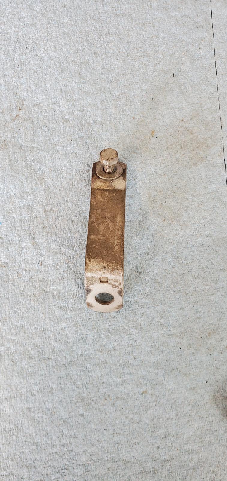

The choke bar was loose to, but we don’t know how to set this one good yet:
We have a movie how to adjusts the carbs. But it first has to run a bit good first.
