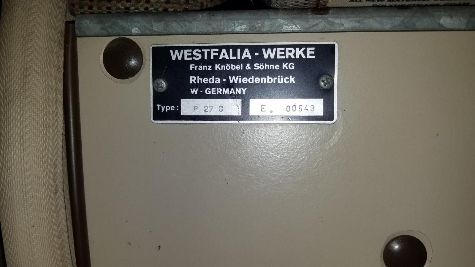

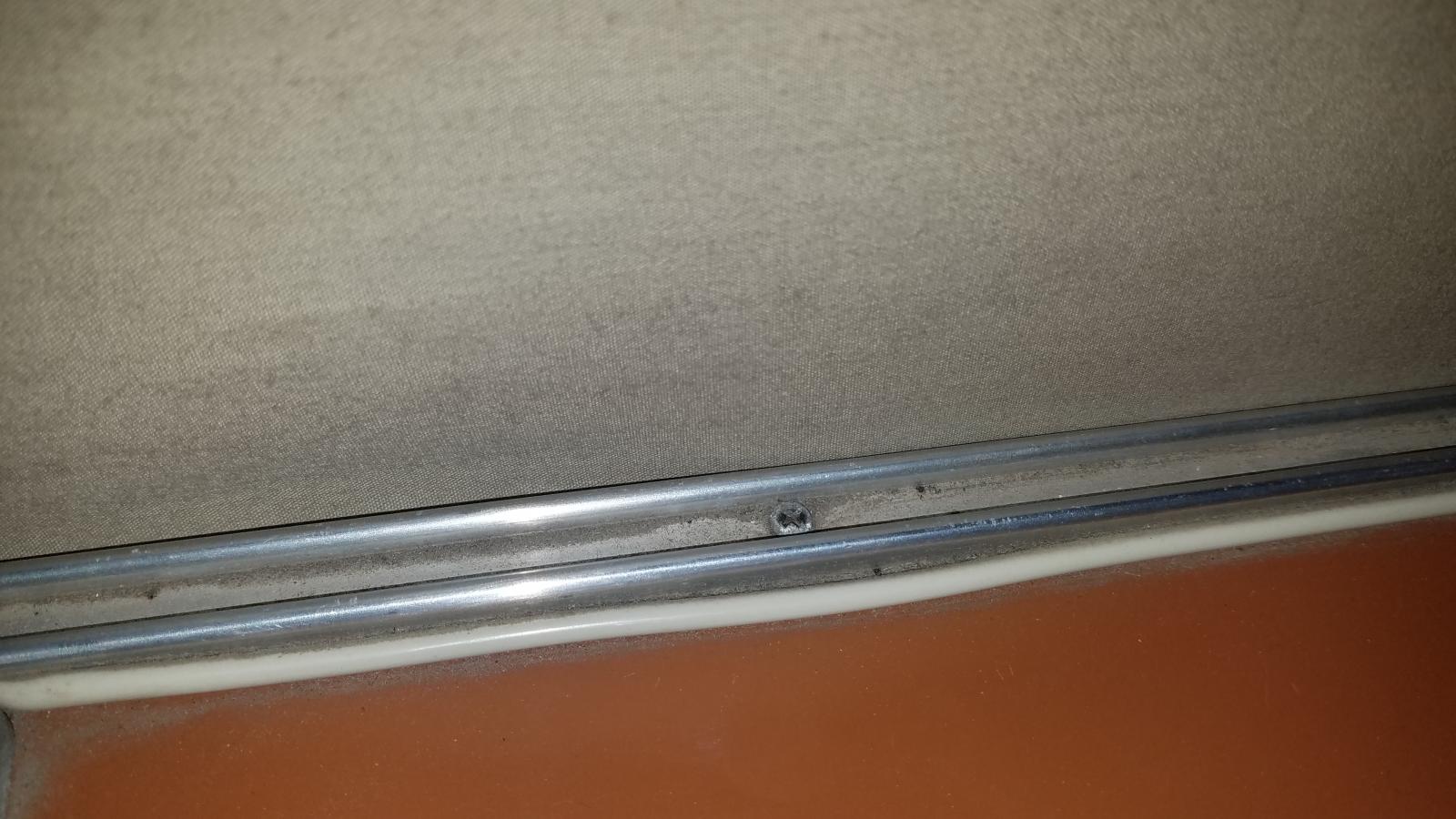

Hi,
I have an early 1984 (03/84) so I should have the staple on canvas right?
but when I look at my canvass I see only rows of screws.
My E# is E00543 which according to GW is <E000871 which should be staple...
Here is my evidence. Is it possible some PO replaced the canvas (seems like an older heavier one) and also modified it to the newer screw strips?
I'm still at the "thinking about it" stage but want to get my ducks in a row before I pull any triggers.

A van built in 03/84 is closer to the end of that model year than to the beginning.
So you have a later 84.
VW new model year production usually began in August or even July.
Mark

I think all Westy tent canvases have those same bottom screws and strips. My '81 staple tent attaches to a wood frame at top. Your top doesn't appear to have that. Those top screws look OE. Compare your tent to images of screw tents here in gallery?

I have read somewhere that Westfalia used their roof inventory without any order in the changover period.
There was a section detail drawing here on Samba somewhere but I cannot find it now.
The staple ones have wood frame which you can staple into while the late ones have an U channel formed from fiberglass.
It is possible that some PO have changed the roof and the canvas to a newer style one after a damage.
Either is true, you have a late style canvas now.

Your e number is well in the staple range.
Crazy things happen, a PO may have driven away with the top up (yeah, it happens) and hit an overhead obstruction breaking the original top.
The replacements available would have been the newer screw on design.
You appear to have the deep well on the outside of the tent canvas the new design has and someone didn't just make up a DIY screw fastener system.
Dave

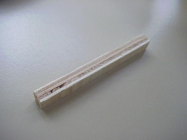

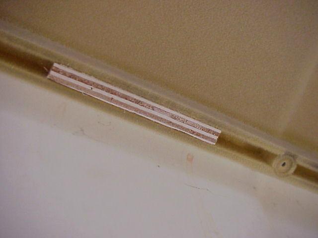

My Westy is a May 84 build and looks just like yours. It had the original canvas when I did the replacement.
Under those metal strips the top of the canvas was secured with staples that went into small wooden blocks jammed into a channel in the fiberglass.
The blocks were small and fiddly (about ¼" cubes) so I replaced them with longer pieces cut from plywood that were a snug fit in the channel:
That made it very easy to staple the new canvas in and, of course, I then installed the metal strips.
I found the whole job pretty easy, completing it in an afternoon in the shade of a big oak:
